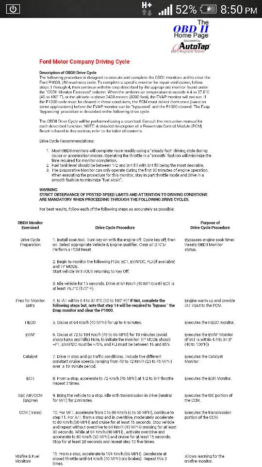

Mar 8, 2014
  • Mar 8, 2014
Before OBD II Drive Cycle. Burn off your bad gas and put some fresh gas in. Change your fuel filter.
