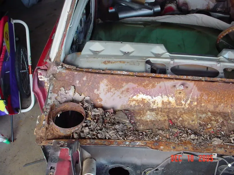

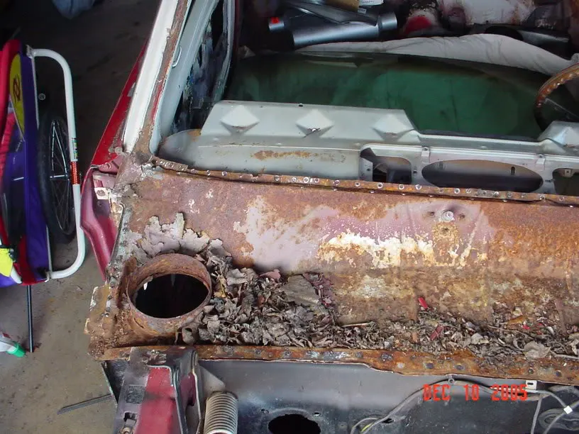

Looks pretty good. If the floors have been replaced, the cowl is probably rusted. Get underneath and look up under the dash at the vent hats. Ask the owner if he'll let you dump some water in the cowl vent grill just in front of the windshield.
Here is a picture of what the cowl MAY look like under the cover:

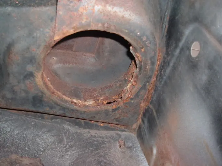

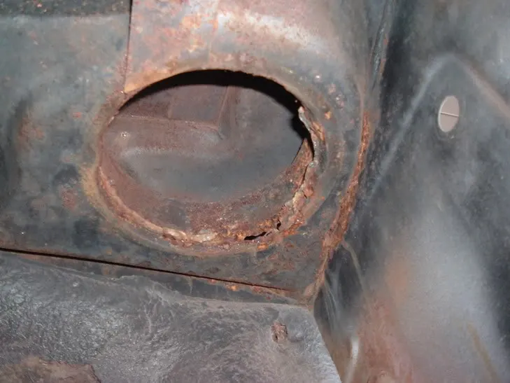

Look up under dash for this:
If it leaks, you'll just end up redoing your floors at a later time.
