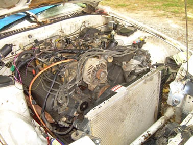

ive already had it in and running , heres a pic
ummm, no pic....

file is to big sorry

here you go
