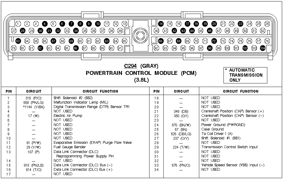

I am looking for a good wiring diagram for a 98 v6 car. I need one that shows all the pins at the pcm plug for both an auto and 5 speed. I have one that has been changed over ( bought as an unfinished project ) and I am not sue what wiring was changed and what was not and I dont really want to change it if it is the correct harness. I Know that the pcm is for the 5 speed . Any help would be greatly appreciated
