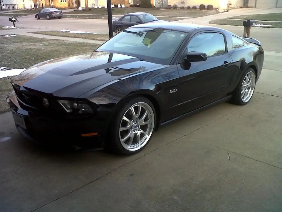

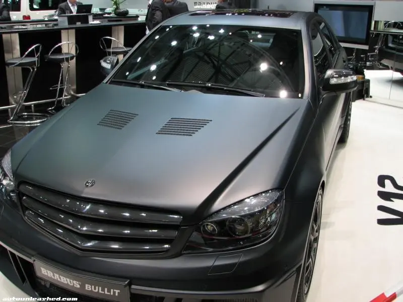

First of all, sorry I dont have a fox, but if I put this in the S197 section I know the only responses I will get is "leave your hood stock..." Plus you guys have always made me feel more at home. I can always put a stock hood back on later if I outgrow my change, but for now I feel like doing something different (call me stir crazy). I am stuck between two options. The first is just cutting vents and putting screen under it, but layed out like the hood on the Brabus Bullit:

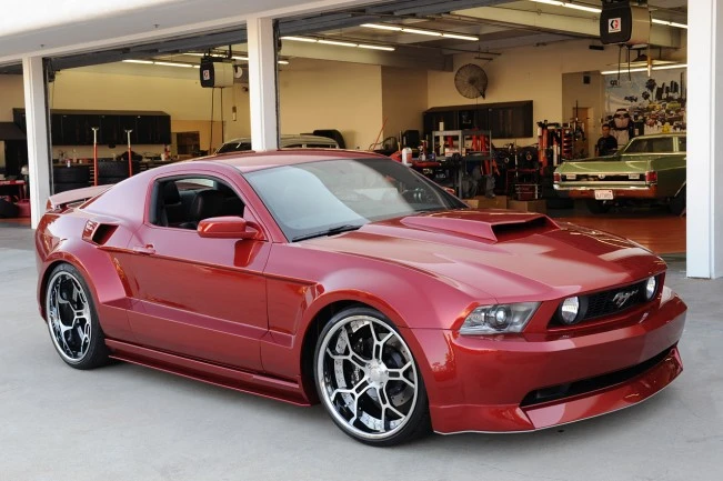

The other is a Boss 429 hood scoop. Ever since GAS put it on their Boss 429 inspired widebody, I have loved the way it sits a top the rise on my stock hood. Plus, I love seeing a scoop or cowl from the driver's seat when piloting a mustang.
The Brabus vents are very sleek, but I just havent been able to get the scoop out of my head. I would cut out the hood under the scoop to actually allow air flow into the engine bay as well, so either route will help lower engine bay temps. What say you folks? See my car below.
Its not my daily, that dirty assed imprezza behind it is my daily. Im leaning toward the Boss scoop, as it just looks like it was made to fit on the raised portion of the hood. Gearhead, I too like a shaker hood, but the scoop looks tiny on these cars, and its $800 versus a couple hundred for a new Boss style. Not to mention the engine mounts dont allow the engine to move in the slightest, so the shaker does not shake. :confused:

Here's one vote against the Boss... That thing is friggin huge, and on top of the stock hood bump it'll look like something off a Mopar. It doesn't look as big now, because it's on a car with those incredibly large and distracting flares, but on your car it will look like the new Challenger snorkel thingy.
I like the louvers, and I've got no issues with an open hood on a DD. Doesn't seem to cause any problems on my 13.

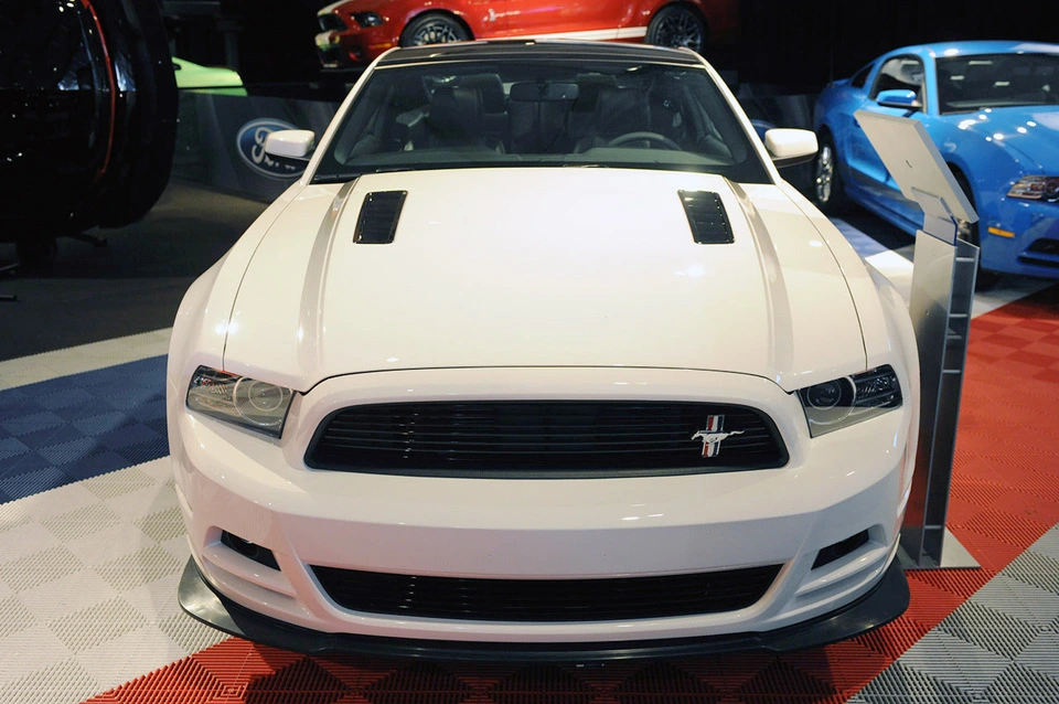

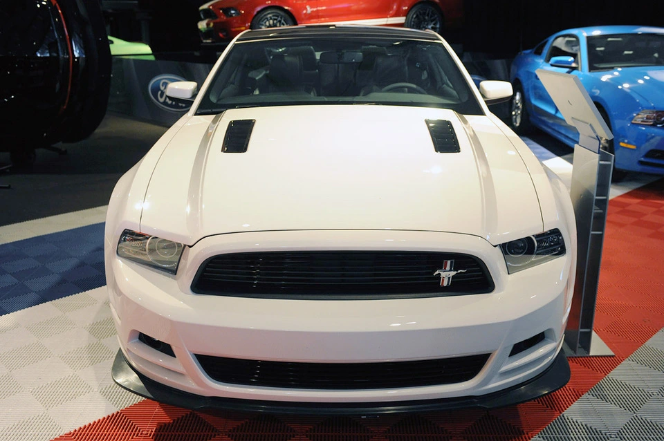

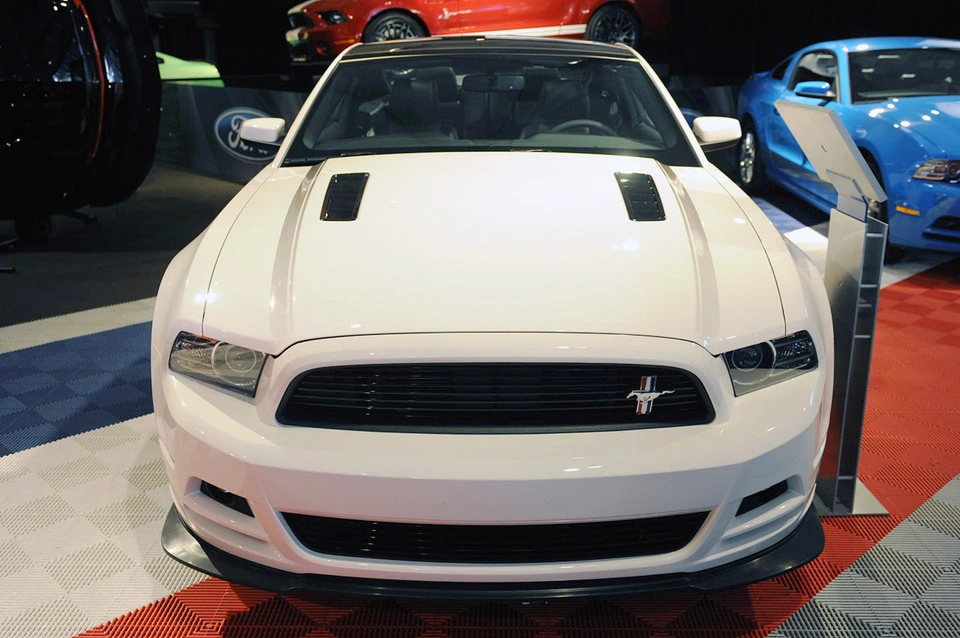

What about the 2013 California Special Mustang hood vents?
Hood scoops that just dump air in the engine bay sometimes hurt cooling more than help it. The reason is because the scoop, if high enough, creates higher pressure that may stop the airflow through the radiator.
Cowl vent hoods work so well because they take advantage of the low pressure area right in front of the windshield and suck air through the radiator.
If you reason for wanting the vents/scoops is cooling, well there are more effective means to do so.

I honestly cannot decide if I like this or not. I have a real appreciation for what went into this but this particular wide body looks like a caricature rendition of an S197 to me. Those brake vents in the rear quarter are awesome though.
Anyway... back on topic. I don't like hood scoops. Not because of how they look but because of how they function. Shakers, I get. That air goes into the inlet tract. Hood scoops however, force air out of the engine bay and underneath the car. Air that would otherwise have gone OVER the top of the car. Vents on the other hand, (if they're located correctly) redirect air over the car that would have otherwise gone under the car. Probably not as big of a deal on a New Edge as it is on my Fox but my thought process here is about functionality over looks.
So whatever you decide to do for looks... At least let the functionality be your tie breaker. You should at least look and see where the high and low pressure areas on your hood so that you know if air will entering or exiting the engine bay. The closer you install vents to the base of the windshield, the more likely those vents will be pulling air INTO the engine bay instead of OUT.
With air scoops, there's really no question. Air will be going into the engine bay. Not an ideal situation to me, at least.
I dont think they would look as good on either side of the bulge on my hood, and too close together if I were to put them on top of the bulge. Works on the flat hood of the '13 though.
