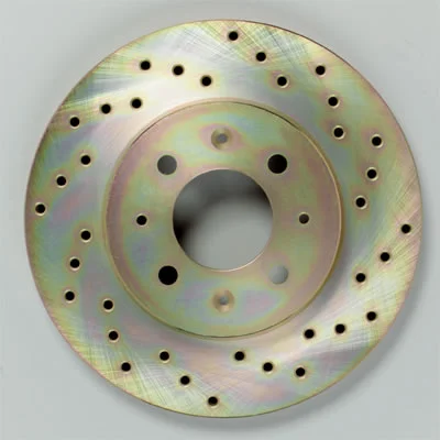

Here's what I've got...
And HERE'S a pic of them on my car.

There is NO way I would try to cross drill my own rotors. The holes have to line up with the vanes, the whole assembly has to remain in balance, and the heated area around the holes will most definatly fail if the whole rotor is not heat treated and quenched after the operation... There are few things as important as the brakes on your car...
