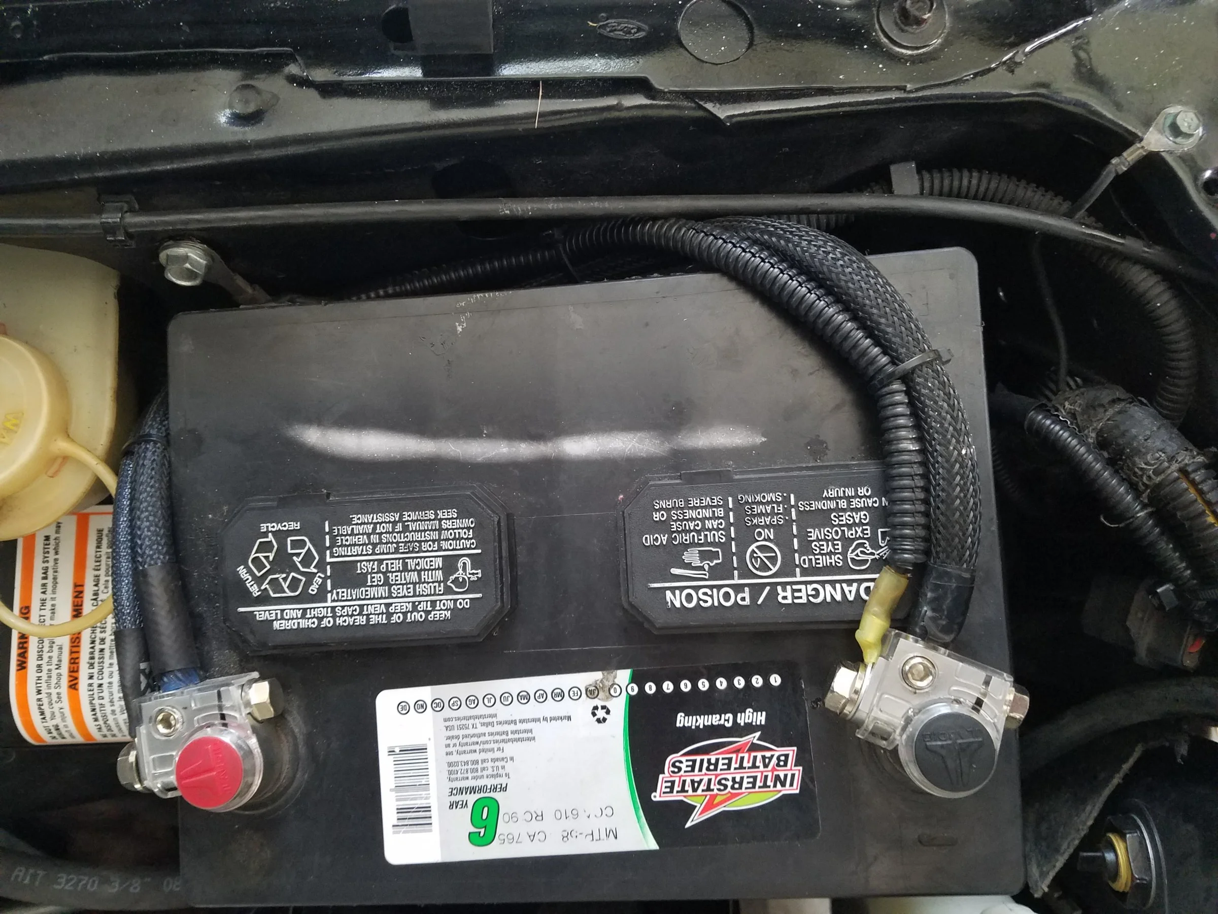

You have to cut it off if you replace the negative battery terminal. Here's mine.

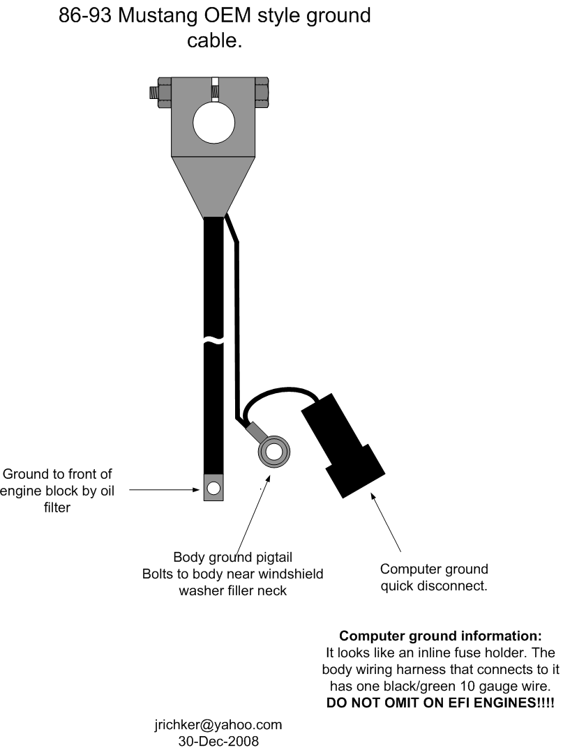

The picture shows the common ground point for the battery , computer, & extra 3G alternator ground wire as described above in paragraph 2. A screwdriver points to the bolt that is the common ground point.
The battery common ground is a 10 gauge pigtail with the computer ground attached to it.
Picture courtesy timewarped1972
Correct negative battery ground cable.
3.) The computer's main power ground (the one that comes from the battery ground wire) uses pins 40 & 60 for all the things it controls internally: it comes off the ground pigtail on the battery ground wire. Due to its proximity to the battery, it may become corroded by acid fumes from the battery.
In 86-90 model cars, it is a black cylinder about 2 1/2" long by 1" diameter with a black/lt green wire.
In 91-95 model cars it is a black cylinder about 2 1/2" long by 1" diameter with a black/white wire.
You'll find it up next to the starter solenoid where the wire goes into the wiring harness.
Dan,
That's a clean looking setup. Where'd you get the terminals? Is that heat shield fabric around your wiring?

Bruno,
Thanks. The terminals are JL Audio XD-BTS ultra compact terminals. The wire is 4 ga NVX OFC (stuff used in high power auto installs) it's high strand count and really flexible. The stuff wrapping/protecting is called Techflex. It's kinda like a Chinese finger trap lol. You can get everything from Amazon or somewhere like Sonic Electronics.
