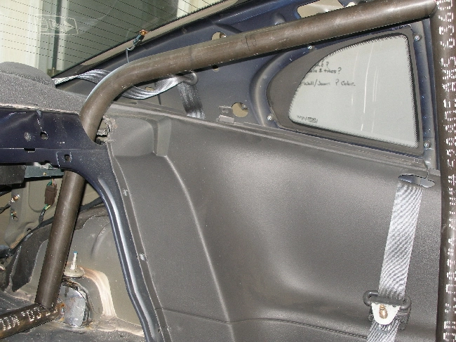

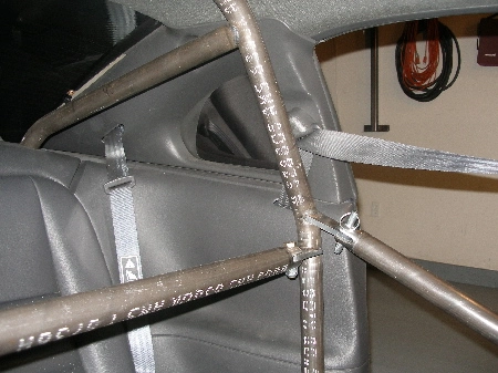

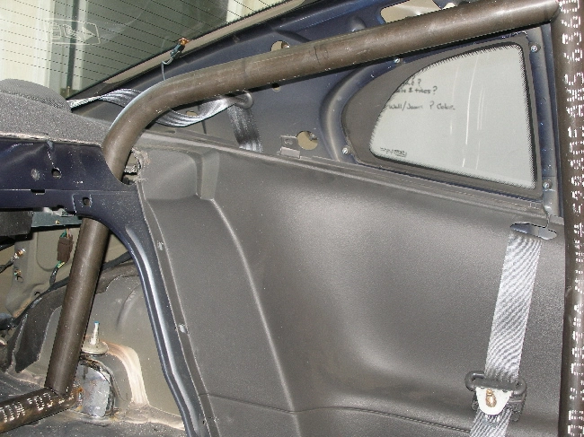

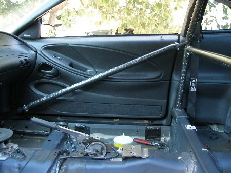

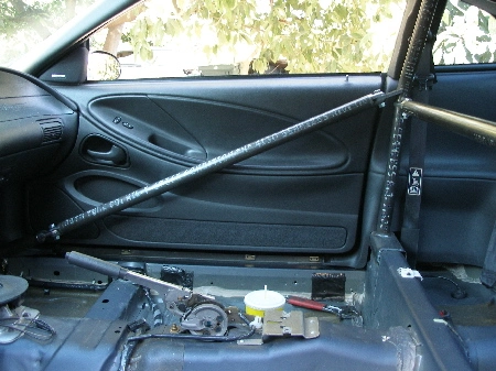

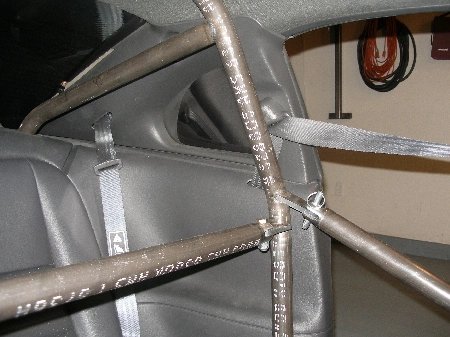

Just got a custom roll-cage installed.
What color should I paint it. Was thinking about going with the car color "True Blue" Or, should I match the interior?
More pics here Roll-Cage Pics

I've been through the woods flipping through the air and taking out trees...accidents happen and a cage can save your life, thats a pretty good reason. Nice job on the install. How much would it cost to install on my car?:D
A cages can be more dangerous than no cage if you don't have a harness and a helmet on as well. Each peice of safety equipment required per NHRA (and others) rules are designed to work in conjunction with one another. With a cage the factory "crumple zones" are no longer effective, so more force is transfered directly into your body, and without a harness to hold you to the seat you can get thrown around quite a bit (often times hitting your head, thats where the helmet thing comes in).
Of course, a cage w/ door bars will probably help if you get t-boned.
