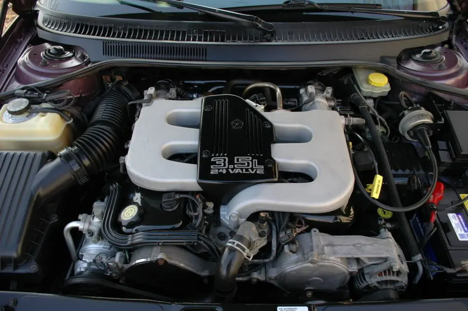

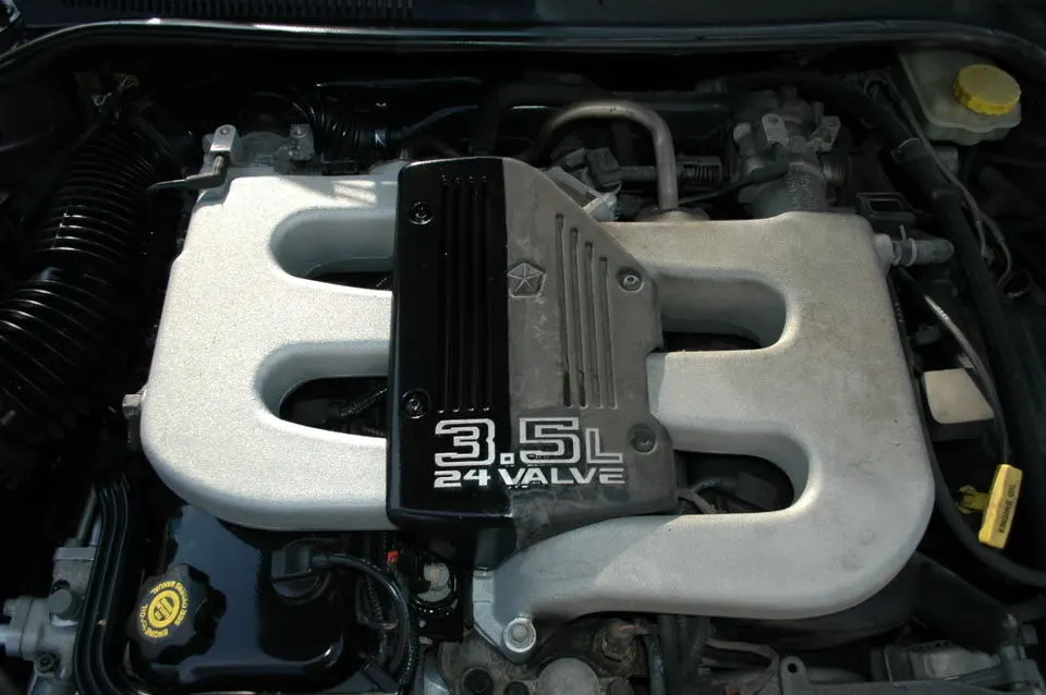

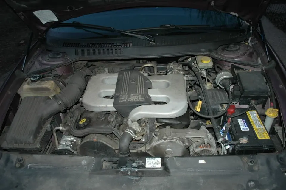

Yeah, simple green works well just make sure your engine is cool and don't let it sit on anything aluminum for more than a minute as it will etch it. I like to use orange degreaser... don't have to worry about etching aluminum... Here's a couple before/after pics on my DD after using orange degreaser and dressing with Stoners Trim Shine...
Before
50/50
After
