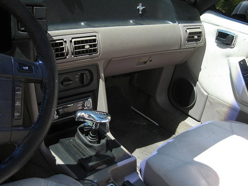

So i was really getting tired of my "black and five-different-shades-of-gray" interior, so I decided to paint everything that was gray white. Very Contrasting. I Love it. Though I'm not finished, I had to take off to college before i was done, I will finish it while i'm up here though. I've never seen an interior like this either, and i love to be unique/original. Tell me what you think.
BEFORE:

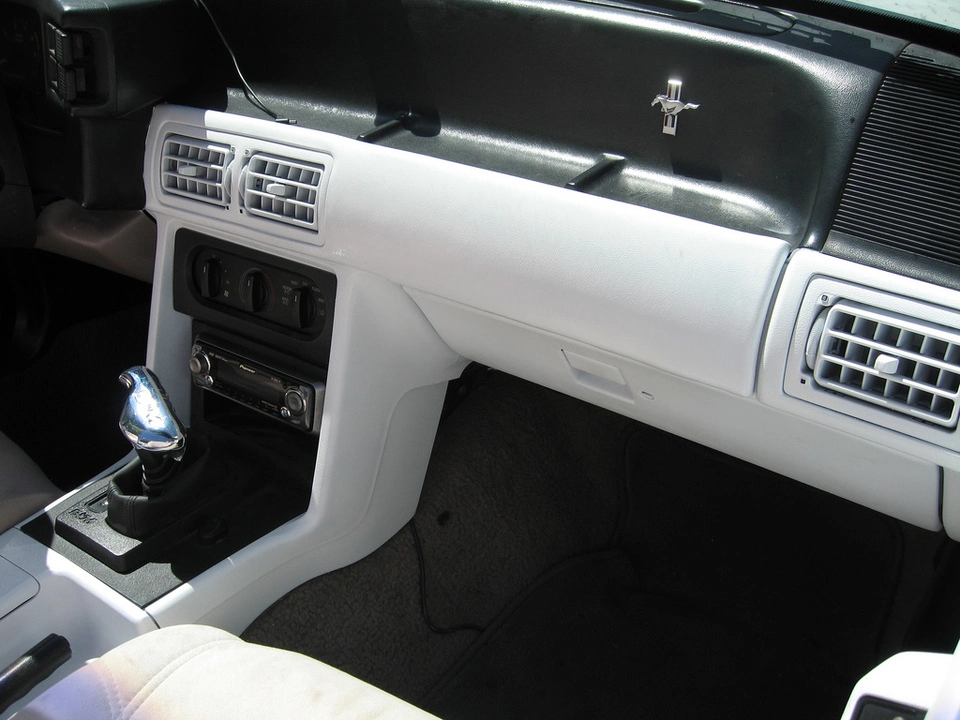

AFTER:
I also lost the plastic boot for my e-brake, so I made the one you see there out of black leather.
I just have cheap WalMart seat covers on right now, but i'm going to recover them with white vinyl, and then I'm going to get black carpet and floor mats.

The paint holds up pretty nice. The only place I've had paint flake off so far is when I've put my air vents back in, and it was in areas that you couldn't see. Otherwise It's all perfect. Just make sure to use a plastic adhesive promoter, otherwise you're screwed right off the bat. For the door panels i used a vinyl dye, for everything else, I used plastic paint.
I took the top half of the console off to paint and the door panels. Everything else I had to leave in because i couldn't get out for one reason or another.
