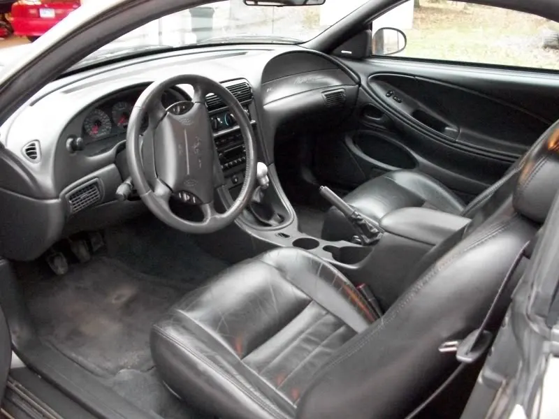

Just got an 02 GT, seems like both seatbelts have a wierd twist to them that ford wanted to be there, it inhibits the seatbelts from retracting into the column properly.
the passanger side needs to be hand fed, is there anything I can replace like some sort of recoil spring or am i stuck with that?

My driverside belt has a weird 1/2 twist in it that makes it seem like it's sitting wrong no matter which way you flip it. It doesn't retract strongly on its own, you have to help it along some of the time and that 1/2 twist adds extra friction which makes it worse.
The passenger belt wants to spontaneously twist up and fold and then jam up in the upper anchor guide - I can't figure out why or how it does it, but the rare occasion someone does ride in the car with me, the belt is invariably folded in half and stuck up there despite the fact that I straighten it out each time.
Anyway, the retractors are known for getting weak over time and I believe you can replace the retractor assemblies to take care of that.

The twist in the seatbelt you can probably fix yourself. The lower end of the belt is held by a hefty torex bolt. Just remove that bolt, turn the belt around to be streight (along with flipping the plastic molding to be correct) and bolt it back together. Being pertinant to your safety, it may be a good idea to find out the correct torque spec and use a torque wrench.
