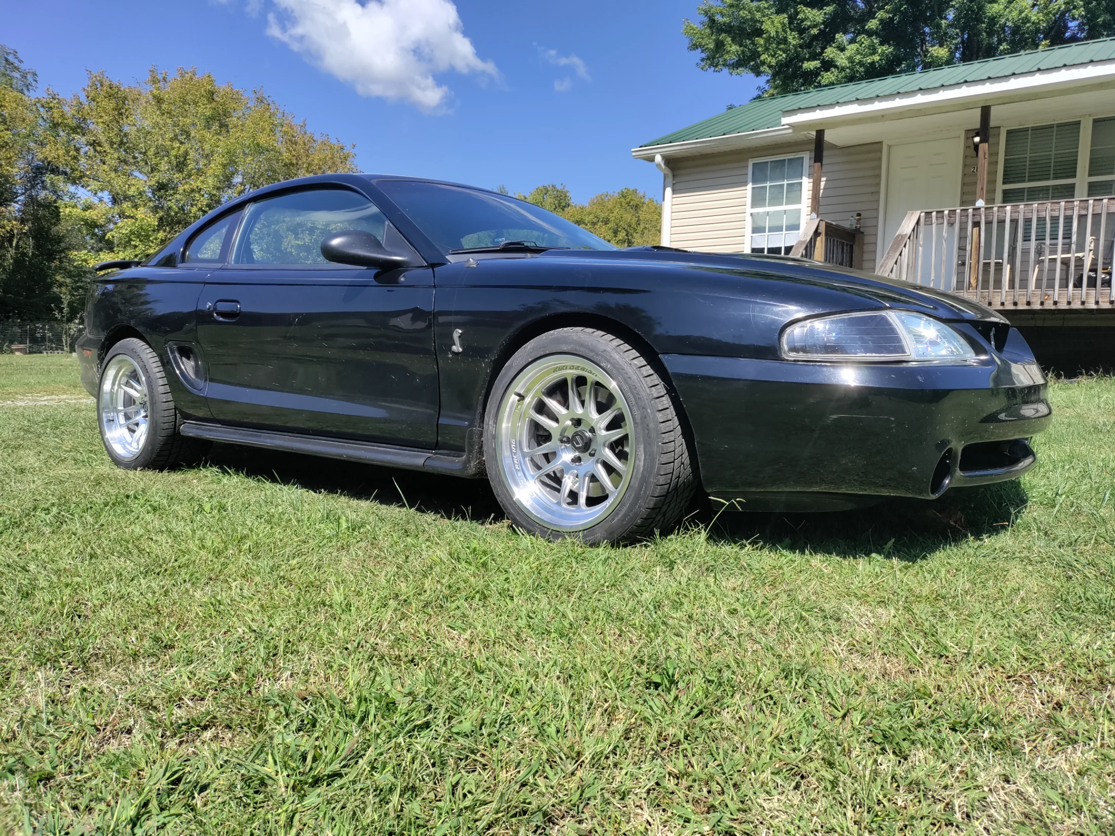

I really only have one decent pic of the car but hey, one's better than none lol. Here's my aptly named "Noise Complaint".
