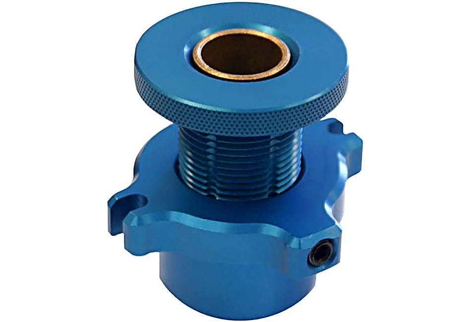

I do have an SR clutch adjustor kit that I need to install. Just haven't got to it yet, or know exactly how. I am wondering if this will help? Maybe the quadrant is bad?

Installing the adjuster kit it will help..because the factory stuff just don't work with a performance clutch kit.

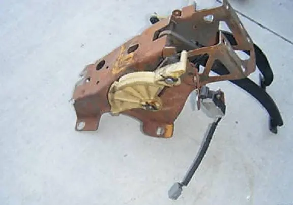

Agreed. Any pressure plate heavier than OEM spells eventual destruction of nearly ALL stock plastic quadrants and prawls.
If you still have this:
Then there's a good chance that it's your problem. If it's NOT your problem then it will become one very soon.

The quadrant needs to be replaced if you use any type of aftermarket cable or adjuster. My preference is a Ford Racing quadrant, adjustable cable and Steeda firewall adjuster. The adjustable Ford Racing cable is just as good as the stock OEM cable. It allows a greater range of adjustment than a stock cable with a aftermarket quadrant and firewall adjuster. Combined with the Steeda adjuster, it lets you set the initial cable preload and then fine tune the clutch engagement point to your liking without getting under the car.
Using a stock OEM cable, firewall adjuster and a single hook quadrant may result in not having any free pedal travel before the clutch starts to disengage. I found this out the hard way.

I got the SR Performance Clutch Adjuster from American Muscle. Will this work? Thanks so much for the write up.

This is getting fixed today. need one last piece of advice. should I just try replace the quadrant since most people say oem cable is best? at this point engaging clutch with the pedal isn't doing much anymore. I'm shifting without a clutch.
Had new clutch put in 2 weeks ago but cable and quadrant is still oem. how do I know if it is just the quadrant is bad? I have the SR kit from AM... Ideas? i gotta do this today...

This doesn't really explain why I am having a hard time hitting gears. I don't get it. I know I need to replace quadrant but I am wondering if they didn't adjust correctly at the bell housing when they put on new clutch
