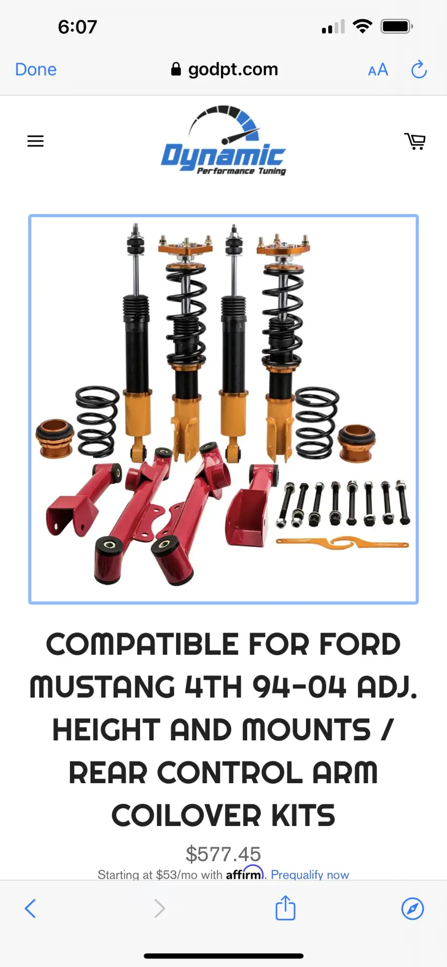

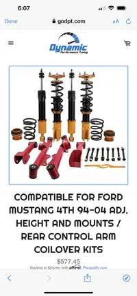

Hey guys I just installed a new coil over kit that included upper/lower rear control arms. The rear is super bouncy when driving on uneven surfaces. I did not reinstall the quad shocks as I understood that with upgraded control arms they aren’t needed? Any help would be greatly appreciated to help me figure this out
Here’s a picture

Those are some pretty high spring rates. My guess here is that the dampers just simply can't handle the rates.
I'll be honest. $600 for full coil-overs and rear control arms? This is just one of those times where you get what you pay for. If this was a kit like maximum motorsports i would recommend different spring rates (less) or a higher quality damper with perhaps adjustable settings. I don't think there is anything that is compatible with that setup.

You bought a generic coil over kit that is made with absolute junk parts by a tawain company that cost about $200 and gets rebranded and marked up by all the parts hawkers shops., sve, Sr performance, maxpeeding, race land, bc racing and countless eBay drop shippers etc all sell that pile of junk. Any kit that uses that rear spring design is coming out of the same factory you can get them for as little as $300 to over 1k depending on which company brands it but its all the same junk.
The shocks and struts are garbage at best, the rear springs in that design will ride like trash and the bushing in those control arms will split and fall apart the second they see any kind of torque.. I would try to return it if you still can and go with something all ready proven for what you want out of your car. That kits for the parking lot, broke want to be drift crowd who just want it low and care less about function.
Cheap chinese sourced parts have there place, suspension is the last place you want them.

Lower spring rates, or better shocks really.
What's happening is the spring is stiff enough that when you hit a bump, it wants to push down on the suspension very quickly and firmly. The shock is not controlling the impact so it overshoots and then relaxes which is creating the bounce effect.
You either need a weaker spring that the shock can control better, or a better shock that can react quicker to stop the suspension movement. The latter is going to create a VERY firm ride with those spring rates. Unfortunately that kid doesn’t really have options available in terms of other springs or shocks.
Street car rates for coil overs are typically 250-325# front, and 150-175# rear. That kit is 450#front/400# rear which is pretty damn stiff. That's road course stiffness there.
I hate to say it but there's not much you can do here. I also don't think that kit has a stellar rep for longevity.
Without putting better shocks and a much better spring design in it no, the only thing that kit allows you to do is adjust ride height, some of those kits have adjustable struts and shocks as options but the valving is garbage, the rear spring on those kits limit travel way to much.
