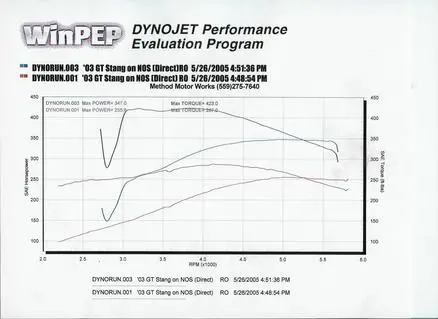

03poontanggt New Member Feb 23, 2004 296 0 0 fresno ca May 26, 2005 #1 May 26, 2005 #1 Here are some new dyno numbers one is NA and the other is with the 125 NOSzle kit. Attachments DYNO2.webp 13 KB · Views: 103
03poontanggt New Member Feb 23, 2004 296 0 0 fresno ca May 26, 2005 #2 May 26, 2005 #2 N.A. 255.8rwhp & 287.0rwtq N20 347.0rwhp & 423.0rwtq
0 01silverbullit New Member May 7, 2005 39 0 0 May 26, 2005 #4 May 26, 2005 #4 Nice numbers but how long do you think the motor will last with a 125 shot? I always here about the plastic intakes not getting along with n20

stangman 15 Year Member Jul 10, 2003 2,690 10 69 in a 3 bed, 2 bath May 26, 2005 #5 May 26, 2005 #5 gotta love the tq of nitrous
02LaserRed2V New Member Jul 30, 2004 379 1 0 Augusta, GA May 26, 2005 #6 May 26, 2005 #6 Wow, that is some crazy tq!
blackink00 I missed a shift & stole Curt's money. Mar 30, 2005 545 0 0 Tempe, AZ May 26, 2005 #7 May 26, 2005 #7 that kinda suck to not get 100 more horsepower with a 125 shot with my 100 i get 96hp more
jeffnoel Founding Member Aug 31, 2002 1,638 5 37 Clovis, CA May 27, 2005 #8 May 27, 2005 #8 Hey is Method Motor Works off of Golden State, and those #s are with the factory tune right?
L lewbud New Member May 15, 2005 15 0 0 Arlington TX May 27, 2005 #9 May 27, 2005 #9 blackink00 said: that kinda suck to not get 100 more horsepower with a 125 shot with my 100 i get 96hp more Click to expand... Don't forget that you normally lose about 15% due to parasitic drag, so coming in just under a buck is within spec.

03poontanggt New Member Feb 23, 2004 296 0 0 fresno ca May 27, 2005 #10 May 27, 2005 #10 01silverbullit said: Nice numbers but how long do you think the motor will last with a 125 shot? I always here about the plastic intakes not getting along with n20 Click to expand... I am running really rich and with the noszle kit there isn't any puddling so I think it is safe.

03poontanggt New Member Feb 23, 2004 296 0 0 fresno ca May 27, 2005 #11 May 27, 2005 #11 blackink00 said: that kinda suck to not get 100 more horsepower with a 125 shot with my 100 i get 96hp more Click to expand... NOS numbers are rated at the motor and I think the other companies are rated at the wheels. I think.

03poontanggt New Member Feb 23, 2004 296 0 0 fresno ca May 27, 2005 #12 May 27, 2005 #12 jeffnoel said: Hey is Method Motor Works off of Golden State, and those #s are with the factory tune right? Click to expand... Yep, I haven't gotten the programmer yet.
