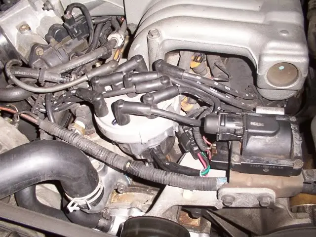

I've had times when my battery was almost dead and the motor would turn VEERRRYYY SLLLOOWWWLLYYY, but it would still fire up. So as long as it's a nice constant spin on the engine, I don't see that as your problem.
Have you tried spraying some starter fluid in there to see if it'll catch? If it tries to stat with starter fluid sprayed down the throat then you know it's fuel related, if not, then it's a timing/ignition problem.
Where are you located, maybe one of use can come give you a hand with it.? Just an idea.
IDK, I just hope a new dizzy will fix it.
