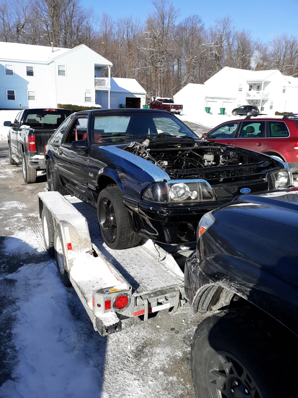

Update.. over my head but still at it. Headed to a shop to help me put it together before spring. When I got home and poked around, I noticed a few of my gauges would work intermittently. The cause... the fuse box under the dash was completely melted through due to some botched wiring. Did a complete wiring harness replacement (which really took the wind out of my sails). I pulled the engine and replaced all the gaskets and seals, water pump. MSD AL6 w/ boost retareder.
For my budget, went with the following combo
GT40 upper and lower intake
GT40 heads
F303 cam (works well with boosted applications)
3.55 gears.
Removed the nitrous
Went for tried and true 90's power. I know many disagree with this combo, either much more efficient bolt one out there. But for now, that's what my budget can handle. Will post more pics and videos in the coming weeks if anyone is interested!
