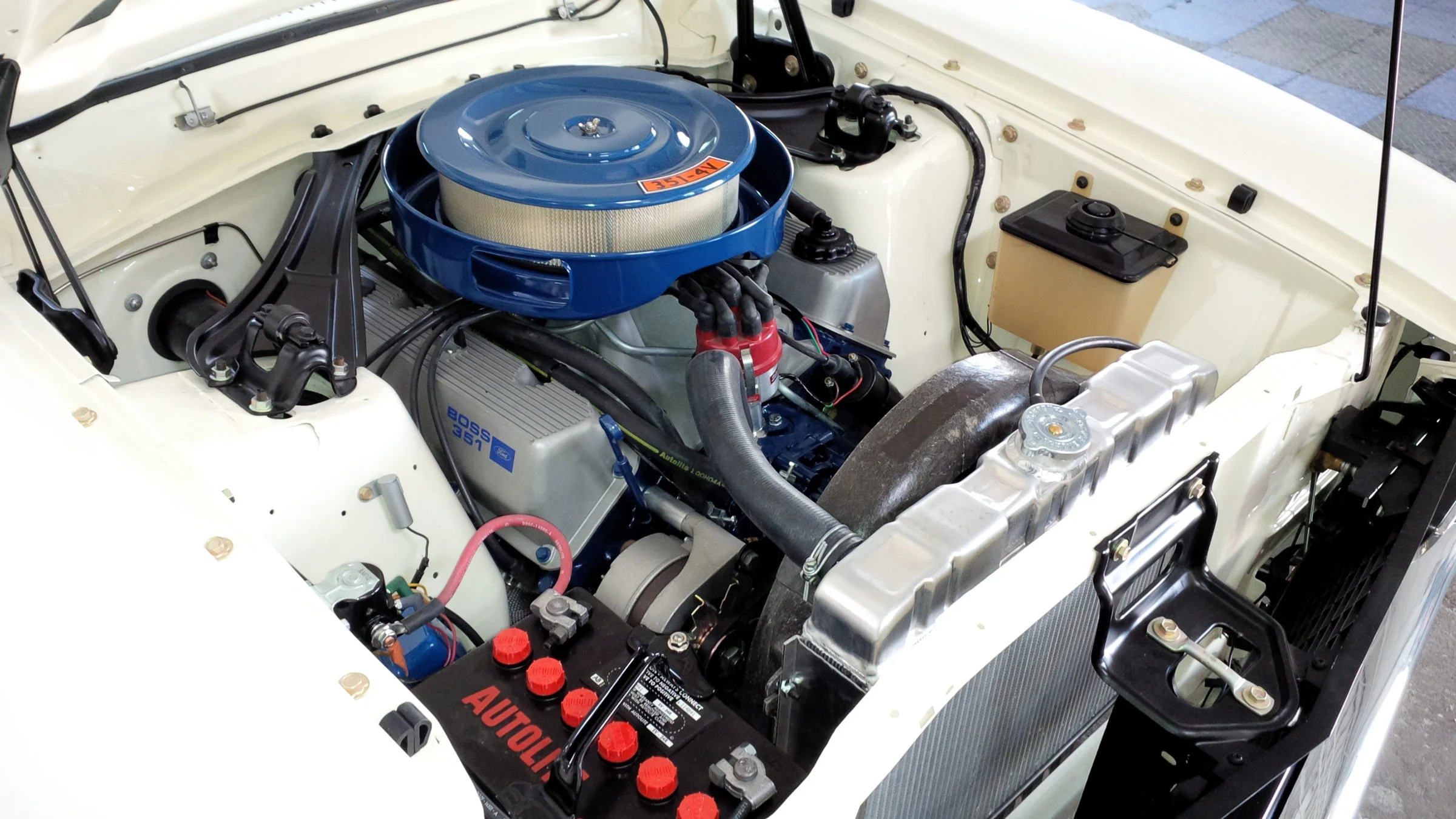

Hi Everyone! New to this site but read a lot of what goes on here. Site is great and a ton of info. Thanks. I'm baffled and need an answer do hoping I can get an answer. First off I am not an owner of a Stang even though I love 'em. I own a '71 Maverick Grabber running a 351 C. After a 10+ year rotisserie restoration car is finished. I replaced the oil pan because it was dented when purchased and my question comes. Why can I only get 4 quarts of oil and a 12oz. Bottle of zddp in the pan and is a hair over full on the dip stick? Is the wrong stick in the car or was I shipped the wrong pan? But what 351 would only hold 4 1/3 quarts oil. I'm stumped. Very good pressure at 80lbs. And about 40 on idle. I'm confused?
Are you allowing for the oil filter? Depending on which filter you use it could hold a quart itself. 1 Quart in filter + 4qts in pan would show full on dipstick then add your 12oz zddp would show a little over full?
Thanks for the reply. So, I failed to mention above that with such tight restraint in the engine bay I needed to use a small filter...smaller than what is called far and I am wondering if this is the true issue. Filter is a Fram 3692 and is much smaller than the factory filter. Right now is have to say I'm 3/16 above full with the 4 quarts and a bottle of Trickflow ZDDP.
I know that filter and its pretty small. Add the fact that it practically mounts on its side which doesn't allow it to retain much oil. it would be lucky to hold 3 or 4 oz. I don't think I would worry too much and allow the dipstick to read a little high instead of right on the full line. If its not running hot or pushing oil out the dipstick tube then I think you'll be fine. I would however think about swapping the filter in between actual oil changes since you have less filtering capacity.
Awesome. I kinda' figured that was the problem. The dip stick is correct for a '70 351C and I was kind of sure I received the correct pan.I wanted to keep the engine bay true to what it may have looked like if Ford did this but would you considered a oil filter relocation system and/or a cooler?
Thanks-Denny

I would agree that a relocation kit would be a good idea. Don't know that I would install a cooler although It surely wouldn't hurt especially if you plan on doing parades, road racing or something similar where you might need that extra cooling.
