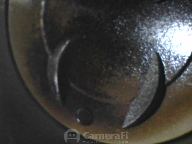

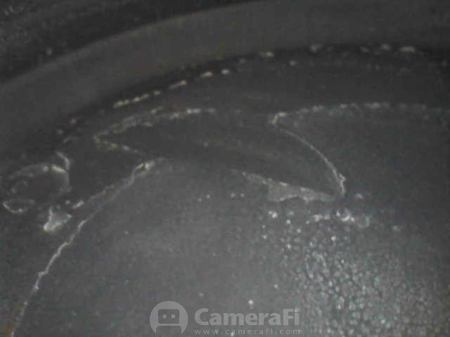

I have the same problem and have done everything except rebuild the bottom end. A friend of mine who is comfortable rebuilding engines said most of the time this is due to seized oil control rings from someone not changing the oil enough and/or the car being run too hot for too long but not enough to blow a head gasket.
It is visible on my number 6 cylinder and gets progressively worse on the 7 and 8. He said there is not much you can do except rebuild. He said soaking with seafoam sometimes works but most of the time it is a lost cause. I have a small catch can and don't get too much oil in there (definitely not the amount I burn).
I ran a scope and you can see on those cylinders where the edge of the pistons are clean and he said that is almost a certain sign of oil control rings.
You can see the difference in the 5 cylinder and number 8 in the images below.
