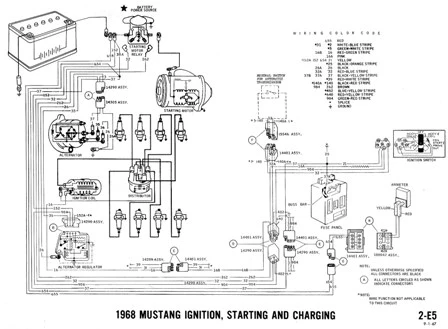

Looking at the diagram for the 68, if it's running with the key in the start position, then it should be getting power from the solinoid. The coil does not get power from the solinoid in the run position. That comes from the resistor wire begining at the ign switch. You can test this by running a hot wire from your pos batt term to the + side of the coil and start it up. Should run ok. You will need to see where you are losing the ign feed from the switch I think.
I attached a page on the wiring but I still struggle trying to get pictures to fit. It's probably too small now to be of any use.

I appreciate it guys, keep the opinions and suggestions coming. I really appreciate the diagram BarnStang. It's small, but I think It will work. Thanks again Guys!!!!!
I can email you the bigger one. PM me an email addrss and I will send it in the morning. Someday I'll figure out how people put huge pictures in the thread...
If you have a test light, you should be able to track it down pretty quick. I would suspect the ign switch first. There should only be the one connecter right there at the firewall between theswitch and the coil.
