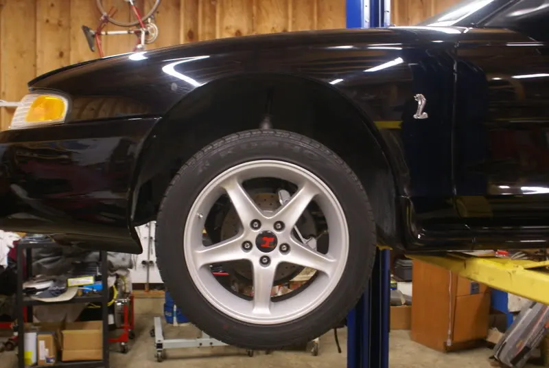

Here is my review of my install on the PARacing K-member
Great fit. As you can see it kept the geometry just like stock. No moving the wheels forward. Almost fell into position. Did some squaring on the member tightend it down and checked again. I used the rear lower control arm mounts as my reference for squareness.
Doesn't look like I will need major alignment work. Will have to do it when the motor is back in though.
The biggest problem I had was the rack mounts where a few mm too long. I ground it back to get some compression on bushings. This is probably due to me using urethane offsets. Also needed new bolts for the rack mount.
Overall this was a good experience. Well worth it. :nice:
This thing is LIGHT on the front end now. As mater of fact it doesnt squat at all W/O the motor. At first I thought my A-rms where binding. So I put my 200# ass in and jumped and it compressed down.
Yeah i remember i had to get new bolts too. I dont remember having to shave down the rack mounts though. I used Urethane center cut bushings.
I thought the same thing too. The car sat so high. Once i got the engine and tranny in though it went back to normal pretty much maybe a 1/4in higher.
