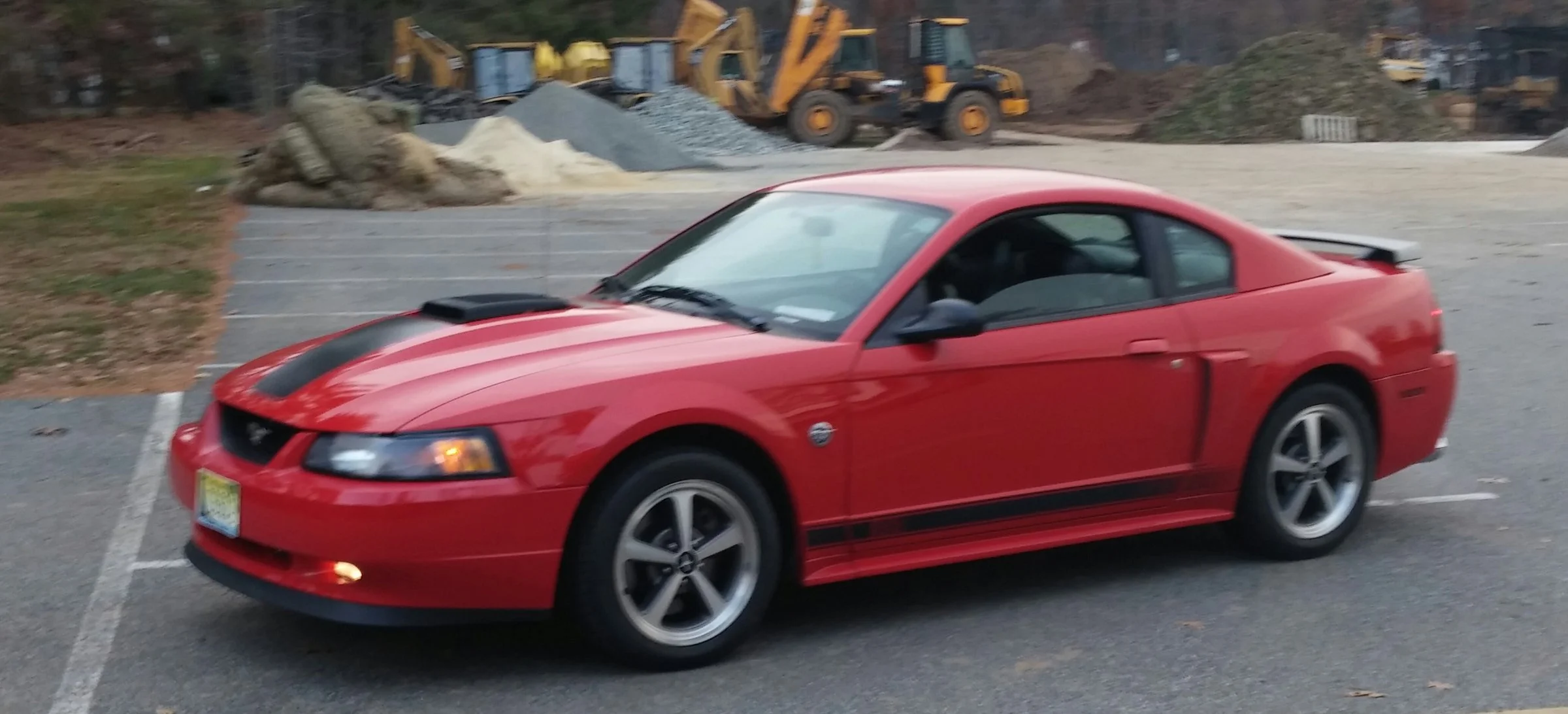

Just grabbed in November of this year. 2004, was shopping New Edge Cobras but this popped up for a nice price and I kind of liked the look of it better. Never owned a mustang before so it's quite a change from my earlier Camaros and Firebirds. It's more comfortable, sounds better, looks better... let's see what the future holds for it. Have to repair a few things off the bat but nothing outrageous. Did the plugs last night (the ease compared to the f-body is absolutely outrageous), new air filter, belt, have fuel filter on the shelf, and need to replace a wonky idler. Clutch cable/FWA/Quadrant coming up this weekend and have a Magnaflow on the way to replace the Borla that came on it. Just saying hi.

Edit: Great looking car BTW. :nice: I think the Mach is my favorite for SN cars. Hold onto those Magnum 500's. Don't let anyone talk you out of them. hehe
If you're really aching for a change, find a set of replica deep dish for the rears. :chin
