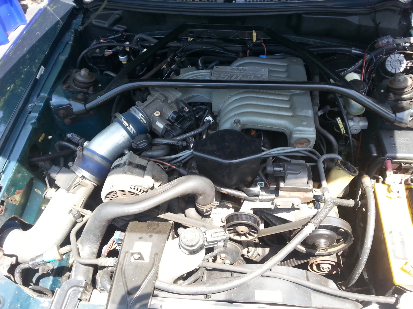

Some pics of the engine bay may help us to identify your mods.

Thatnks guys which headers would give me the best sound? And here's a pic of the engine bay also.

Other than the cold air intake, battery and security system that engine and engine bay is bone stock.
Make's me wonder why it was chipped.
The MAF sensor housing looks like it is molded into the pipe that goes into the fender-well.
A/C is not working either.
Looks like the compressor's pulley/clutch has been removed.
Might as well just remove all hardware that goes with that and save a few pounds of dead weight off the front end.
