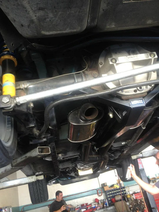

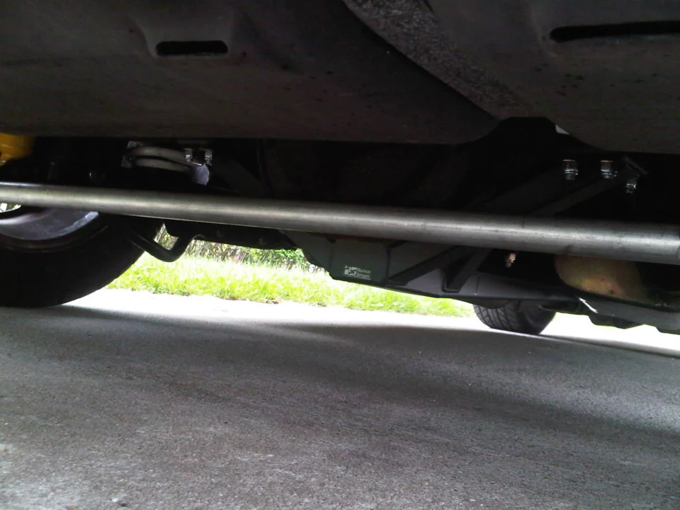

I don't have a picture of the underside that shows everything. Here's a pic that I guess proves its all there but doesn't give much of a view.
Oh the tailpipes --I've had a Bassani catback on the car for years. The routing of those tailpipes doesn't clear the MM panhard bar. After a few years I decided the tailpipes had to go back on. If you or anyone is thinking of the panhard bar, consier this ahead of time--the pipes can't snake around the panhard bar bracket (that actually attaches to the frame, not the rod), so you either have to remove the bracket, put on pipes, then put the bracket back on or cut the pipes and the sections of pipe back together. Unfortunately for me, the shop tacked the bracket on so I have to do the latter and cut the pipes. I used stainless 2.5" flowmaster pipes and they fit fine on the Bassani mufflers. I have them held together with brackets now but will get them welded probably in the spring or summer.

I coudn't take it anymore. I ran it without tailpipes for like 4 years until a few weeks ago when I put the tailpipes back on. I didn't have the dumps--just left the open mufflers--but found it to be way too loud. Some people complain about exhaust fumes when you don't have the "dumps" on, but I didn't find that to be an issue. I don't really sit in traffic in my car, mostly just cruises on back roads. I thought the sound was a little too much for what I want and the car wasn't quite finished without the tailpipes (I never intented to run without them, just happened because of my panhard bar).

Any reason you can't just bolt on a set of pipes? They don't need to be welded on at the muffler end and are fairly straightforward to install if you don't have the panhard bar.

Non stock exhaust T/A panhard set up. It's gonna take a custom made set up.

I see--so we have exactly the same issue. Haha. I got quoted like $800 by a shop to make custom pipes and walked away from that option. I think what I did will work fine. Just wish I realized before putting the suspension on.
I see you went with coilovers. Looks like you have tubular A-Arms up front so I assume you have coilovers there as well. I stopped myself and kept the standard setup after heard some grumblings that coilovers on street cars (I'm in pothole heaven in the northeast) could beat up the strut towers. I guess it makes sense, but wondering what your experience is with that. Honestly that's what kept me from doing the K-Member.
