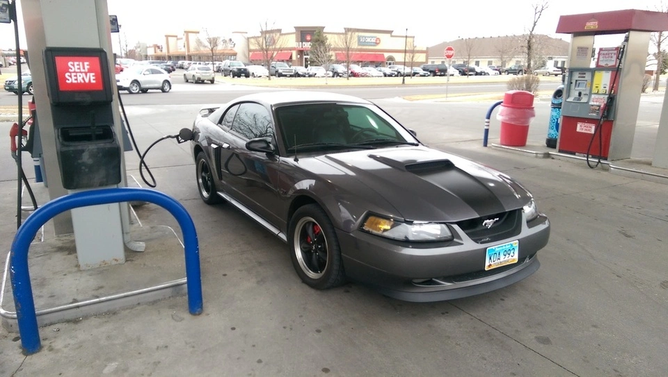

I finally bought my first mustang. I have wanted one since I was about a day old. And FINALLY, here it is! It is an 03 GT with 110k miles. Premium Leather interior, Mach Sound system, but unfortunately the previous owner took out the original sub woofer, and replaced the head unit, and it doesn't sound that good.
Its very clean, only 2 spots to address body wise.
It's a 5 speed car, with a few things done to it. AccuFab throttle body/plenum, BBK cold air intake (I NEED to get a new filter, it has a Spectre on it...), Magnaflow exhaust, not sure what type of clutch, but it is not stock. It is heavy, but very streetable. Also has an MGW short throw shifter.

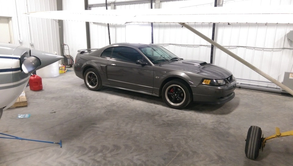

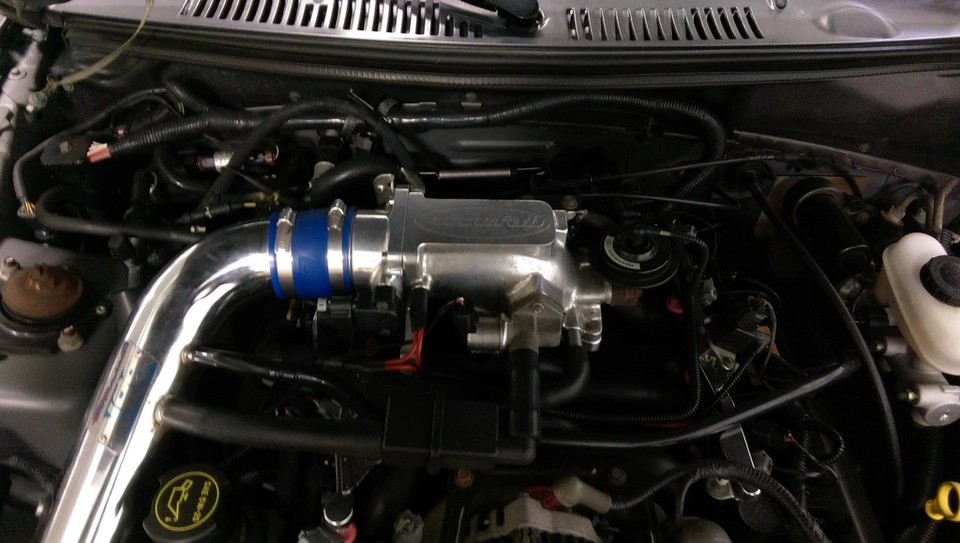

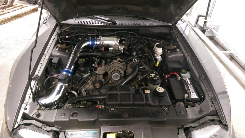

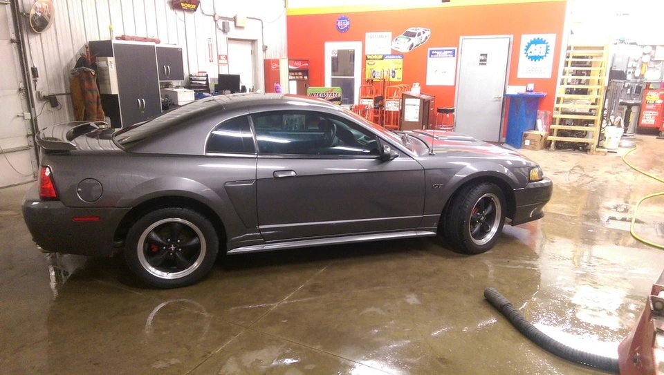

I took a couple pictures today of the car. Just a side shot and an engine bay shot.

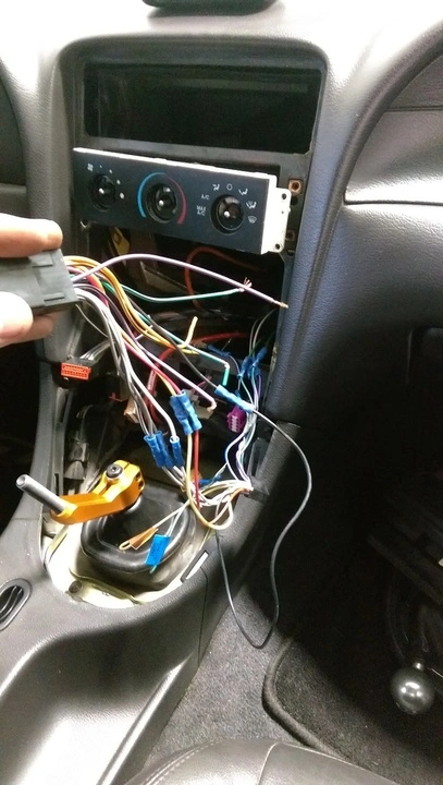

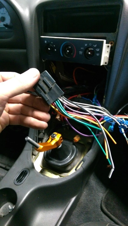

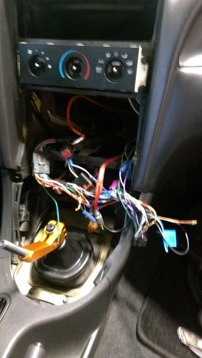

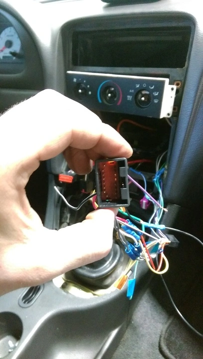

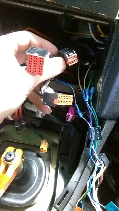

Here is my stereo wiring mess....it had a Mach 1000 stereo in it, and the previous owner put a new deck in, and got rid of the amp rack, and subs in the back. It sounds horrible right now and I want to fix it. I have not looked in the doors to see if it has the stock speakers in, but it has the stock tweeters by the side mirrors. Also I believe the rear has been replaced with just 2 speakers. I have no idea how to fix what is going on here. Maybe you can help.
In addition to all the advice, I'd say to also try cleaning out the throttle body by the blade. Sometimes aftermarket TBs get carbon buildup around the blade and causes the blade to not close properly. Otherwise everyone else gave you sound advice.

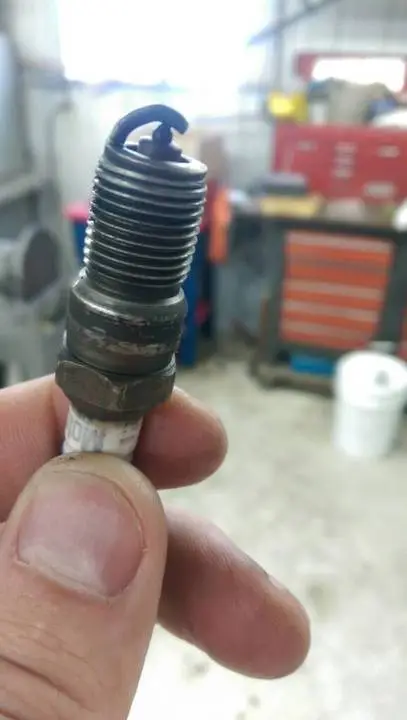

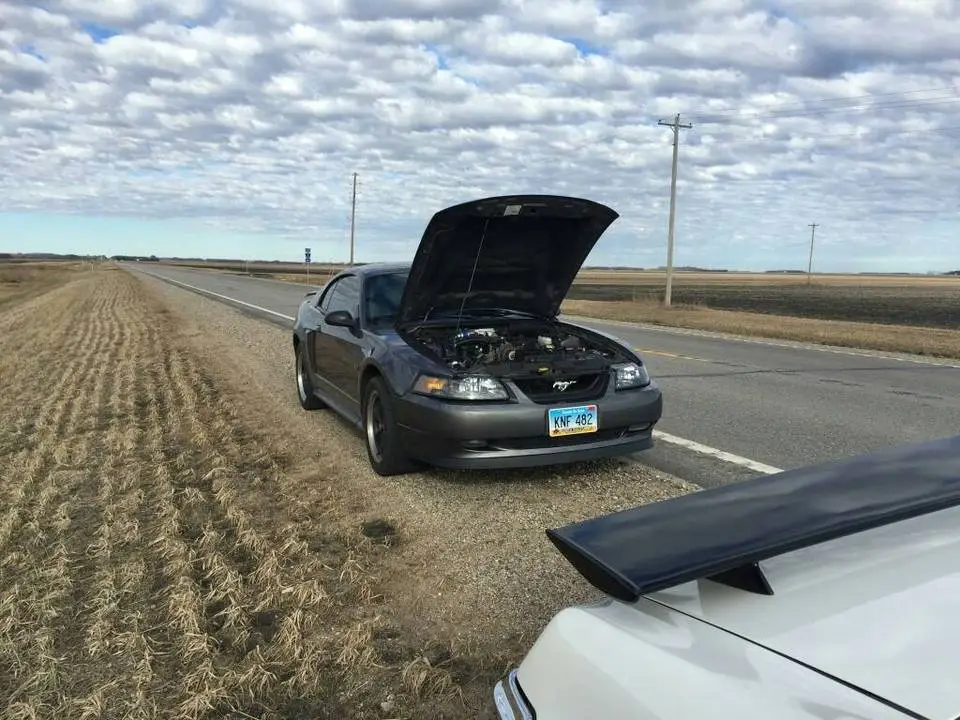

I blew out a plug today :( number 2. It really sucks! I bought a kit to fix it, but am Leary because it's not a Time Sert Kit. But I've also heard good things about them. It would be hard to swallow the 400 dollar price tag on the time sert kit.
