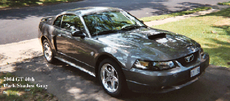

Yea, Congrats Falconguy :nice:
I just got mine to, and I do love it :banana:
