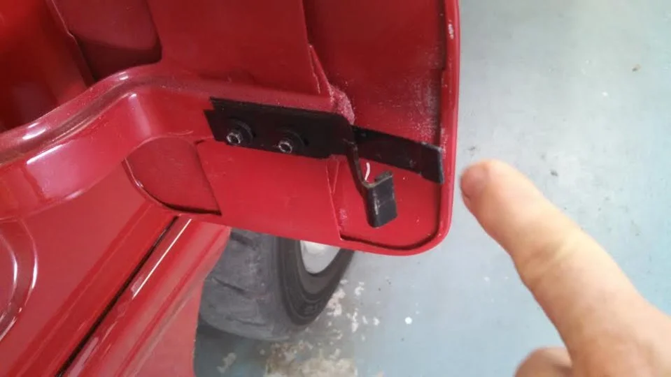

I recently purchased an 89 Mustang GT Convertible and I am having an issue with the automatic fuel door. The electrical works fine, I can hear the disengaging of the fuel door, the problem is that the fuel door doesn't "pop" out. I always need someone to pull out the fuel door when I push the button because I can not do it alone. Any help would be greatly appreciated.

Fuel door, there is a small black metal tab on the door that springs the door open maybe its too flattened.

Yeah, what he said. Here I took you a pic. I'm pointing at the little tab that pushes it away from the car. I should mention that it only pushes it out far enough for it to unlatch and you to get a finger behind it to open it. It won't magically pop open.
