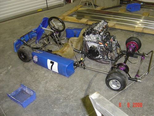

Well ever since my car has ran a few 10 second passes i had to start some other crazy project to keep me from getting burned out working on the mustang all the time. I nick named it "Death Trap".

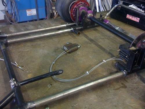

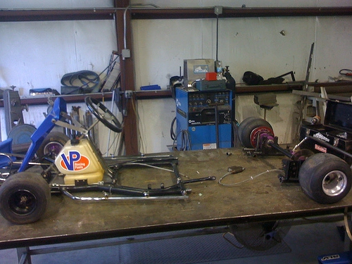

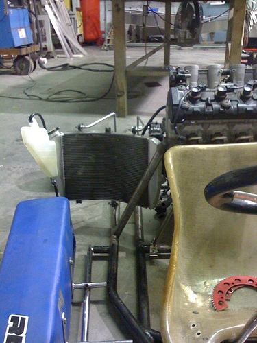

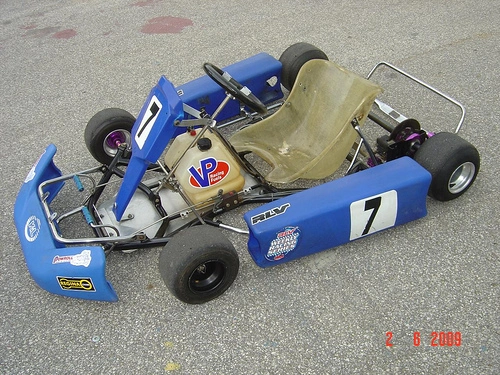

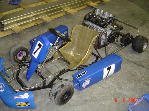

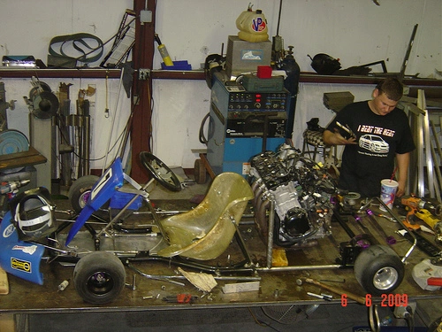

Its a 2005 GSX-R 600 motor on a kart chassis. I'm sure you have seen the videos on YouTube about these super karts. Well i decided to make my own, and all i have to say is this thing is wicked fast, iv only played around with it in 1st gear. I cant even explain how fast this thing picks up speed when it starts to hook.
Well i will post a few pics of the build, and a video of the first test run from yesterday.

Well as of right now, i have about $2000 into it. That includes: Rolling Chassis, Motor, and All Electronics). That does not including my labor and all the custom parts i made at my fabrication shop. If you paid someone to do this it would get expensive really quick. I tried taking my time and do it right and not ghetto rig stuff. The chassis is pretty stout with all the bracing i added and iv been toying with different chain tension designs and i think i have it narrow down. The site that i am with MotoKarts When Shifter Karts And Motorcycles Collide, the people are spending around 4-8k on these little rocket ships depending on engine/chassis combo. I think i will have around 3-4k into mine when i am completely done (again not including my labor and metal and stuff from my shop).
Edit: I can go to a 6" rim which then i can go to a wider tire that is still a kart style tire. Even with wider tires, with such a small diameter they will still smoke em. I could go to like a ATV wheel and get some flat track ATV slicks, but im not sure how they would effect the handling.
