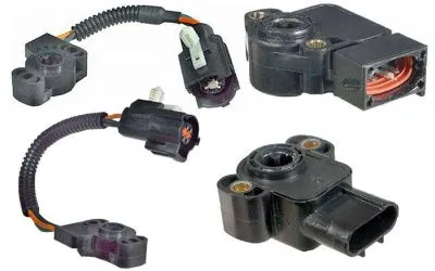

7. With Ign On Eng Off, check TPS voltage output....if it's between .7vdc - 1.0vdc, it's OK. This voltage check should be done between the Green and Black wires at the TPS side connector as shown in the pic below....(-) terminal of the DVOM on the Black wire and (+) terminal on theGreen wire.
