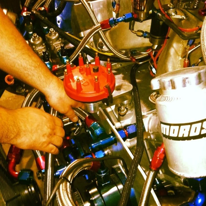

srtthis the guy doing it does every local racers rear end 15 Year Member Jul 3, 2009 5,129 1,666 204 Maryland May 23, 2013 #1 May 23, 2013 #1 finally can get rid of that junk ass small cap we had to run before. also makes getting a cap and rotor much easier Reactions: 84Ttop and Sharad

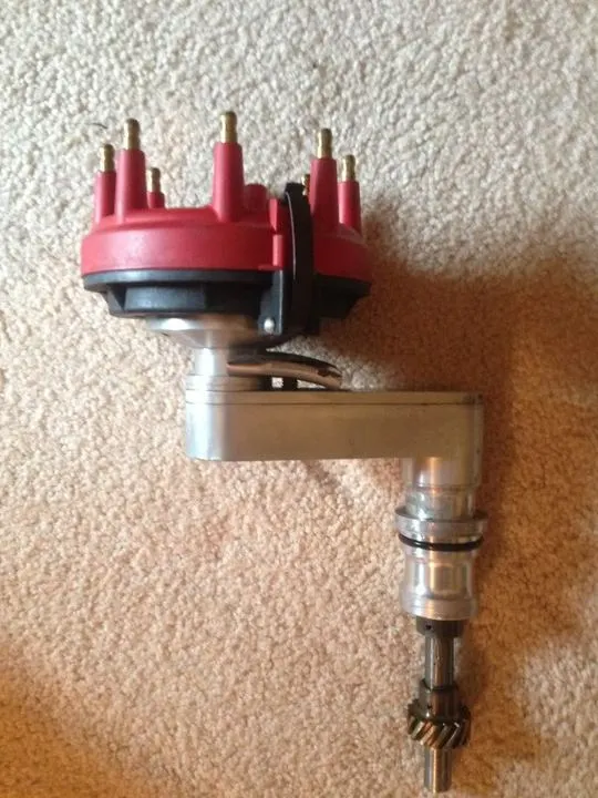

mikestang63 SN Certified Technician Aug 27, 2012 11,606 8,859 214 In the garage May 23, 2013 #2 May 23, 2013 #2 I had one like that, but mine was bent to the right.
srtthis the guy doing it does every local racers rear end 15 Year Member Jul 3, 2009 5,129 1,666 204 Maryland May 23, 2013 #3 May 23, 2013 #3 we can swing it around... our location doesnt make a difference for us. we gotta phase it in one way or another

MikeH686 Mine is only two inches though. 10 Year Member Oct 11, 2011 2,843 1,753 184 Waldorf, MD May 30, 2013 #6 May 30, 2013 #6 Do you know what connects the cap shaft to the gear shaft? Hopefully a set of gears or whatnot
srtthis the guy doing it does every local racers rear end 15 Year Member Jul 3, 2009 5,129 1,666 204 Maryland May 30, 2013 #7 May 30, 2013 #7 Small belt... All it actually does is spin the rotor. We don't have anything inside of it pick up wise. Everything is done on the crank trigger
MikeH686 Mine is only two inches though. 10 Year Member Oct 11, 2011 2,843 1,753 184 Waldorf, MD May 30, 2013 #8 May 30, 2013 #8 Right it seems like that would be a bitch to change out
srtthis the guy doing it does every local racers rear end 15 Year Member Jul 3, 2009 5,129 1,666 204 Maryland May 30, 2013 #9 May 30, 2013 #9 MikeH686 said: Right it seems like that would be a **** to change out Click to expand... Nah about 5 minutes
MikeH686 Mine is only two inches though. 10 Year Member Oct 11, 2011 2,843 1,753 184 Waldorf, MD May 30, 2013 #10 May 30, 2013 #10 You sir have tiny fingers haha
