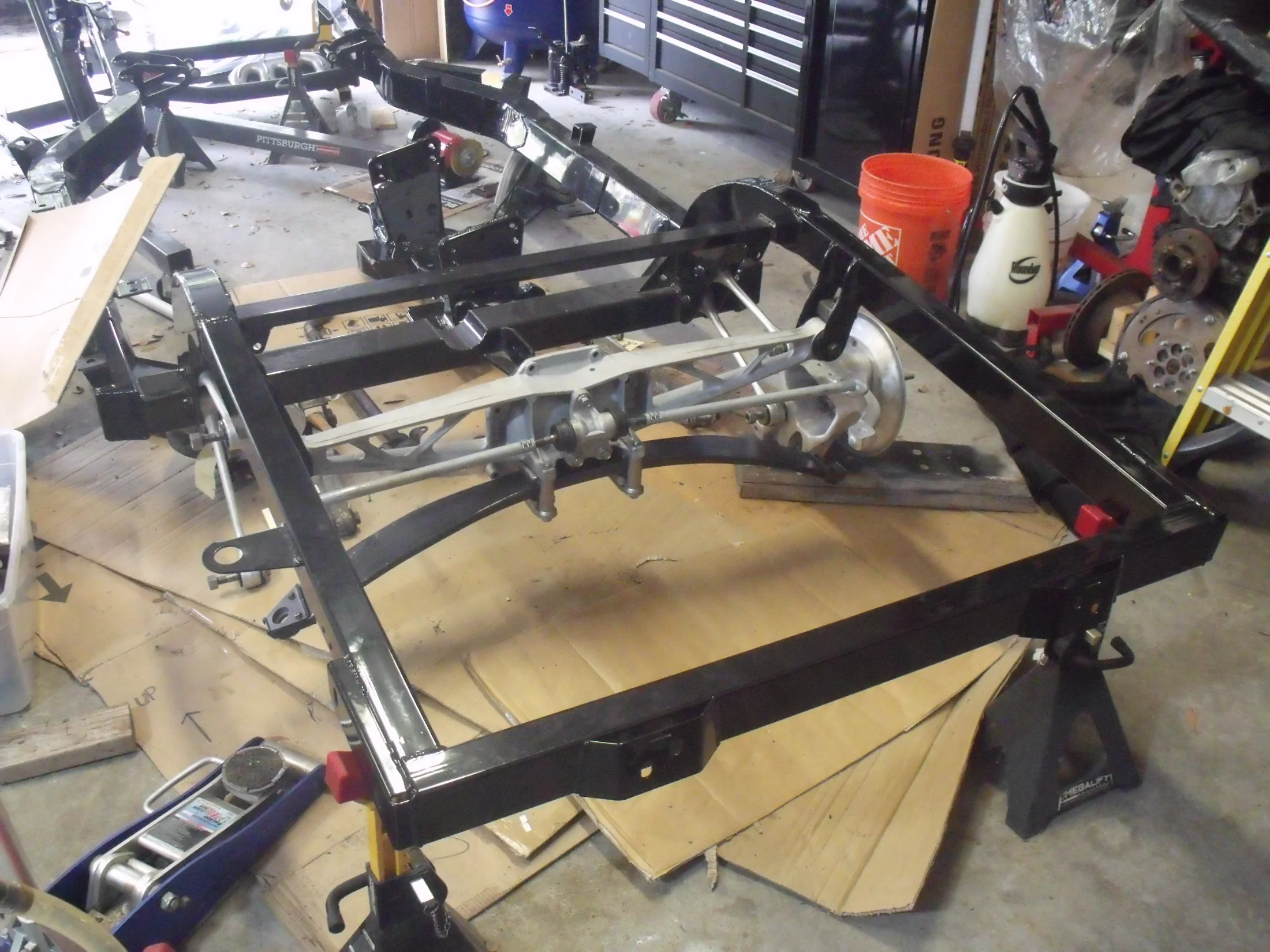

Two front bearing/hubs ( timken) and two upper AC Delco " gold " upper ball joints were over $500 dollars for my C4 suspension for my " other " project... ]
Got it converted to Holley Terminator-X computer EFI along with new fuel tank (cobra) with dual pumps (hellcat), 10AN feedline and 8AN return with Deka 80# injectors and E85.
Had Andrew Borodin (DREFI) write the base tune and it runs great.
