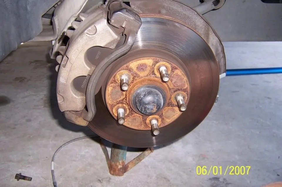

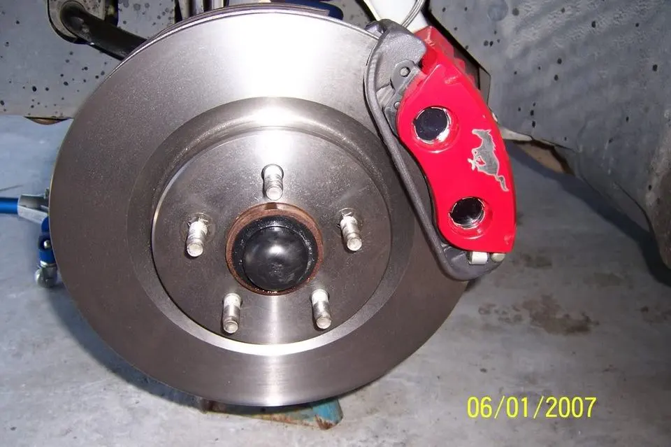

Go to buyfordracing.com and check out their deals. Bullit upgrades $359 for the fronts, come with brembo rotors, bullit calipers with brakes pads and ss braded brake lines. Just did the wifes car and they look great. Not slotted and drilled but what a difference.
Before
After
Before
After
Please make sure your caliber is setting right cause 2nd pic looks like the caliper is off.
Nice rotor and caliper
