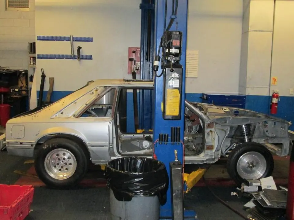

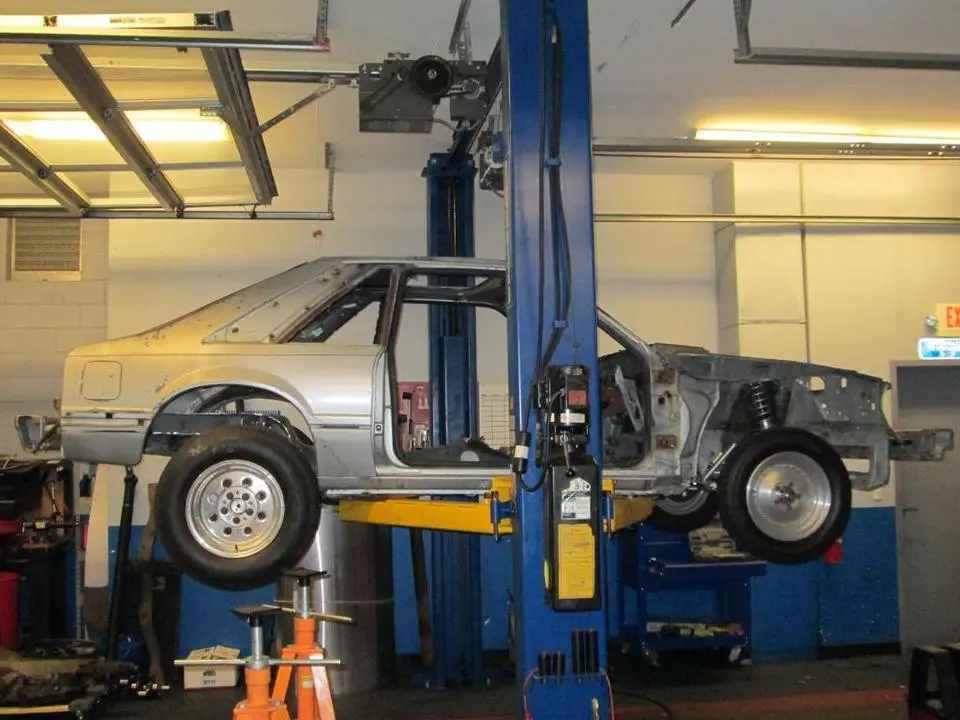

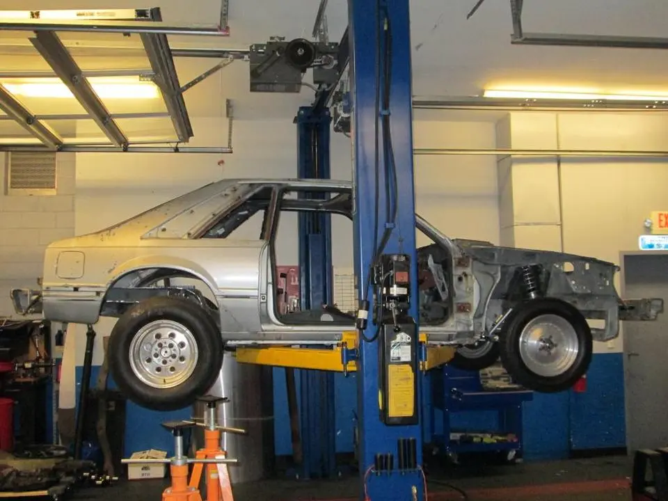

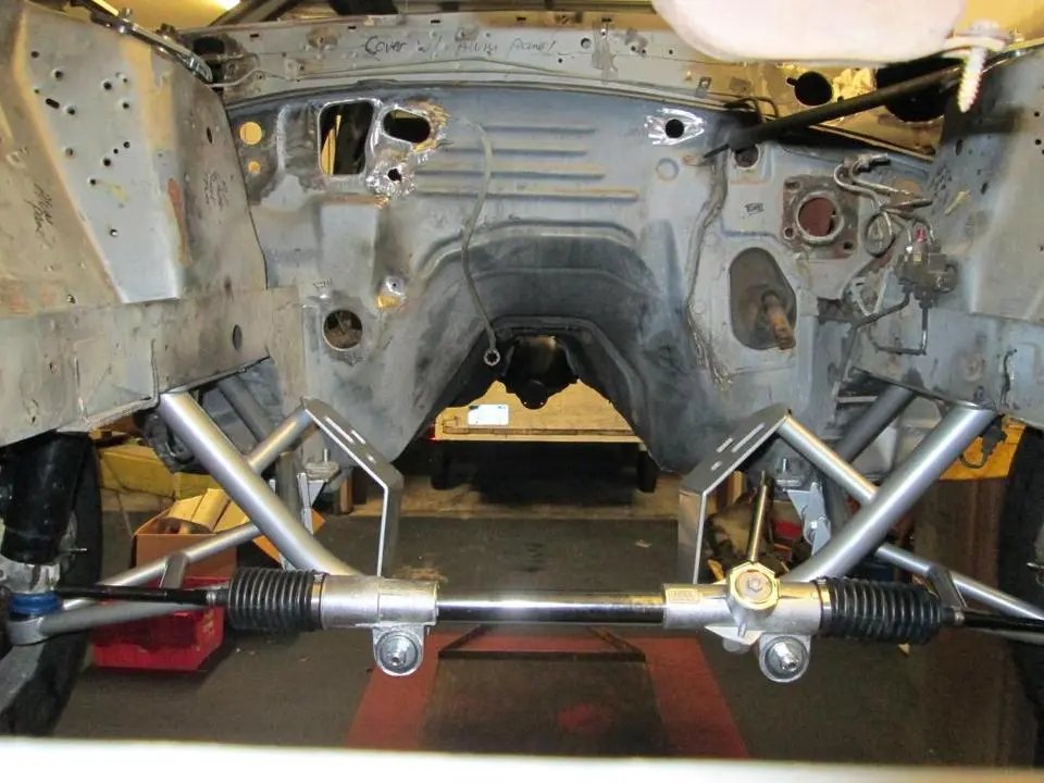

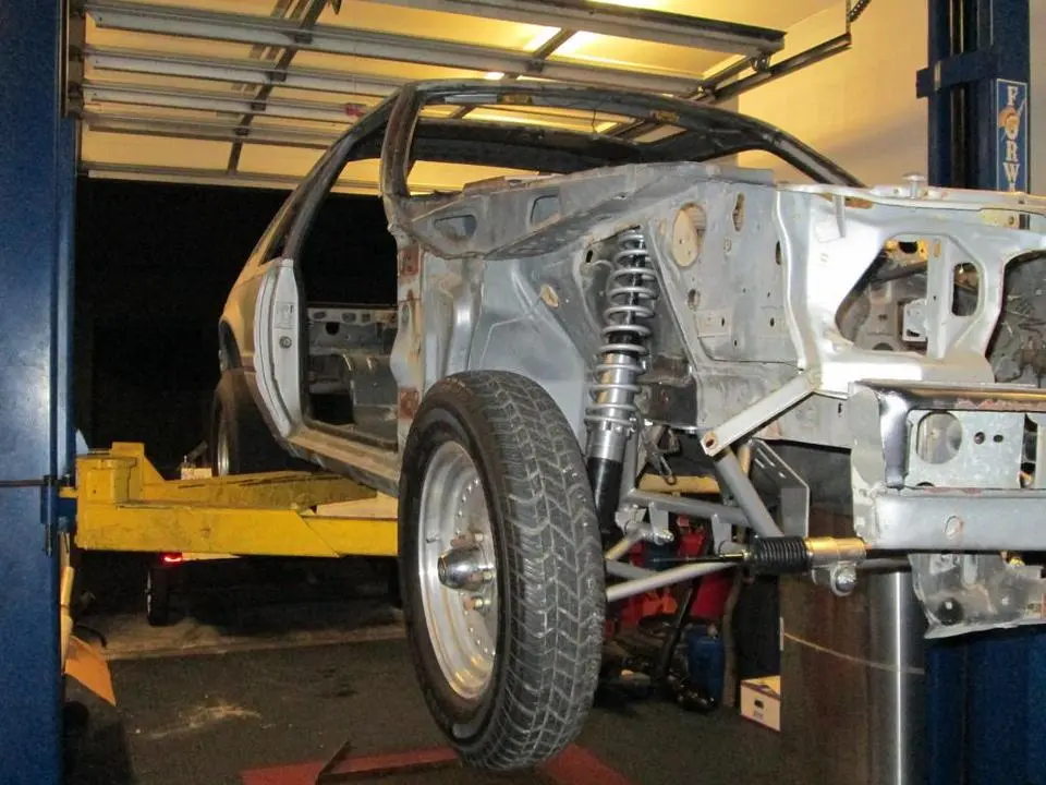

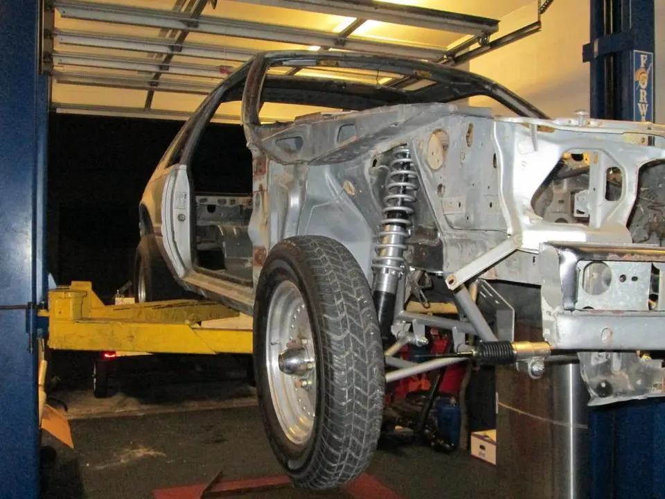

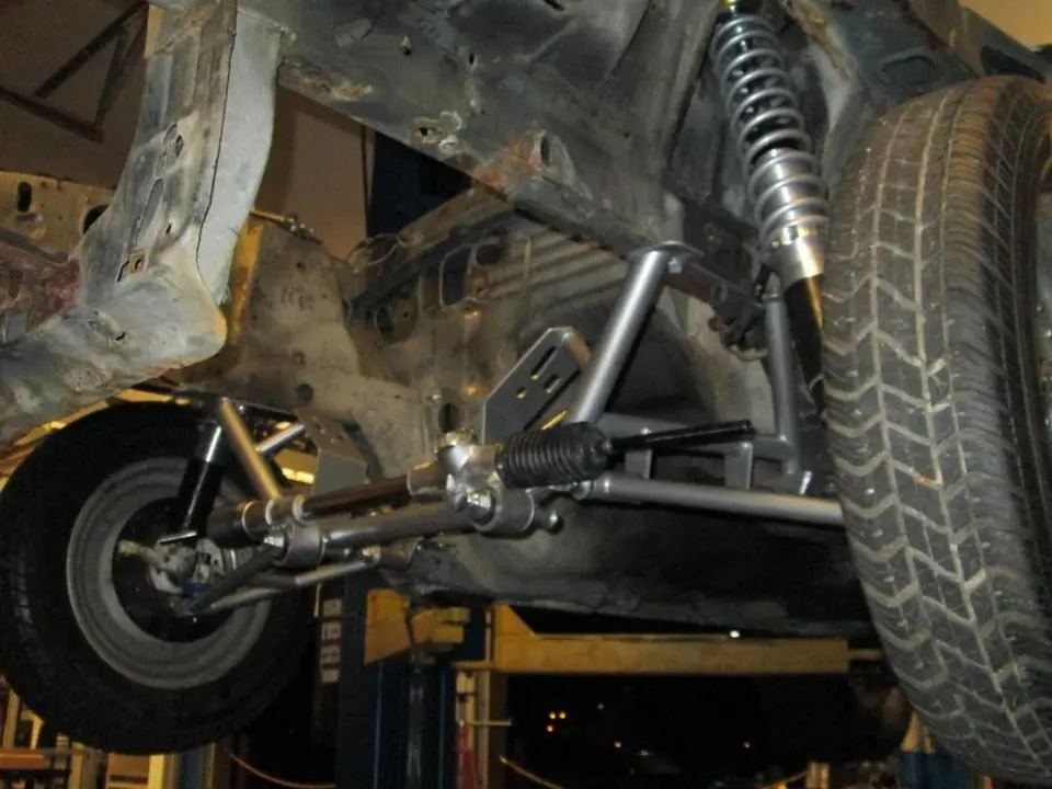

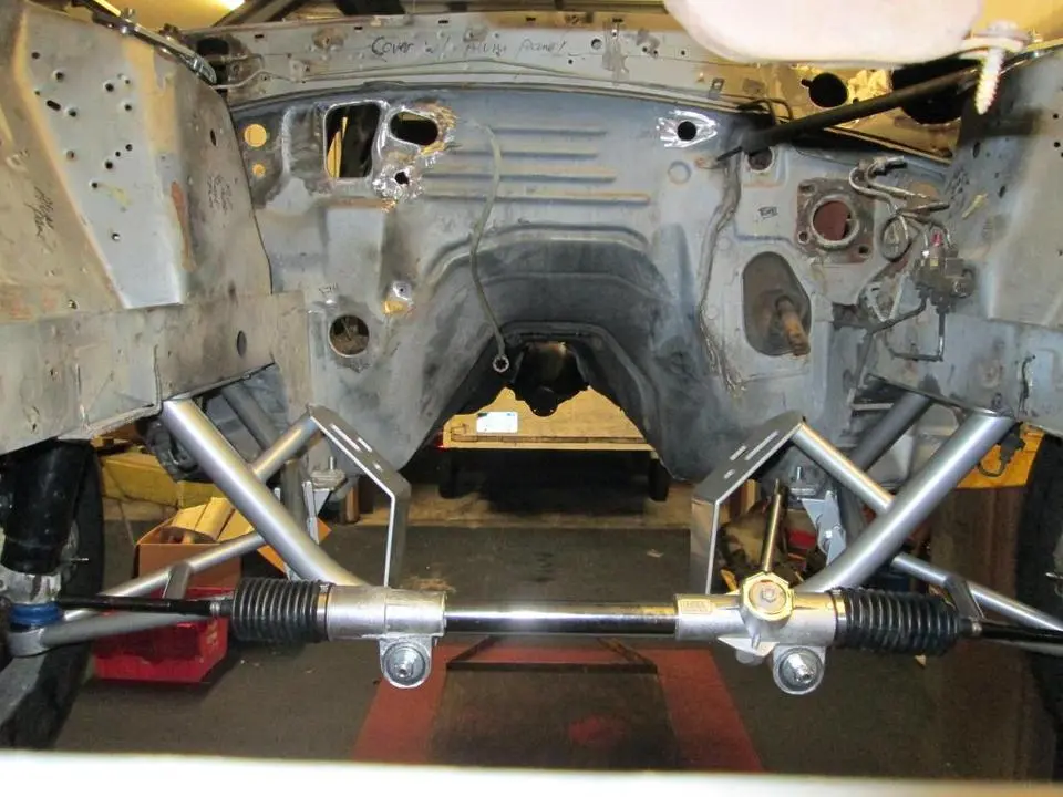

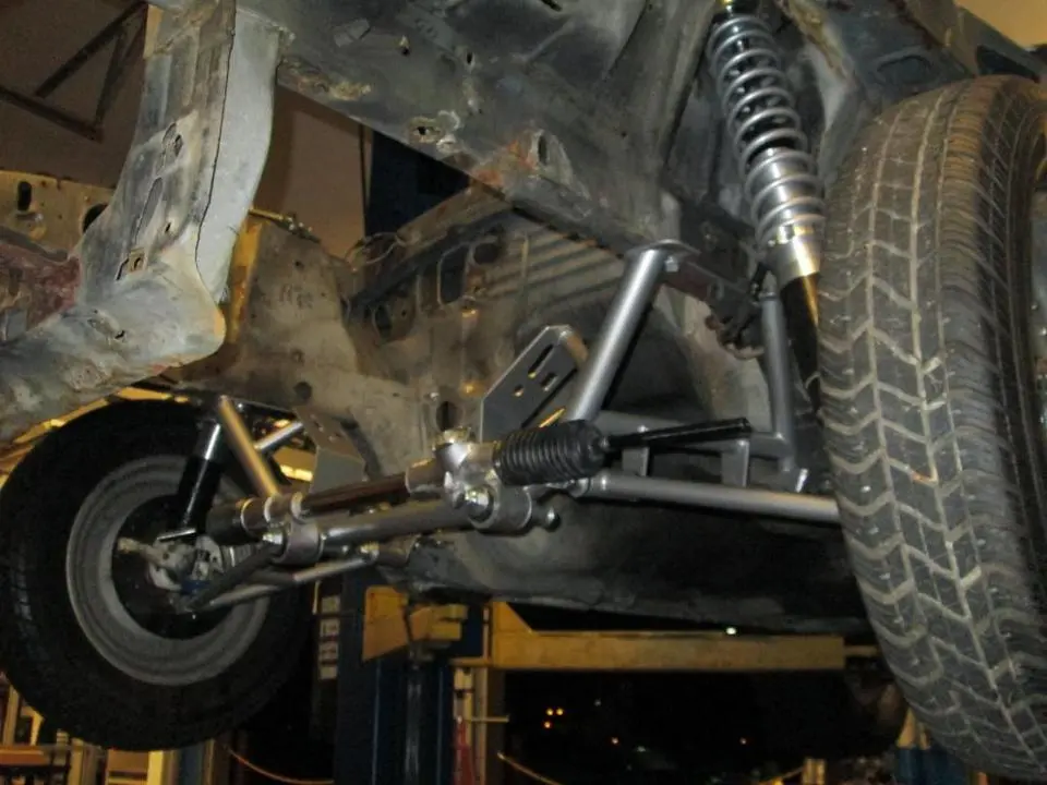

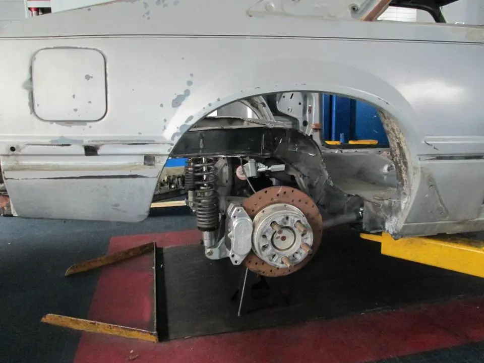

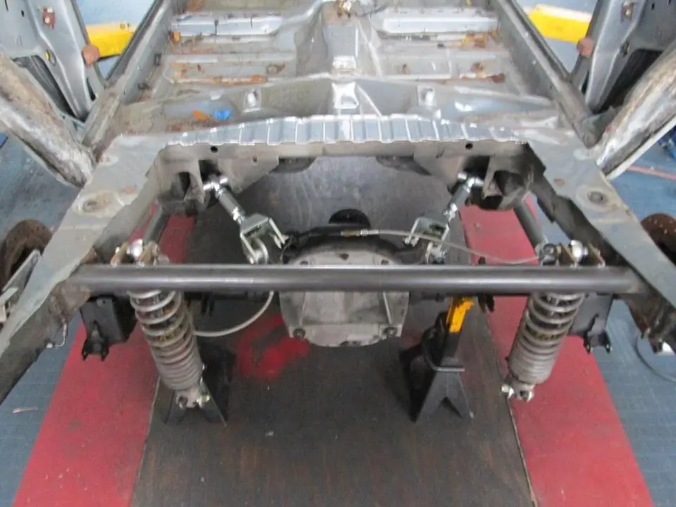

Starting to test fit the suspension and prep everything for the welding and roll cage.
Waiting on the tie rod ends and the front struts. Using some old factory ones I had laying around.

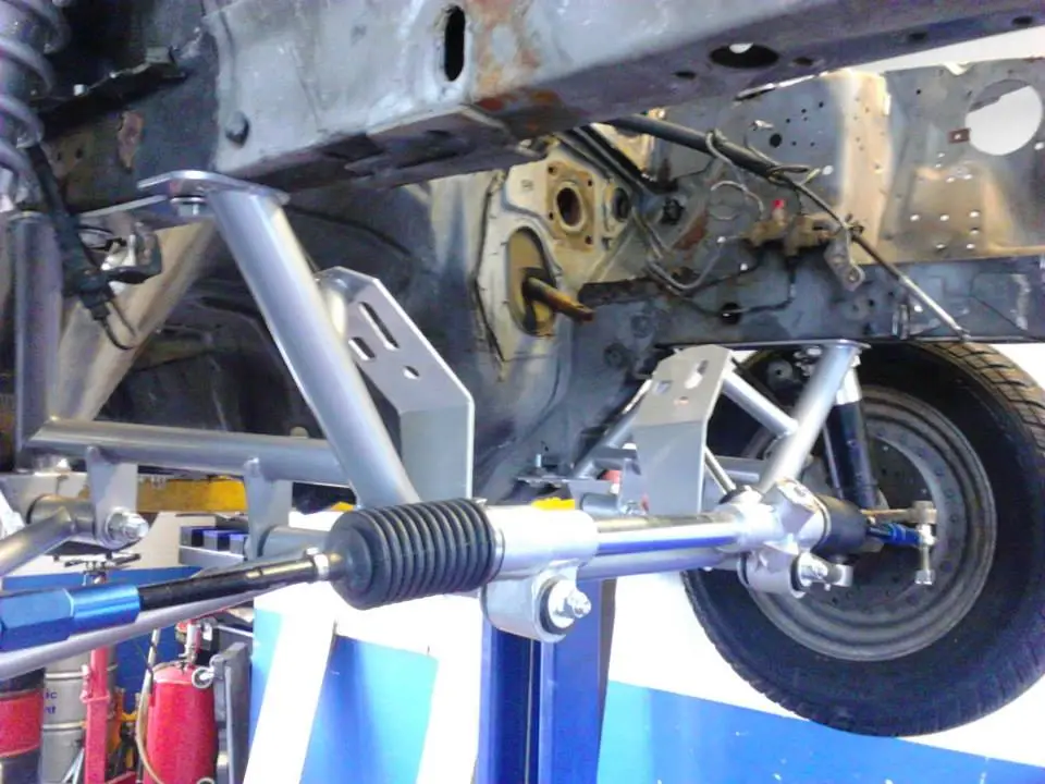

4.6 K member and Fox control arms.
Flaming River manual steering rack. I have the steering shaft, just haven't gotten that far yet.

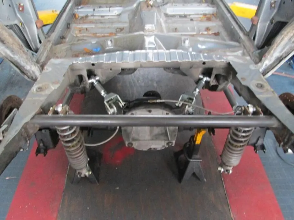

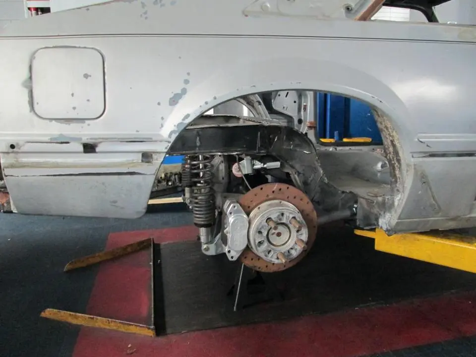

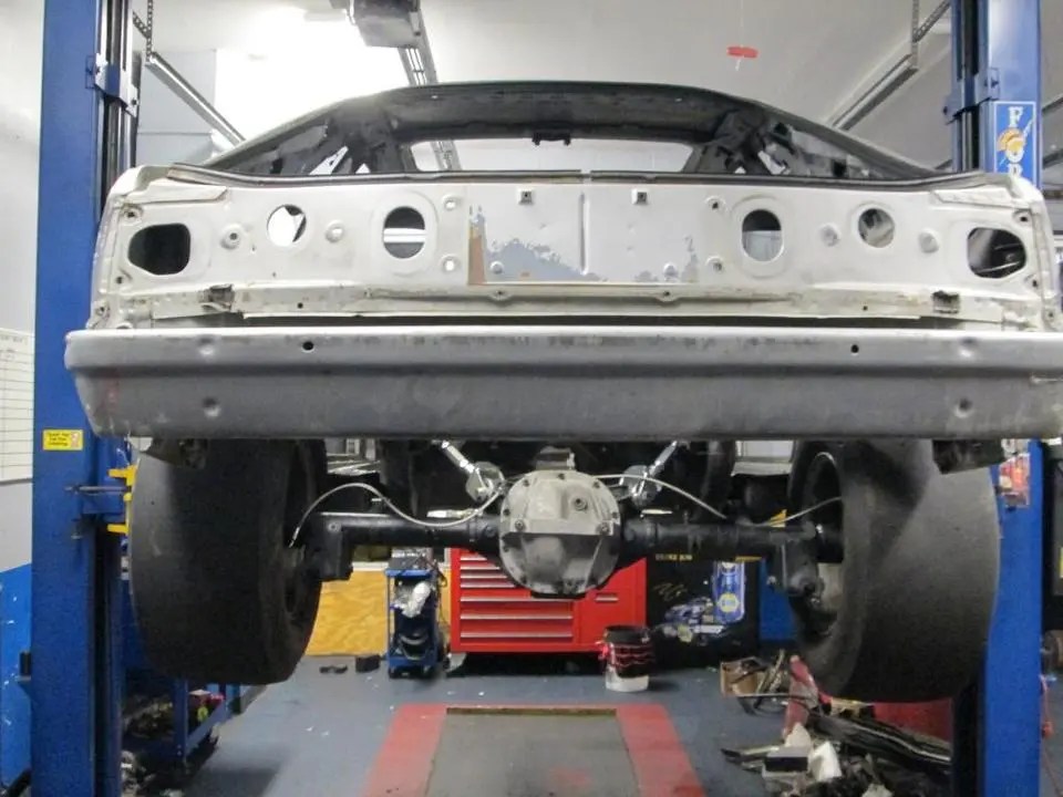

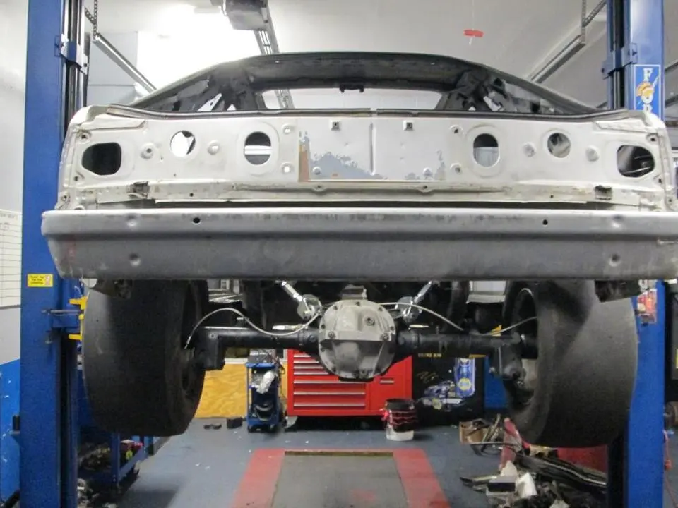

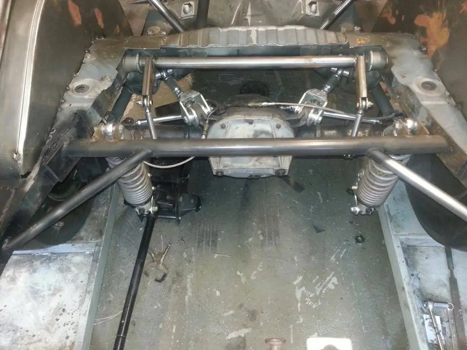

Working on the rear coil overs.
Fender rolling like a boss...

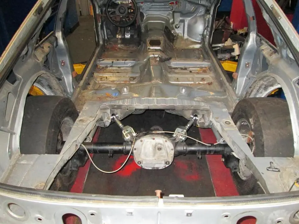

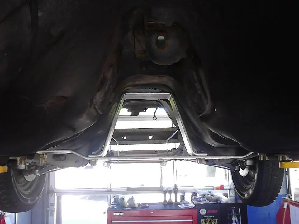

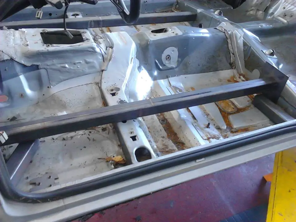

Sorry it has been a while but, with the new baby, lots of Army training lately and, being slow at work. I have been cutting hours ect and working extra around the shop so, haven't had a whole lot of time. I have started on the through the floor sub frame connectors and the plan for the motor has changed to built 2v 4.6 with a turbo and a built 4r75w tranny. I will be posting a few pics when I get the camera from work later today.

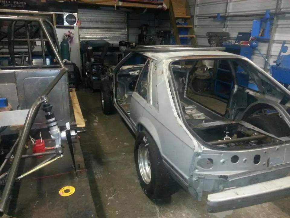

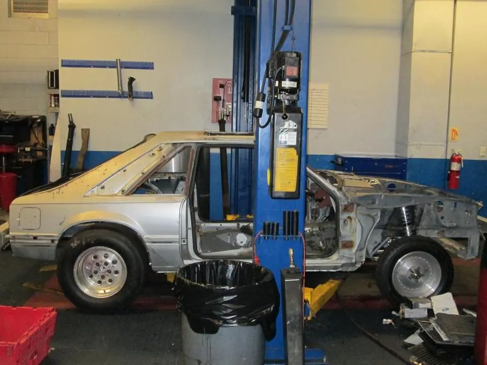

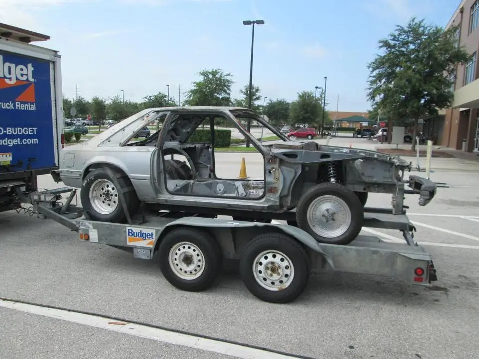

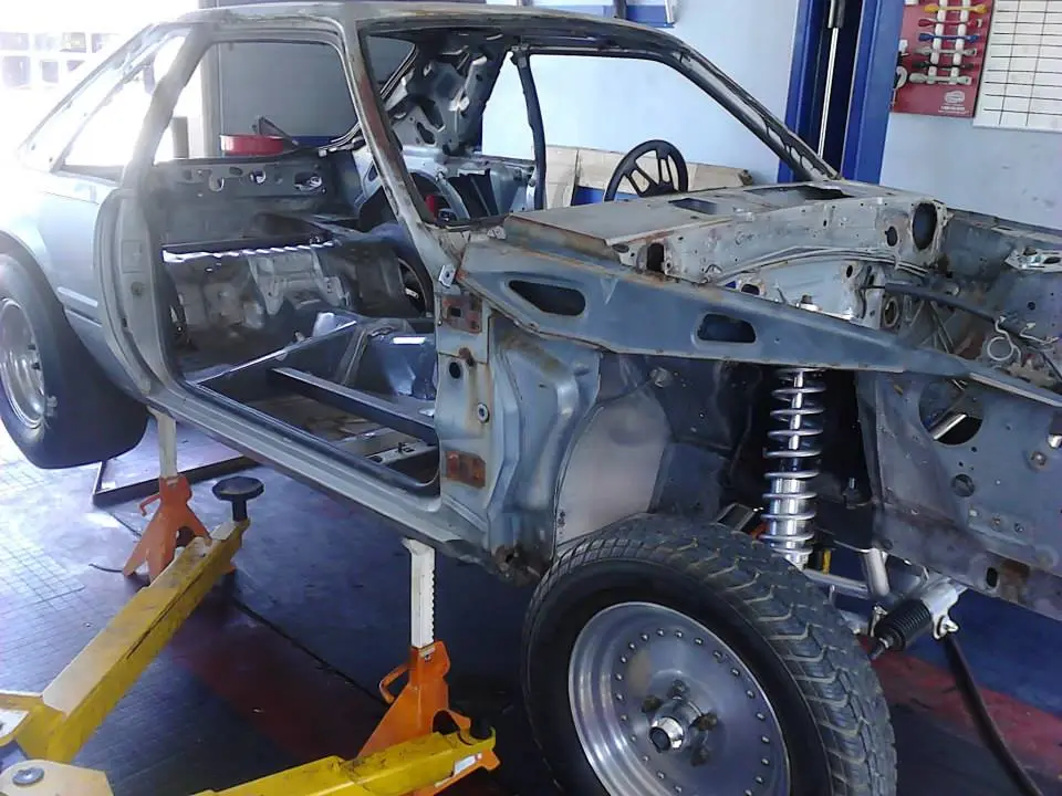

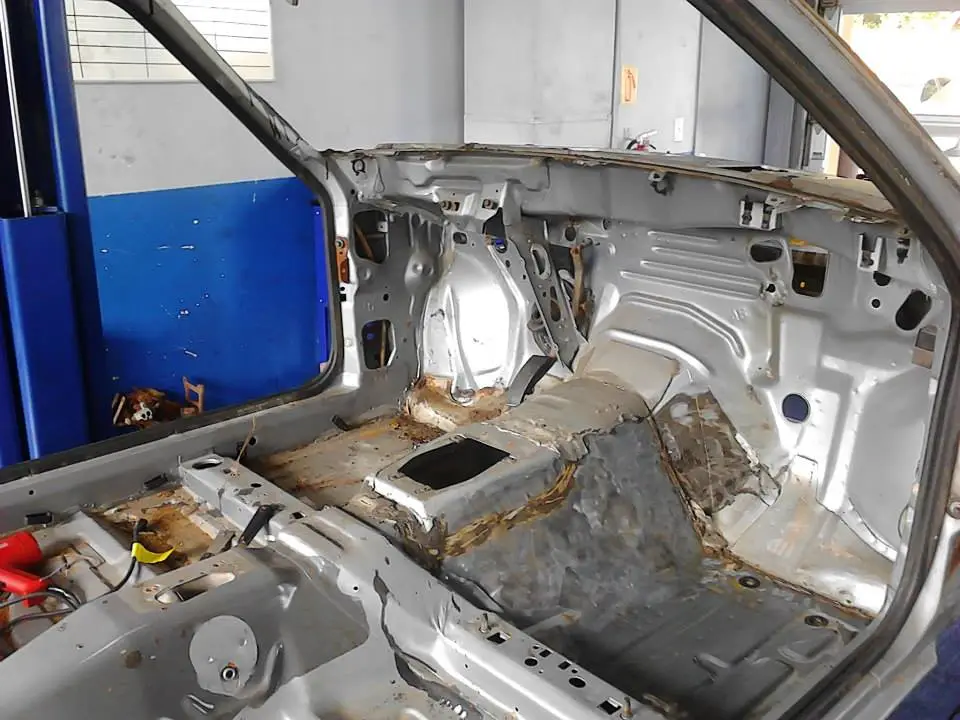

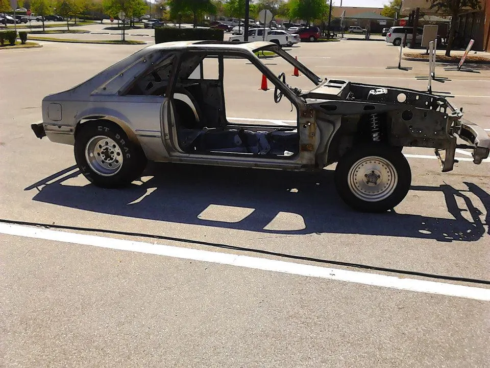

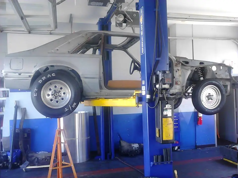

Ok, so, sponsor fell through. Took a little financial hit on that one. Oh well, Lesson learned, I guess. Anyways, Here are some more pics as promised. Monday morning the car is going to Full Moon Race Cars in Brookesville, FL for the chassis work. I will have pics of that as I they go along or when I get the car back.
Reactions: Sharad
Oh, and ONCE AGAIN, motor combo has changed. Guess I am going it alone since I can't get any one of these "sponsors" that want to help out won't commit to a contract. So, I am just going to wait until I get to that point where I need a motor and decide what I want to do then.

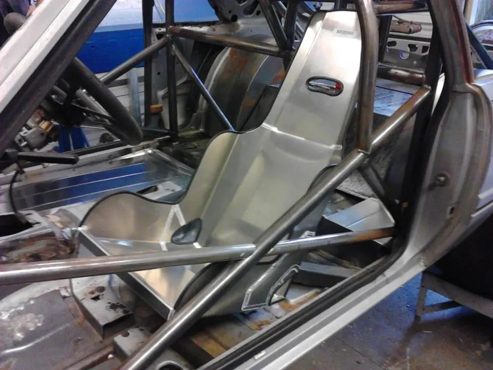

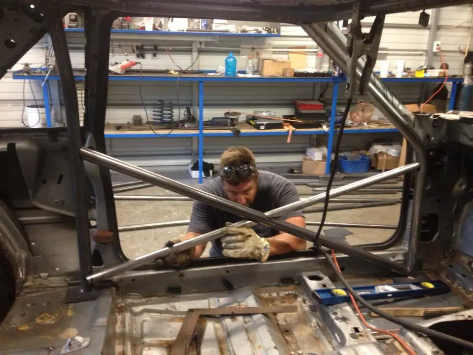

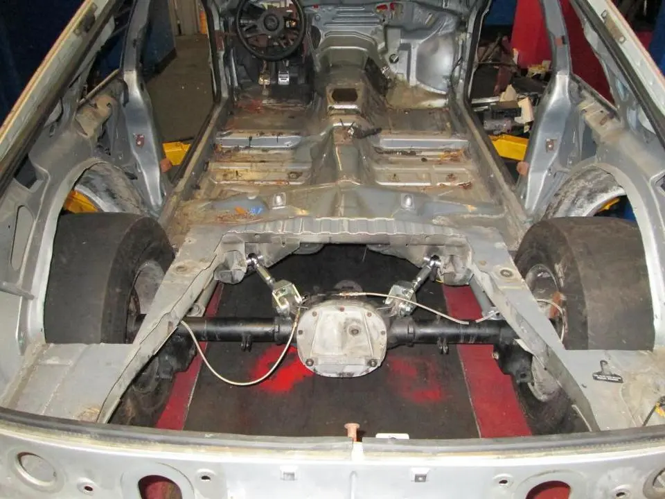

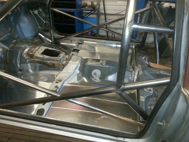

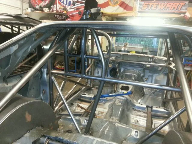

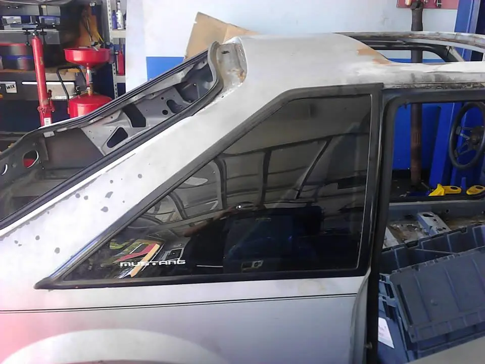

He definitely gets work done really quickly. That's rare in his profession.

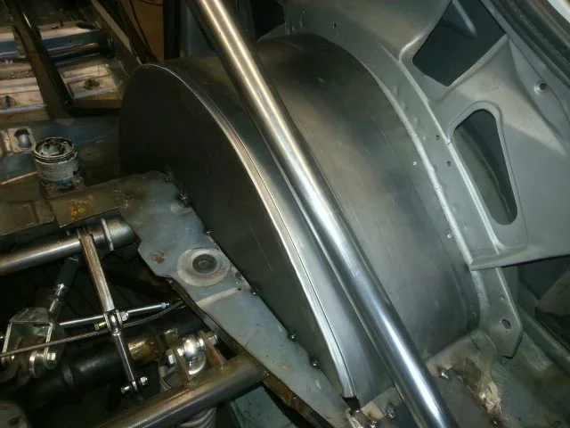

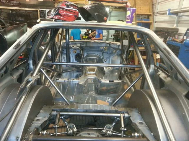

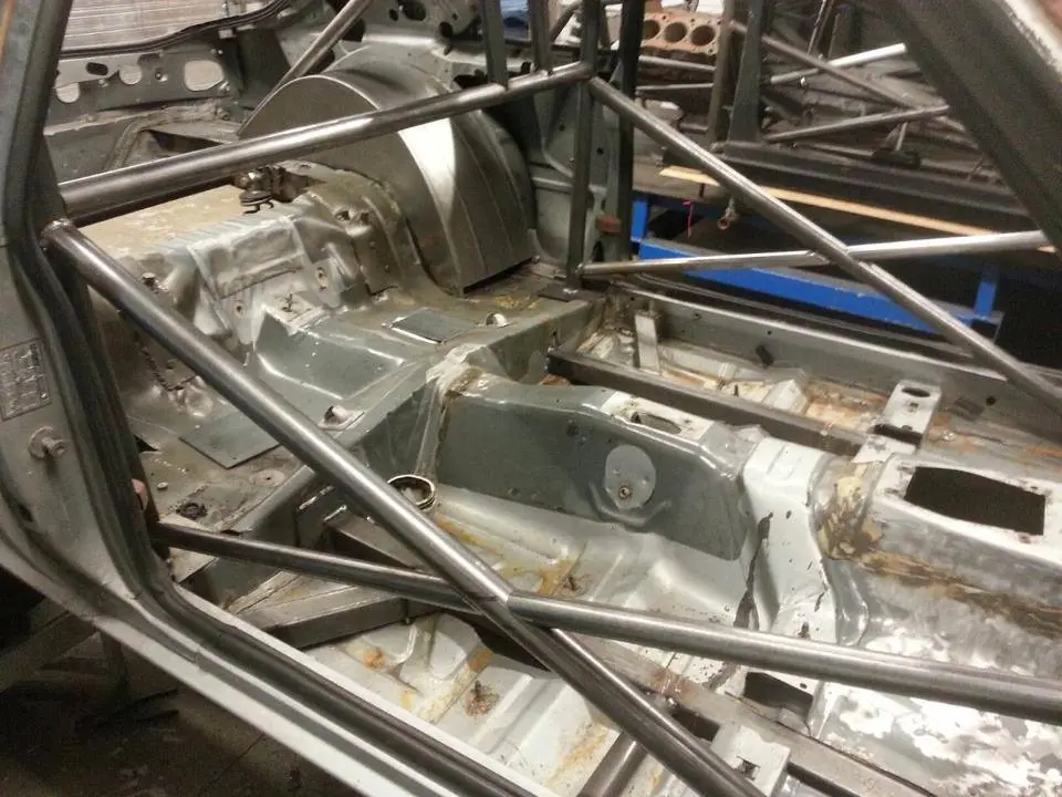

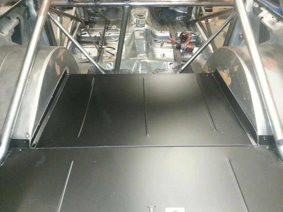

It's interesting that he put the main hoop in the back seat. Also interesting that he raised the floor.
To answer your question about the main hoop: I originally ordered the Jeg's 12pt cage and it was kinda cheesy. He used as much of it as he could and added his own stuff to it. He likes putting the main hoop where he does because it gives a cleaner look by following up the B pillar.

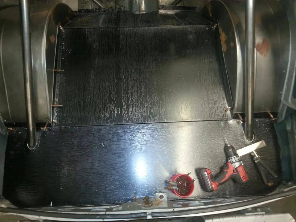

To answer your question about the floor: We aren't really raising the floor that much per say. We are just laying down a sheet right over the SFC to again, give a cleaner look. So, really, if it does raise it, its only by 1/2 - 3/4 of an inch. All of the interior pieces will be riveted is so that I can remove/replace them easily when I need to.
Lastly, I am going with a small front mounted fuel cell and and going to mount the battery box under the trunk floor along the inside of the passenger frame rail. That way it looks nice and clean and there is no need for a rear bulkhead.
