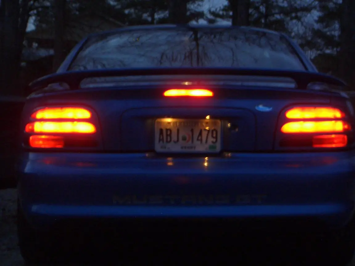

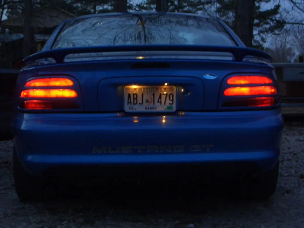

I just wired in the 3rd bar in my 95. easy to splice into the light harness.
black=gnd, tan=running lights (you won't need), the other wire (different for both sides) = brakes.
you may need some kind of converter box to seperate your signals from your brake lights. or run a seperate wire from under the dash for the signals.
you should be able to pick up a bulb pigtail from a jy for cheap. and just make it fit into the 3rd bar. if you need pics of that let me know

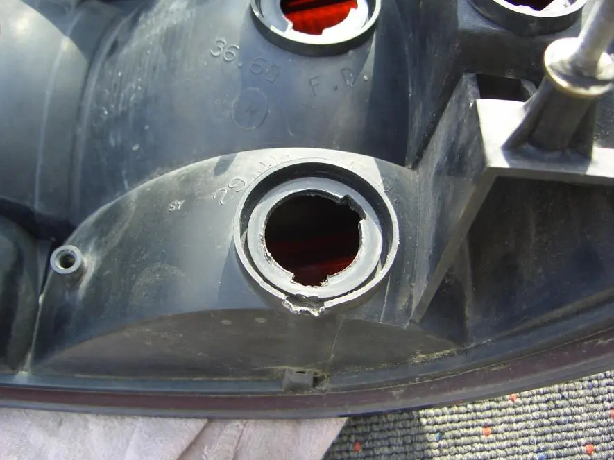

I've been wanting to do this. What did you do to make a hole for the bulb? Any more pics?
I wish there was a way to make the 3rd bar light up more...but then i guess you'd be lighting up the reverse lights area.:shrug:

used a hole saw and a file to make the notches just like the stock holes.
The 3rd bar doesn't light up as bright because that is the reflector lens and it refracts the light in all directions. maybe a bulb that's brighter than a 3157 would show up better if there is such a thing.
