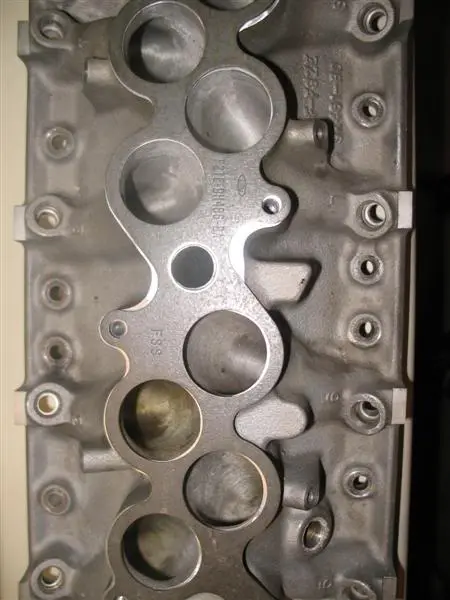

about painting it. many people shy away from painting an intake because it insulates the heat then. is it in bad shape that it needs paint?

It's not in bad shape per se, I just think it would look so much better painted. I guess I never gave any thought to paint trapping in heat... is that really a problem with painted intakes? I understand the problem of excessive heat, but how much hotter could a layer of paint actually make it? Excuse my ignorance lol.

If it looks like this then yes
