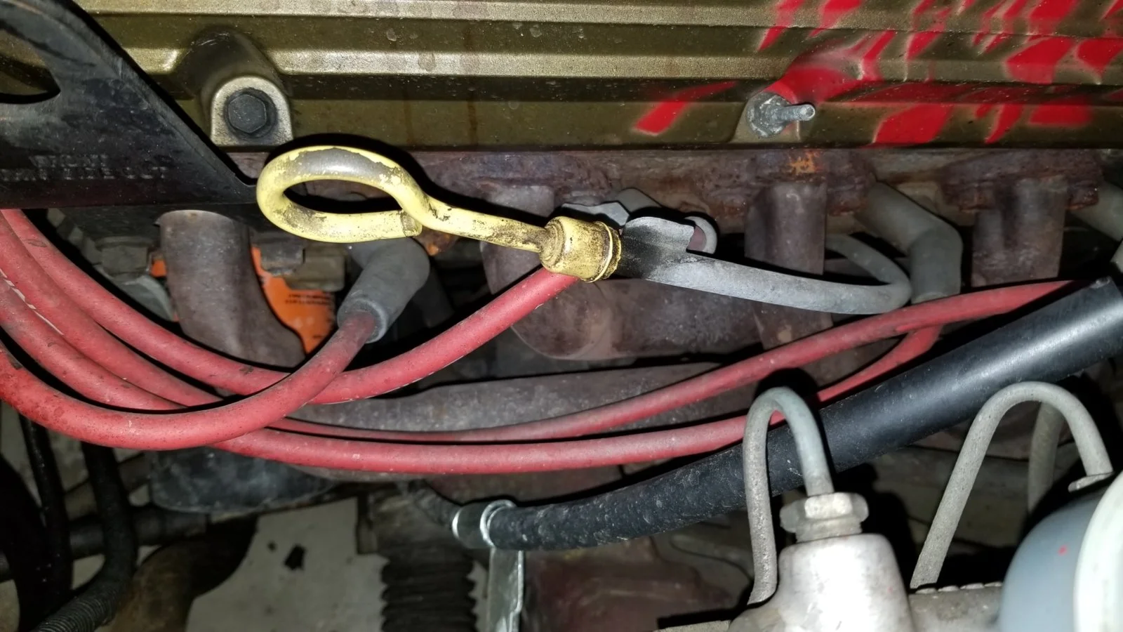

I have no idea what stock headers look like - are these stock?
They claim 225 hp. 15 might be a little on the high side. I’ve heard 8-10. Mikestang might be right though. Let’s see some pics of the car.
Eh, headers were one of the first mods I did to my '88 when it was stock. I didn't notice anything. I don't think the factory headers are all that bad but if you gave a 2.5" catbanl and h pipe and other mods it might be a better gain.
Rather than headers, if it has the stock intake I'd toss an explorer intake and 65mm TB on it. That was a good SOTP gain on my car
In goes the good air, out goes the bad. As we all know the stock stuff is a good compromise, to take advantage of any bolt on up grade you have to look at the big picture. The only mod that come to mind that you can feel without any other changes is the final drive gears. Really good bang for the buck but still limited because the working rpm range of a stock engine. Some claim as much as 25 hp from aftermarket headers but reality is more like 5 hp with no other mods.

Without increasing intake air flow, headers won't help much.

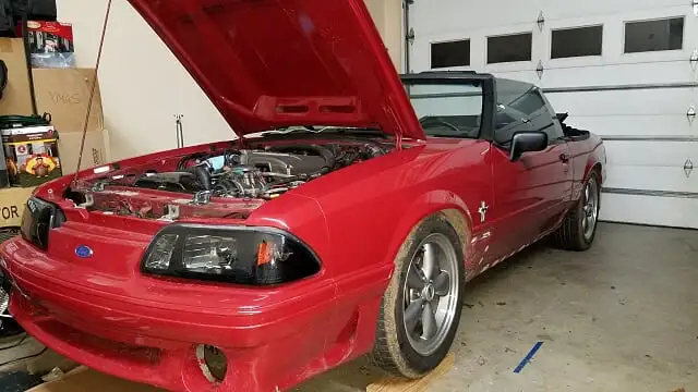

Pic (as requested eariler).
FLSC are the first item on the list. No performance mods until that is done.
I"m not sure what gears are in it - I need to verify it still has stock gears, since you can't see if that is the case. The trip home was eventful because the BBK TB would stick closed and I didn't have good throttle control trying to break it free. I found that the idle screw was all the way out, so I screwed i int until it just barely keeps the plate off of fully closed. Needless to say, a trip on wet roads with a sticking TB in an unfamliar car was something I won't forget.
I'm also getting the foglight brackets so I can install new fogs. I have a new driver window switch. The marks along the body are where the skirts were, but they were cracked and removed, and someone decided bondo'ing it would be a good idea (sigh...).
I was under the car today figuring out the bracket install and it looks like I have a leak from the water pump or gasket and from powersteering. Not bad from the PS, but it's grimed up the area, so I need to run those down.
WRT to the water pump, should I just go ahead and replace it even if it were a failing gasket? The car has 88,000 miles- what is typical water pump life in these?

Nice car. I think the gt convertible is going to be the sought after car in the near future. Convertible high optioned vehicles are always worth more than their siblings.
I really like convertibles. Coupes have the advantage in $$$ to go faster, but a proper convertible is a joy to look at, and they expose you to the elements more - it's a much difference experience, and more enjoyable for me.

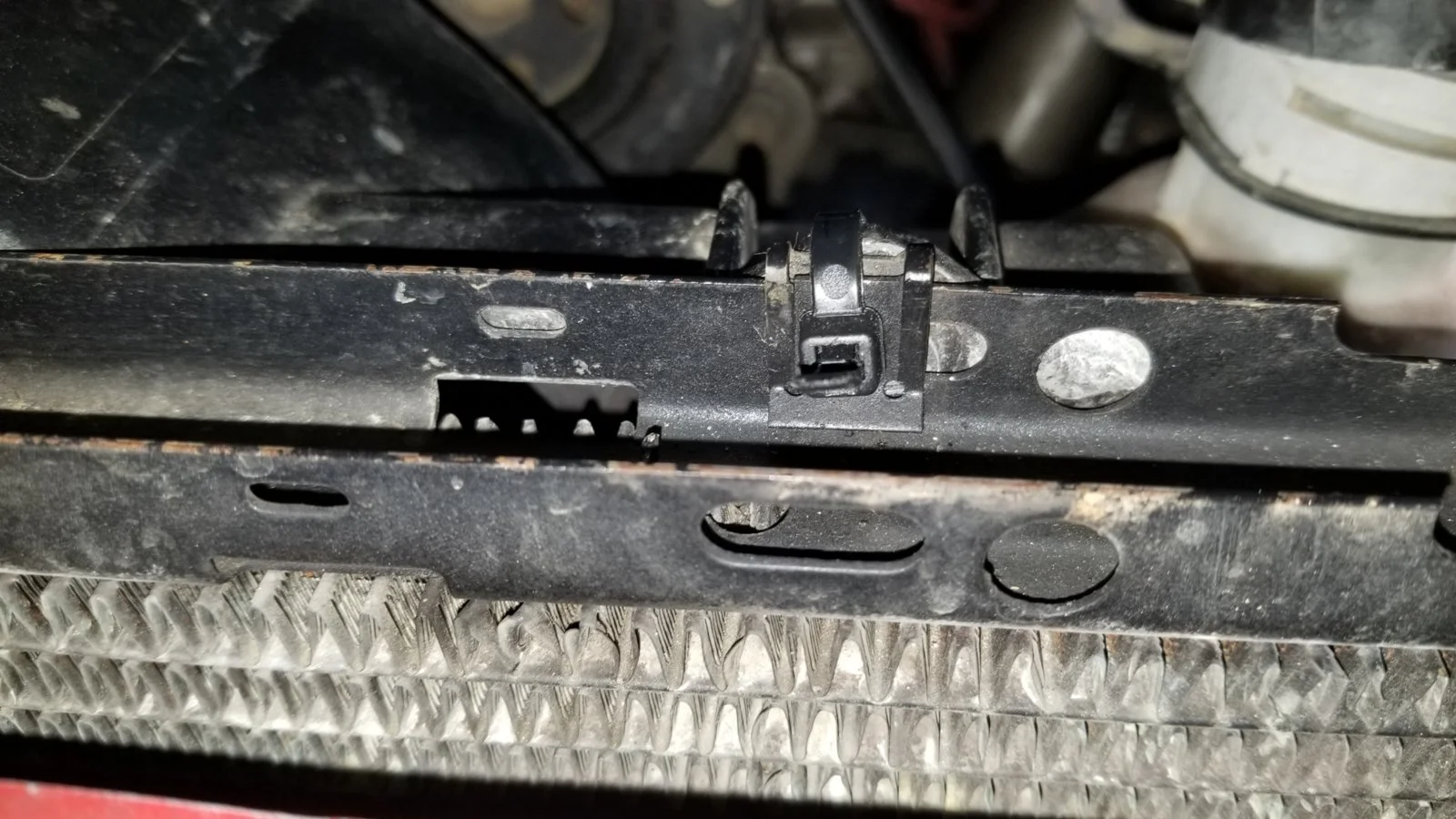

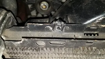

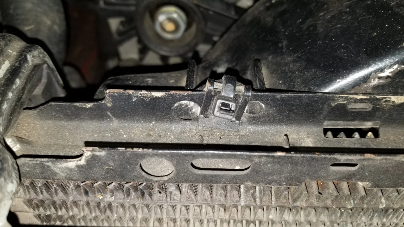

I also notice that my fan shroud is held on by 2 zipties at the top (pic below). :cautious: I assume this is an 'aftermarket' mod - any idea what size screws that takes?

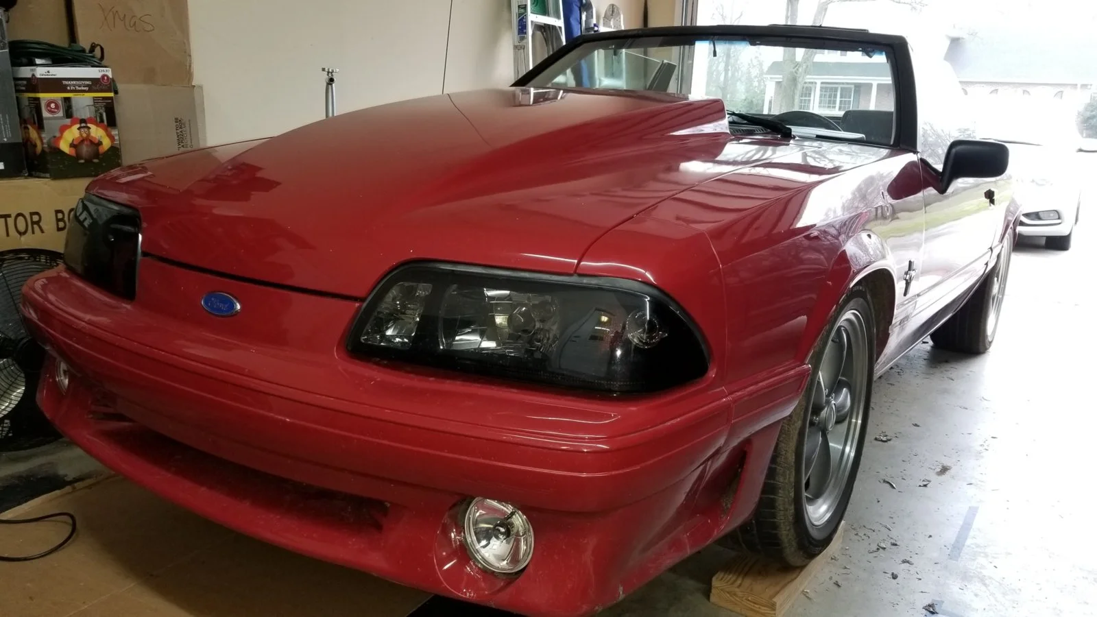

The foglights are installed - that helps the front a lot. I'll be ditching the cowl hood - I dislike how tall this one is (3 or 4 inches) and generally don't care for that look unless there is a big blower underneath or sticking through it.
