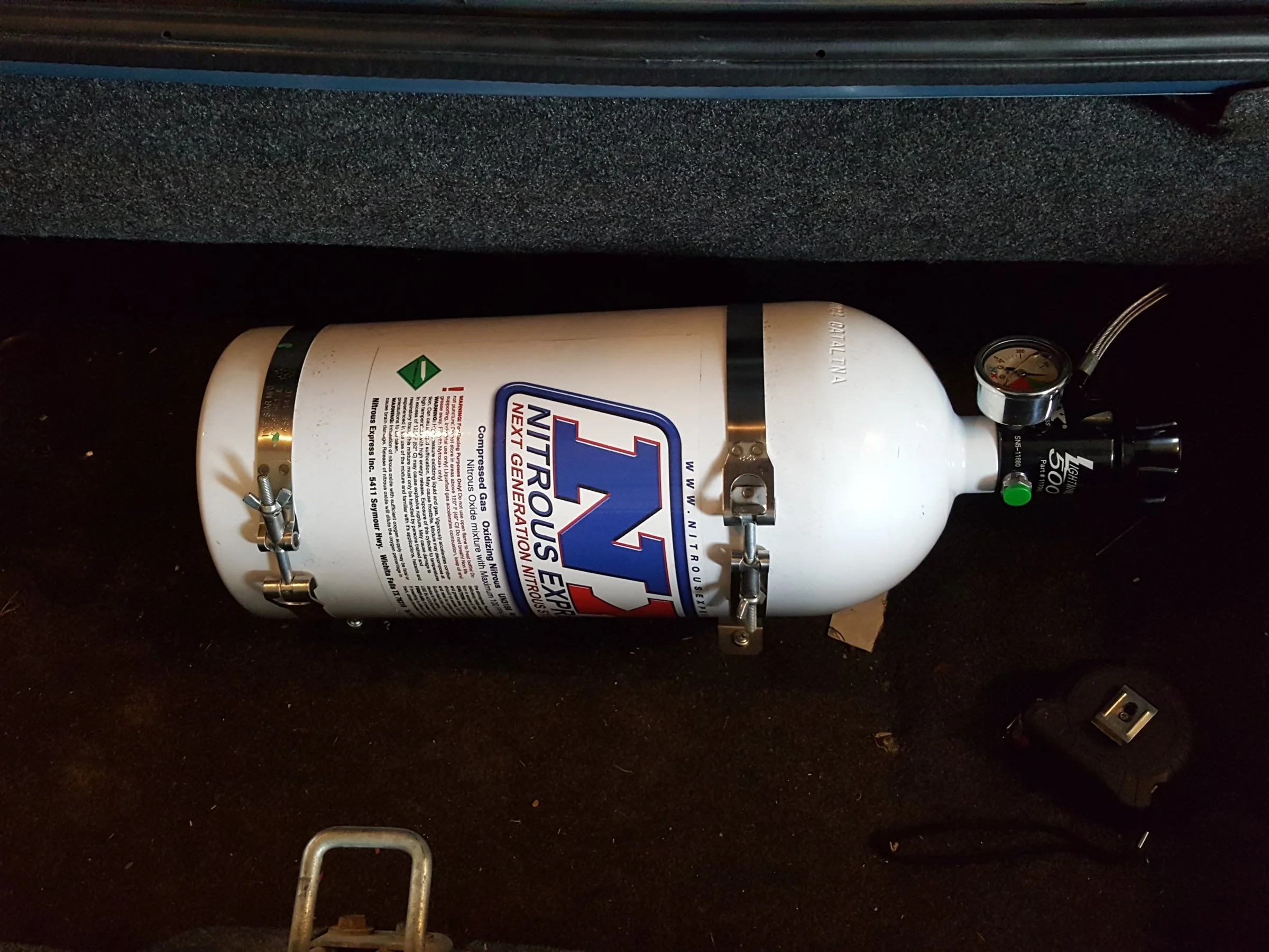

Just installed nitrious kit couple weeks ago. Just wanting to know the safest way to store and if someone could explain how the pressure disc works that would be great for sense of mind. Thank you.

Pressure disk is merely a way of preventing the bottle from exploding due to over pressure. It's similar to what is used on paintball tanks or any other pressure cylinder. If the pressure reaches a point usually stamped on the disk, it ruptures and all the gas vents from the bottle. You'll need to replace the disk at that point.
Usually people say you must vent the disk with a line leading outside the car, but if that disk ruptures at 500psi or higher, a plastic line is not gonna do much to contain it.

That's my worry that it could blow up after seeing article that one blew up. But was in hatchback. Under glass in the sun all day. Car is in garage year round and have been storing on floor mat upright. Thanks for info
