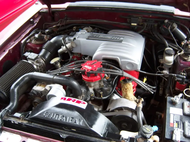

  • Jul 8, 2010
  • #11
I'm going 13.0@104.5 on slicks with your basic GT40, e303, explorer combo. About 2000 bucks into the motor and all the basic supporting mods.
Be careful with that paint! That' s nice mph for a 13.0 and a basic combo. Nice work.
