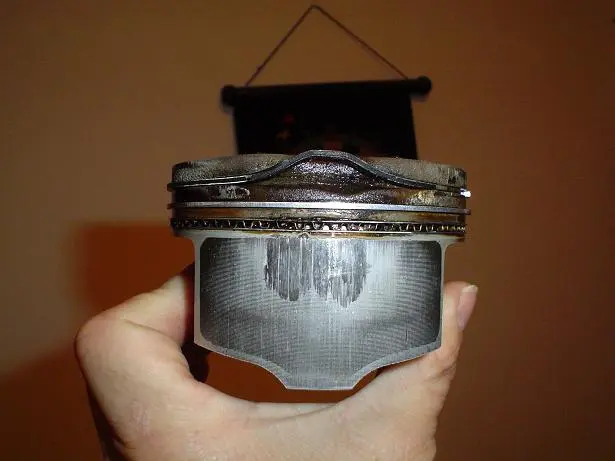

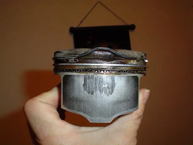

You need to get your car to a dyno and have your A/F ratio checked ASAP! Every time you hear that "pinging", you're possibly eating away at the piston lands... keep it up and you'll be replacing the motor real soon. See photo below...

Thats a very horrific picture!!!! enough to make me worry what mine look like!!! I have only had the car for a week and a half, and definitely do not have any intentions of running it, except to the dyno shop now.

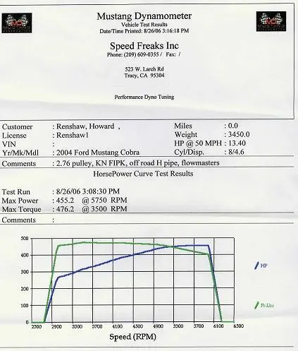

I only took home the chart with the HP and Torque curves (attached), another graph had all 3, the A/F was a solid 12.5 line up to let off around 6k rpm.

12.5 is borderline in my opinion. If running stock boost a 12.5 A/F is okay, but for a pullied Eaton most folks would rather have it a little more rich just to be on the safe side.
On a positive note you never told us these HP/TQ numbers were from a Mustang Dyno! That makes your numbers even more impressive since the Mustang dynometer normally reads 5-10% lower than the industry standard Dynojet. :nice:

Yes, did forget to mention that. I originally bolted on a Bassani x-pipe but it wouldnt seal, so had to resort to the H-pipe for the dyno run. Also have a new BBK throttle body I want to bolt on after I have the intake ported to match the tb. So when I get those 2 situated I will be taking it back.
So what kind of A/F # is preferred?

If I were you I'd save my money and not waste it on the BBK TB. You can make over 600+RWHP with the stock TB. It's not going to gain you anything by replacing the stock TB with the BBK unit. If you want to see more HP/TQ send your stock TB/Inlet/Eaton in and have all three ported. This will easily put you over 500RWHP & 500RWTQ. Keep in mind you'll need fuel upgrades (inectors/BAP/MAF) to support this.
As for A/F... Something a little below 12.0 would be safer, around 11.5 to 11.8.
