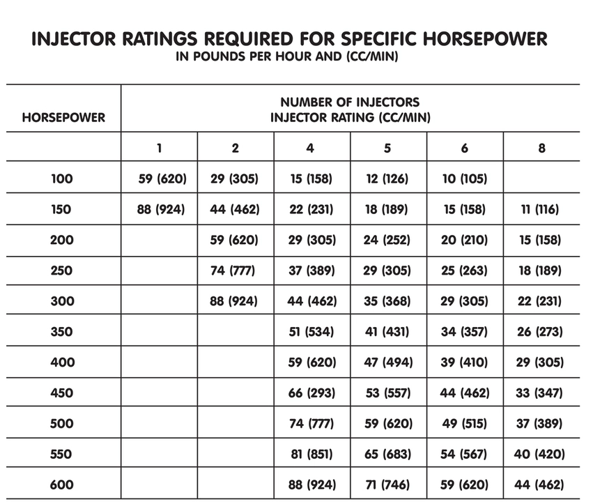

several people i've talked to think that the injectors are too small for either numbers. my cousin is a big lightning buff, and i was thinking about just grabbing a set of his 42lb injectors that he's got laying around, and the lightning 90mm maf. does that swap right in, correctly?
in doing that, would the car drive just fine swapping in the larger MAF which is calibrated for larger injectors? I think this is the first change i'm going to make to the car.

use this for injector size

If you have access to the tune settings in the ecu, then you can run the 90mm LMAF and 42's. Many folks have done this, and the LMAF is still one of the best meters available to us.
