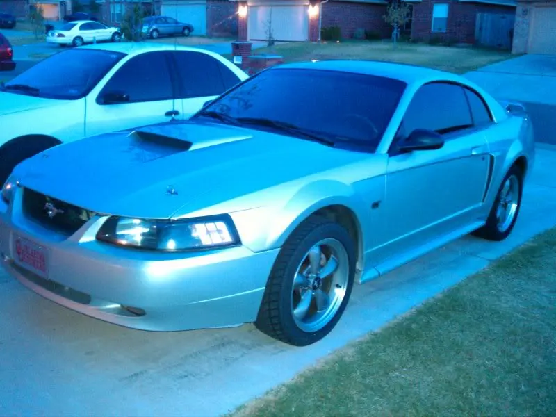

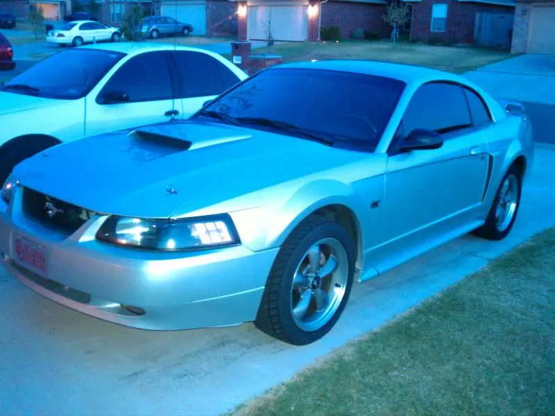

I just purchased a 2001 coupe GT. I was told that the previous owner put 3.73 gears in it, but it wasn't tuned so the speedometer is off by a couple mph. I was wondering if I would have to purchase a tuner, or if there is a place in Oklahoma City that I can go to have this fixed. Also, does this affect the mileage of my car at all, it seems like I am putting on more miles than I am actually driving.
Another issue I am having is the seat belt light is blinking as if I'm not wearing it. Is there a fuse or quick fix. If not, do I just need to replace a sensor? Thanks in advance guys.
