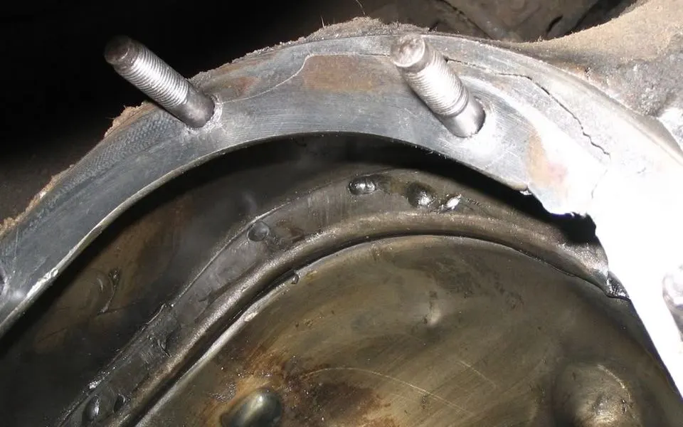

Sadly, I learned one other thing while I was under there: my differential housing is cracked. :shock: I took some pics, but they're at home. I'll post them up later. I noticed while I was working the diff off of the studs that one stud moved with the diff. On looking closer, I saw the crack, looks like it's been that way a while, has some grease/dirt encrusted around it. The crack starts between two of the studs, winds out above one stud beyond where the gasket lies, then curls back in and terminates at another stud.
So, I'm guessing that this is not repairable, and I will need to locate a new axle?

The crack is high, in the 1:00 position, so it shouldn't leak. I daubed some extra RTV sealant on it where the gasket doesn't cover it. I wore myself out trying to get the new diff in there by hand and had to give up for a couple days. My triceps are painfully sore... I tell my wife that wrenching is my workout plan!
Finally got around to getting the picture transferred:

It looks repairable to me. It would be much easier to do with the housing removed from the car. If you do it in the car, it is still possible, but there will probably be grit inside the housing after grinding the weld smooth and it will be a pain to get it completely clean.
