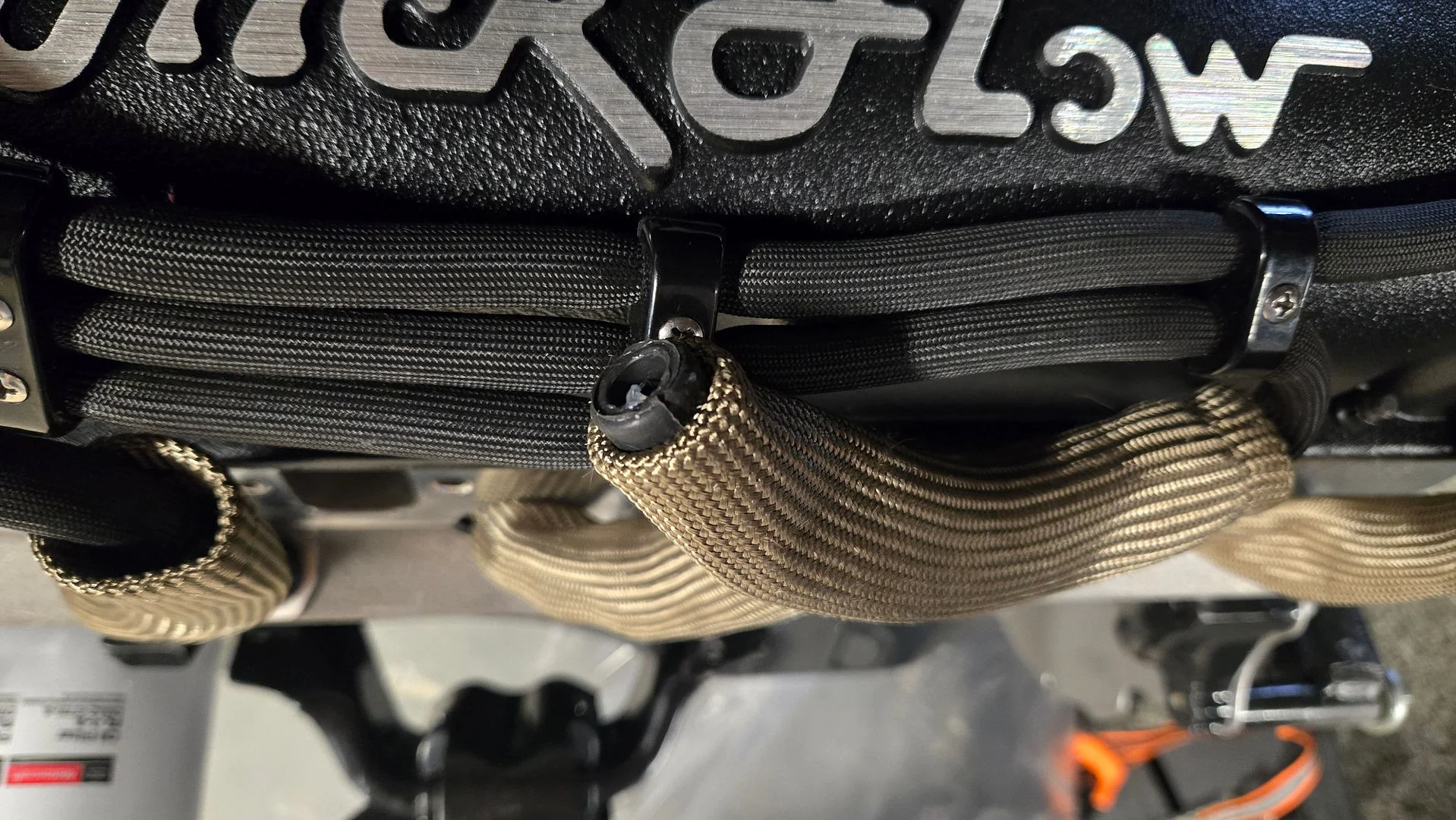

What are those plug boot covers and which wire holders did you use? I replaced my plug wires but it looks like a mess still, would be nice to clean it all up.
These are the wire looms I used. But if you Google spark plug wire looms you're find lots of cheaper options. This style has different sizes for different plug wire diameter.
https://www.summitracing.com/parts/tay-42700
The plug boots are https://www.summitracing.com/parts/DEI-010542
I like how they have a retiner ring sewn into the fabric. It's locks on the boot nice and snug. I've had some that were just a tube and all loose.

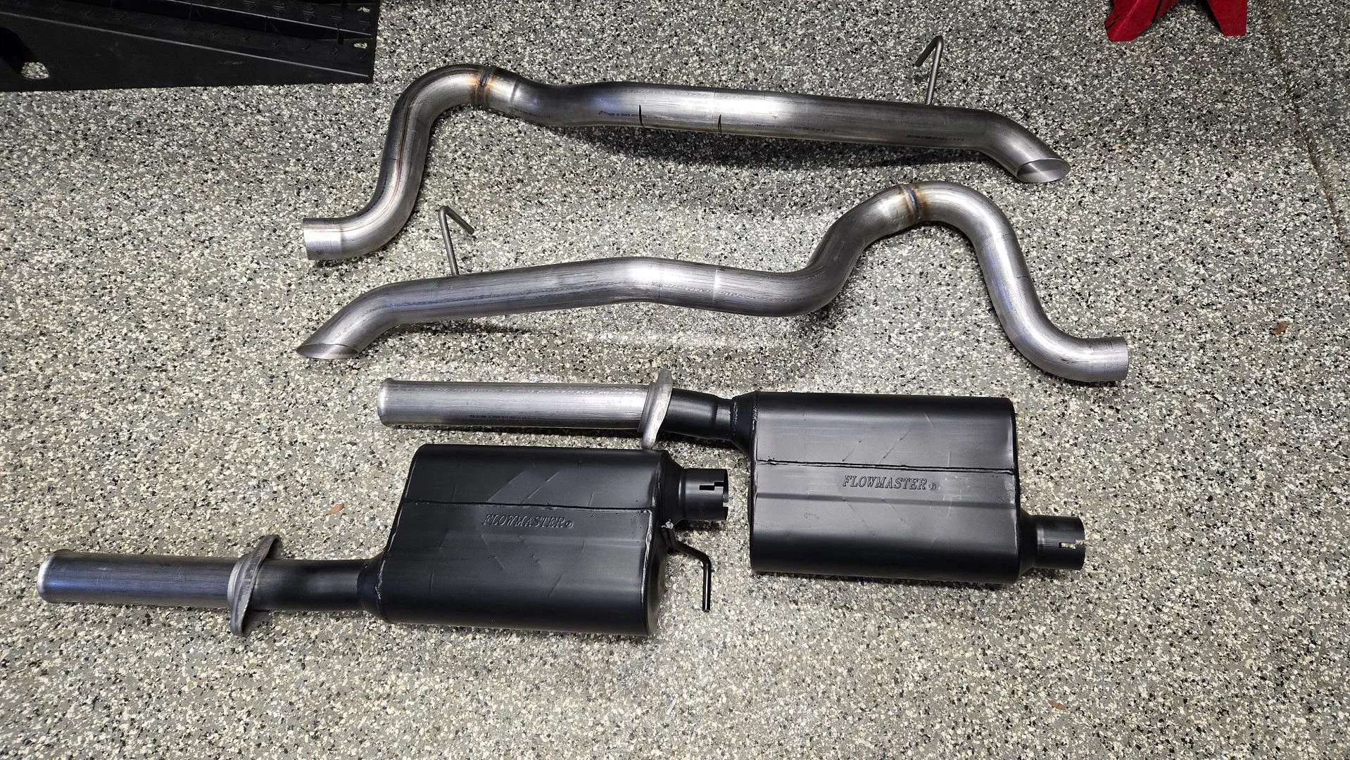

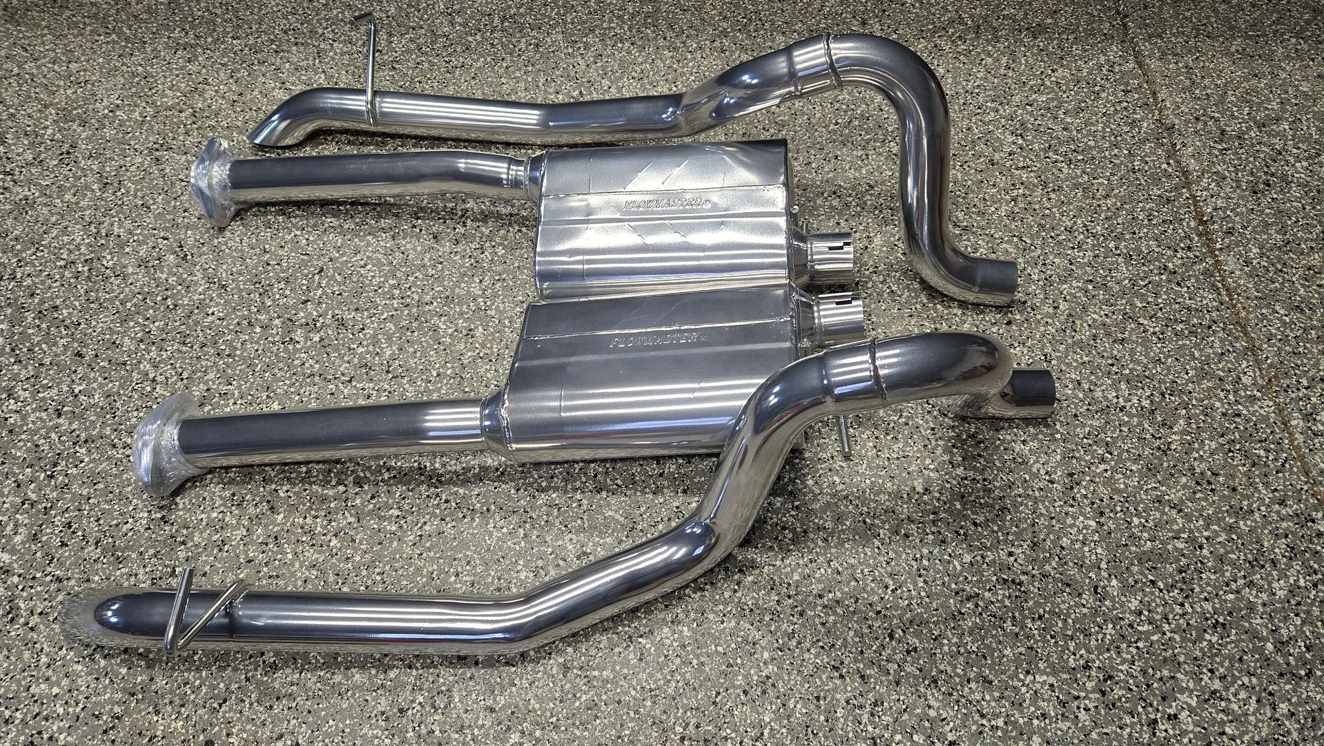

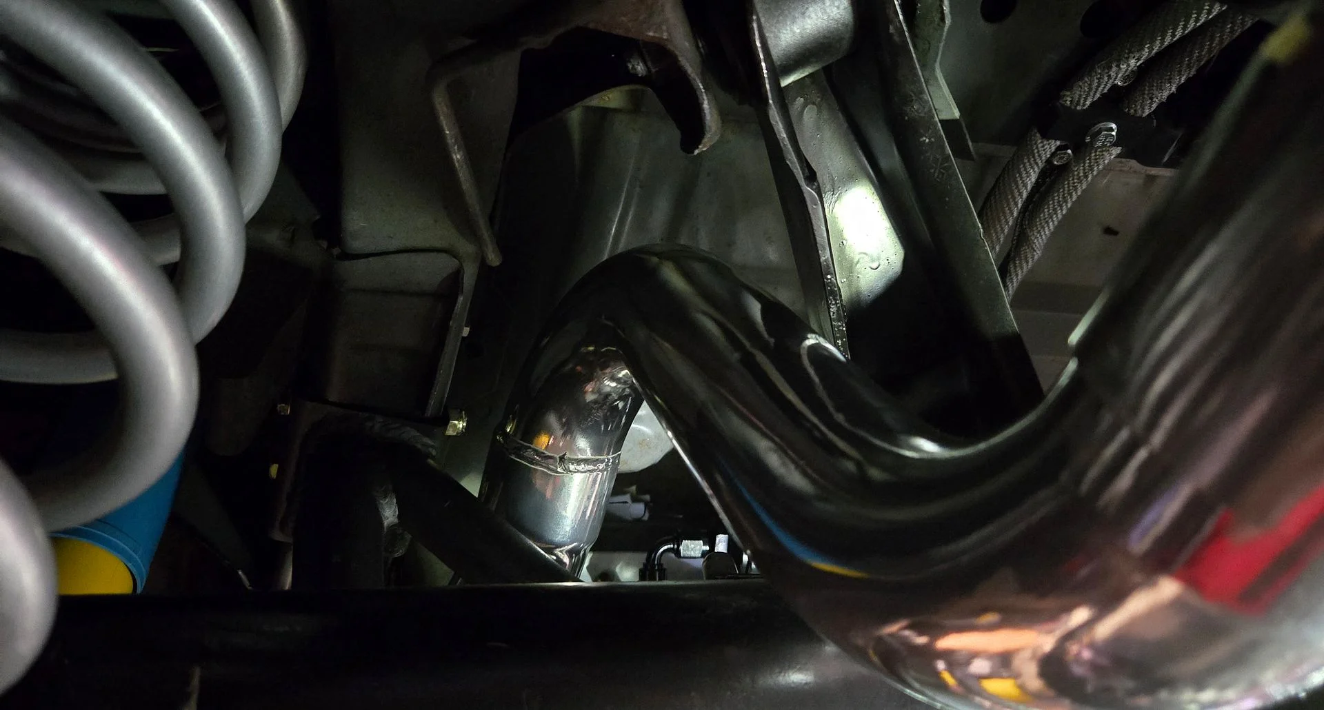

The exhaust came back from Jet Hot. Ceramic coated inside and out. I need to get that hanging under the car rather than taking up garage space. Before I shipped it out I did a test fit and trimmed the tailpipes how I wanted them.
Before:
After:

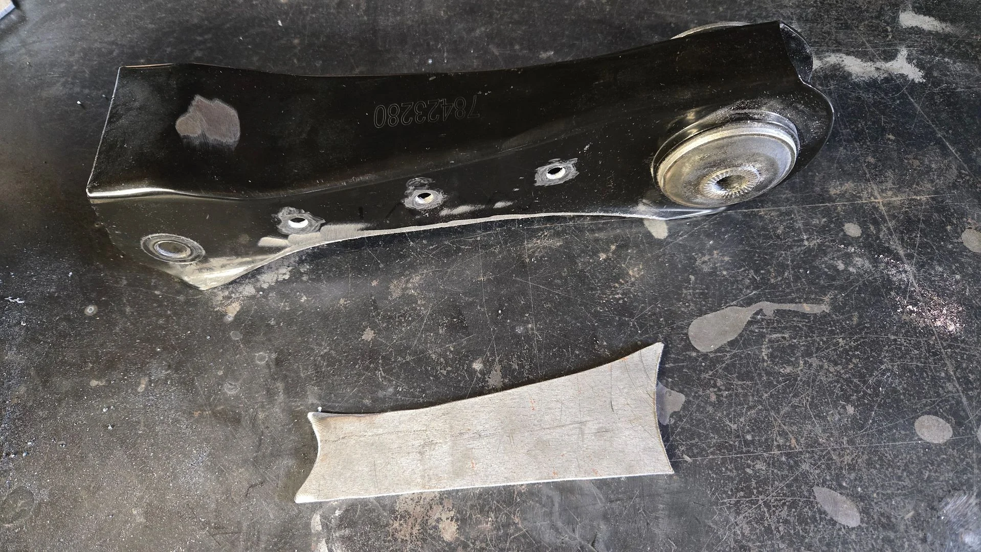

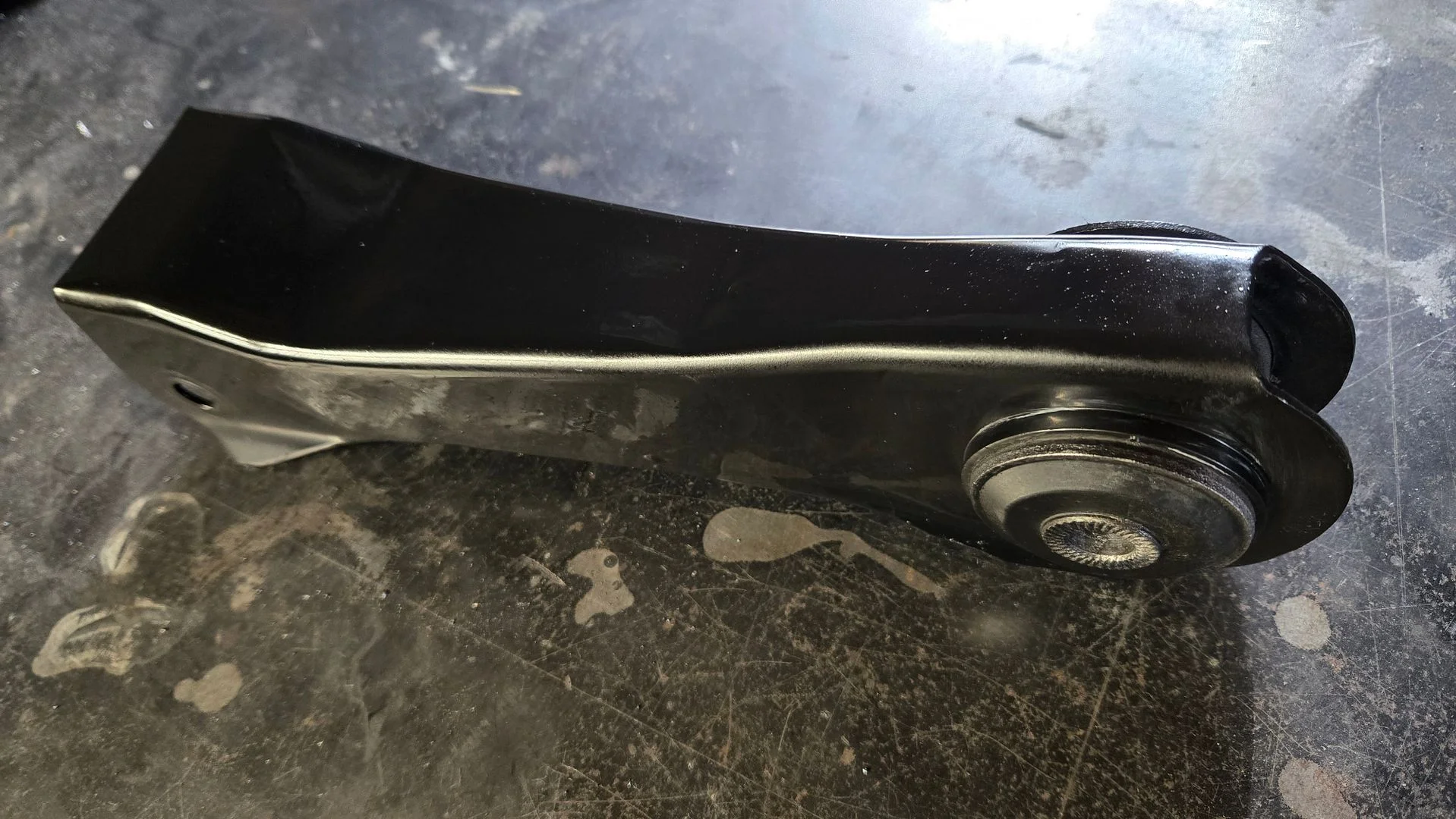

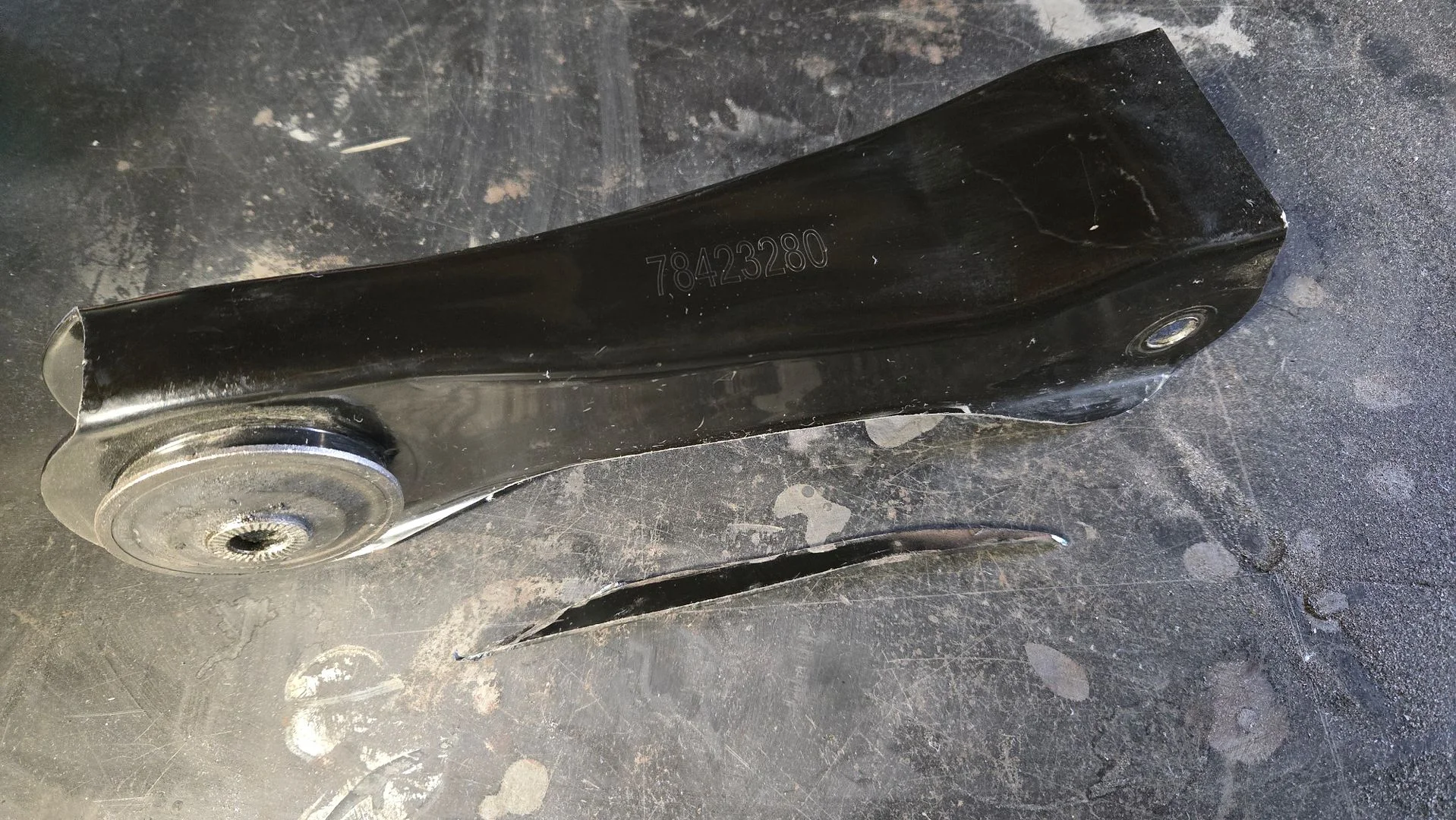

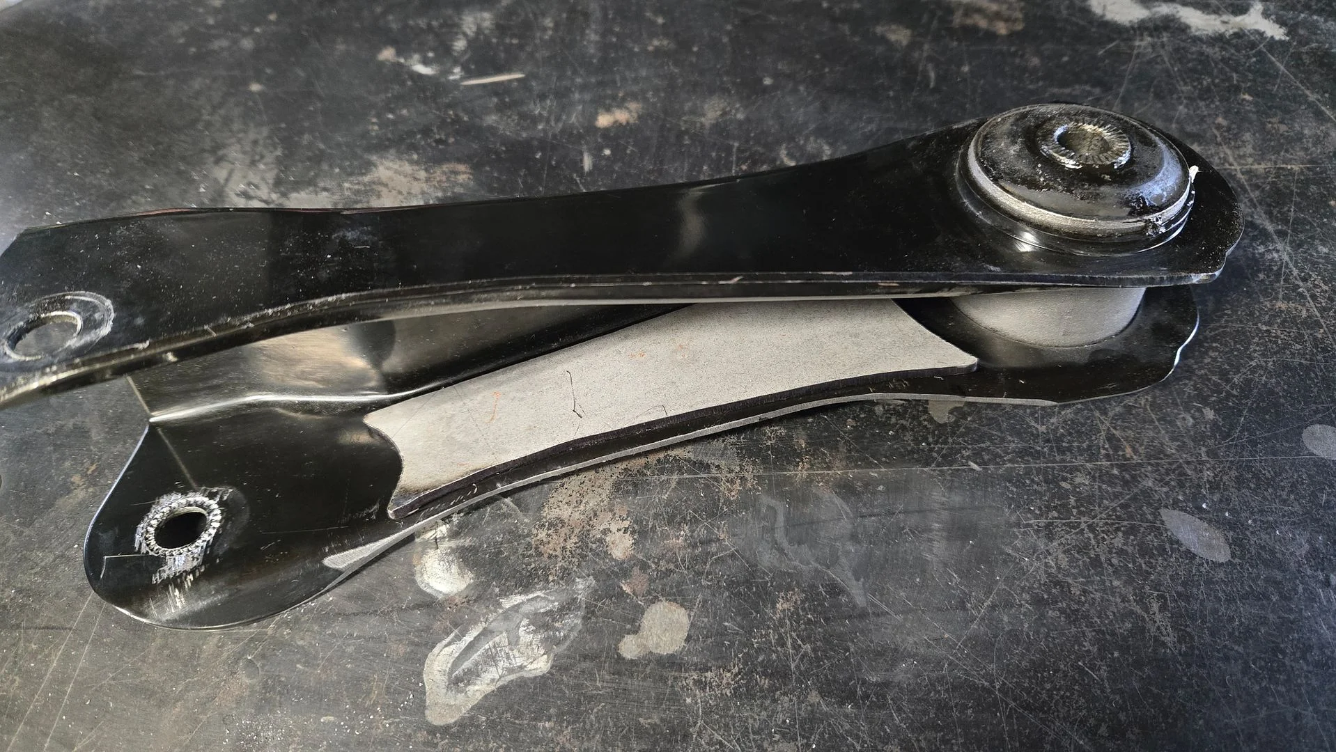

During the test fit I noticed the panhard bar chassis mount bolts are close to the exhaust hump where it goes over the axle. This is a tight area where the exhaust goes between the inside of the frame rail and the upper control arms. The panhard bolts make this area tighter. So I set out to make a little more room for adjustmemts.

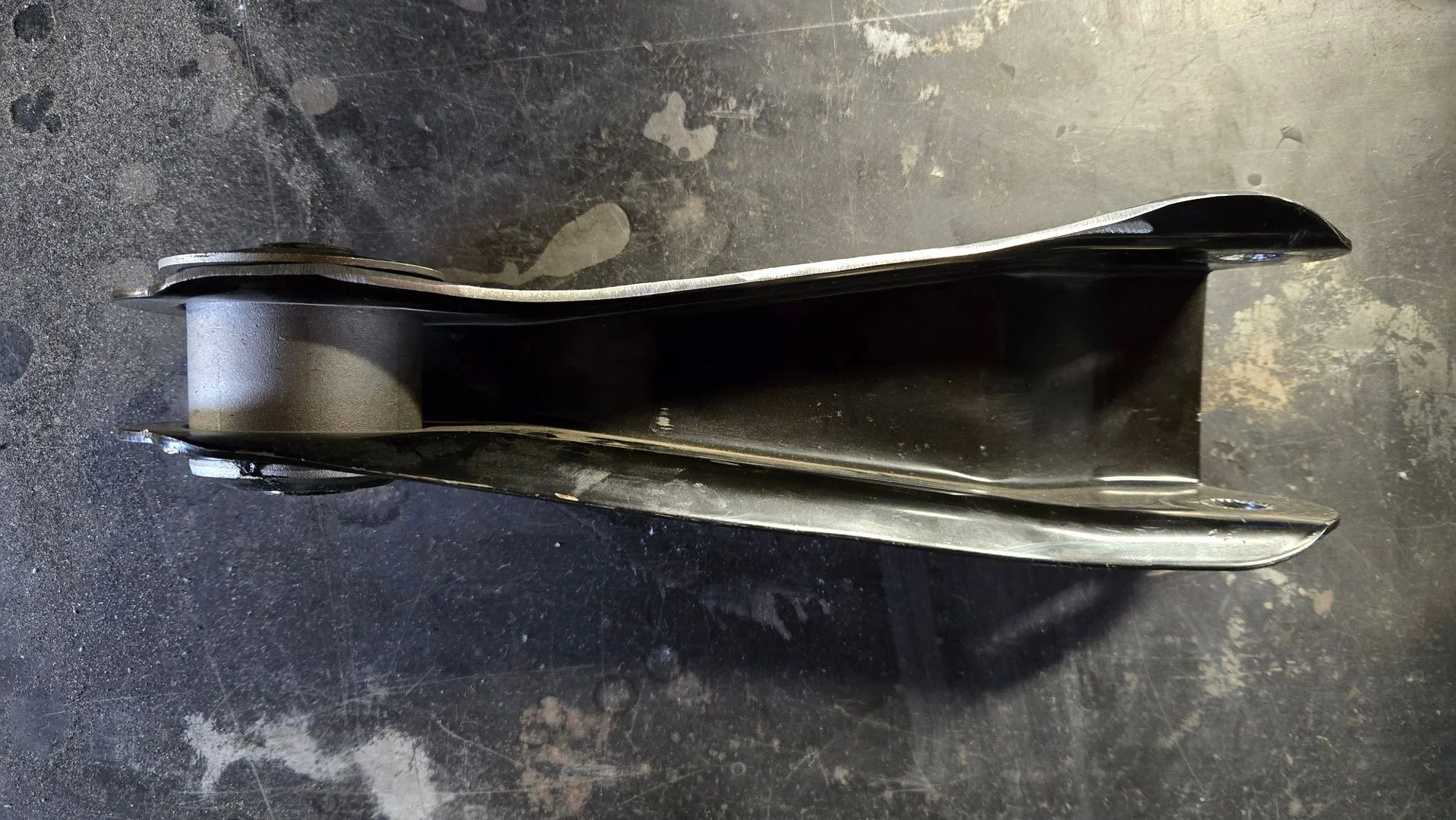

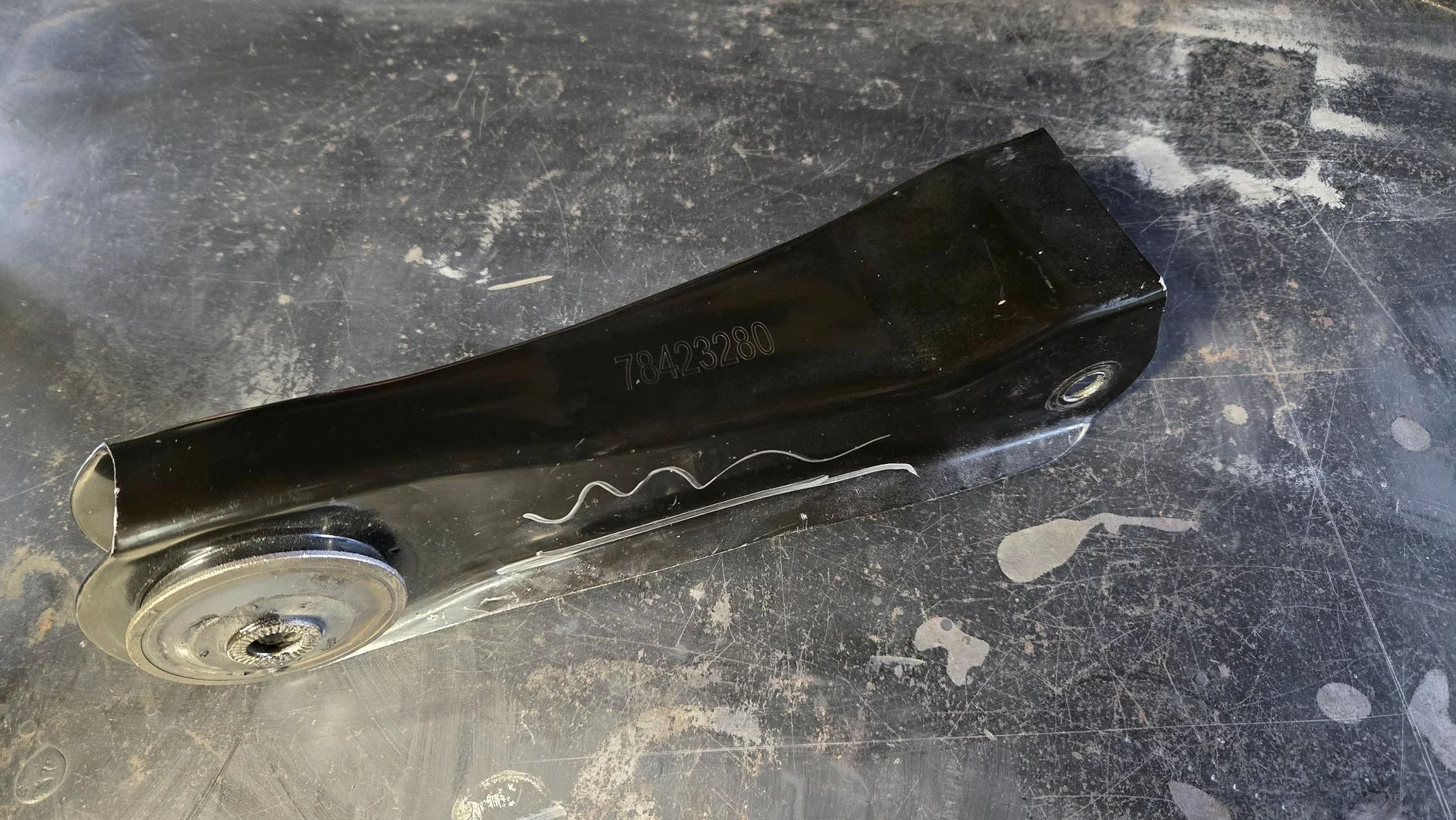

I'm running MM lower control arms and the uppers they suggest for that setup. The inside lip on the uppers is close to the exhaust and rattles drive me nuts. So I can make this better. One reason it's so close is the exhaust fits best around the panhard bar when it's pushed rearward as much as possible. The more rearward you bring the exhaust the closer it gets to the upper control arm.
This area can go
I'll gain this much clearance which will really help.
I didn't want to box them as some flex is suggested. I just want to support it a little after cutting of the flanged area. So I made some plates to weld inside.
Three plug welds and a bead along the edge should be plenty. Maybe a little stiffer than before, but not "fully boxed stiff" which is what I'm going for.
A little grinding and some paint and it looks like new again, just a slimmed down Ozempic version
Looks like this. The panhard bar nuts are visible left of the exhaust.

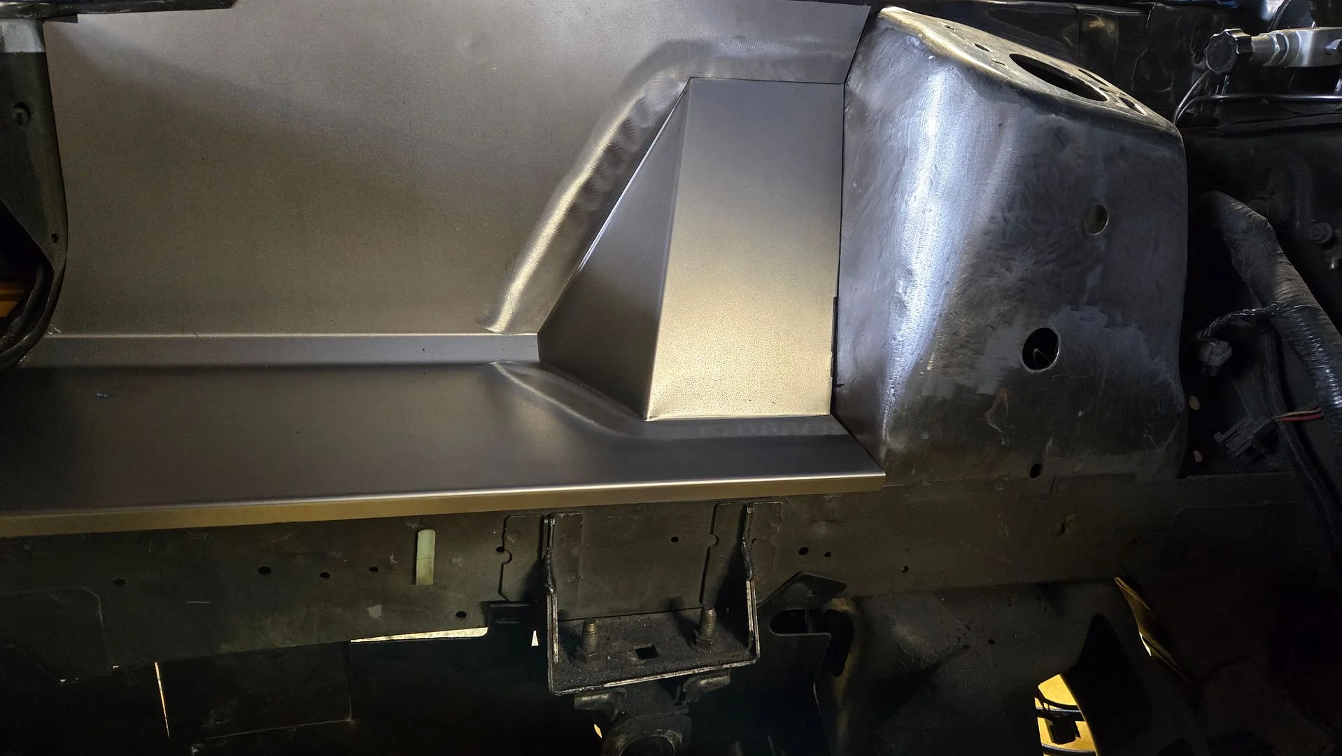

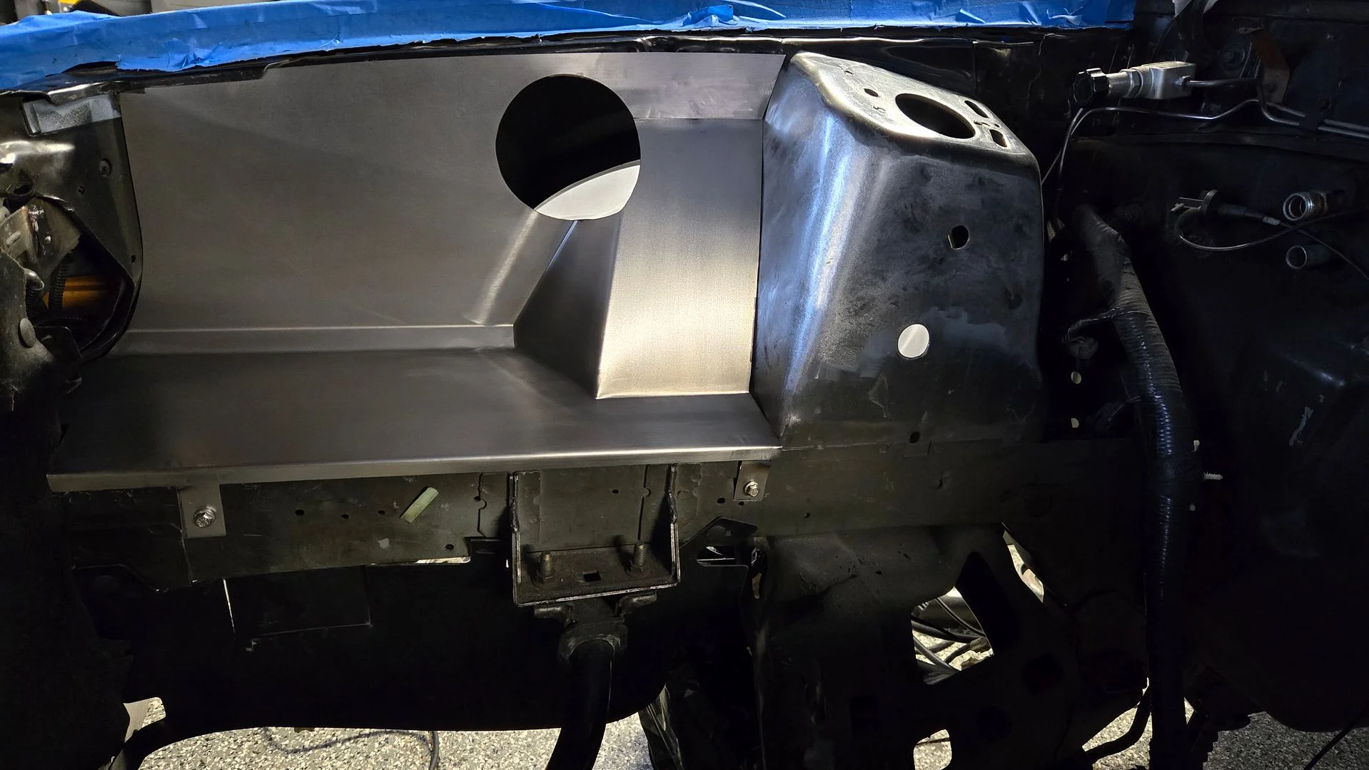

Today I started underhood on the passenger side. I rerouted the passenger side wiring behind the inner fender. Then set out to make this look a little better.
A little sanding
Then welding and grinding

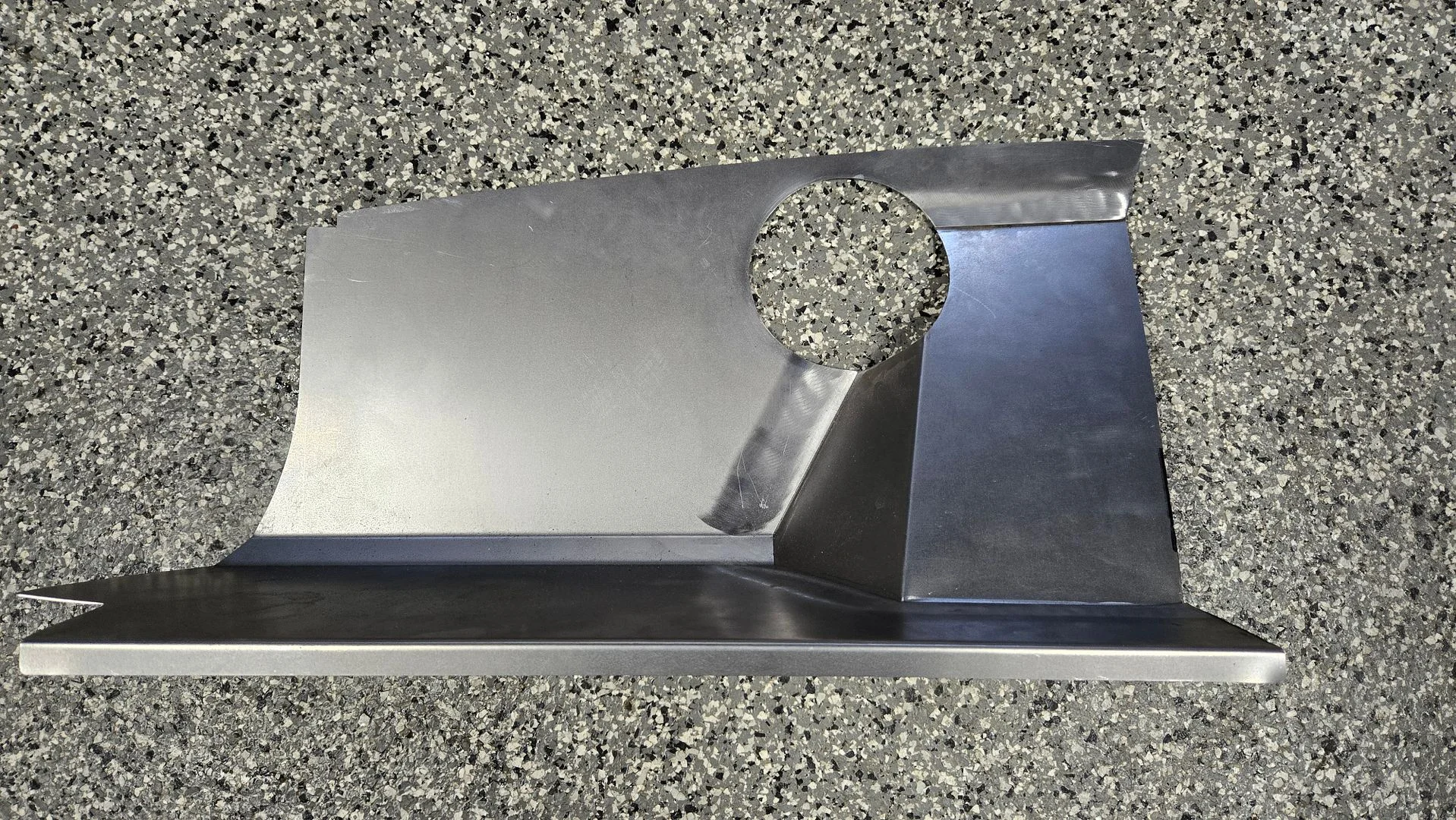

I'm using a panel from Scott Rod Fab. Needed a little trimming to make it fit.

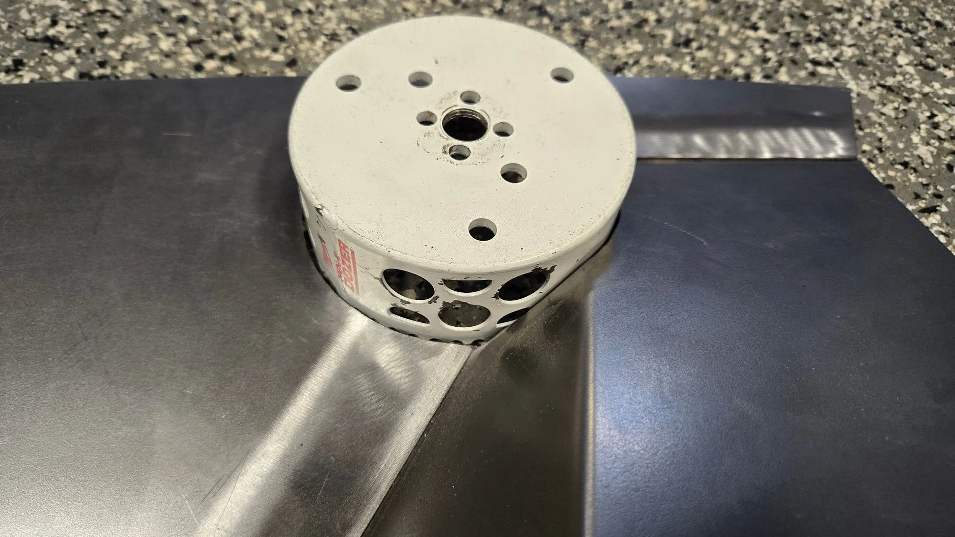

The I cut out a hole for my blower inlet with my angle grinder. You haven't lived until you cut a perfectly round hole through an origami shape like this.
My eyes kept playing tricks with me because it doesn't look round while you're cutting it because of the angles. I used hole saw as a round guide to keep me circular. Just kept taking off little by little with the grinder until I could slide the hole saw cleanly through the hole.
I'm using this as a trim panel. To mount it i welded a stud on the back side top right that gets a hidden nut from the wheel well side and then two tabs on the bottom. Drilled and tapped for ¼-20 screws.

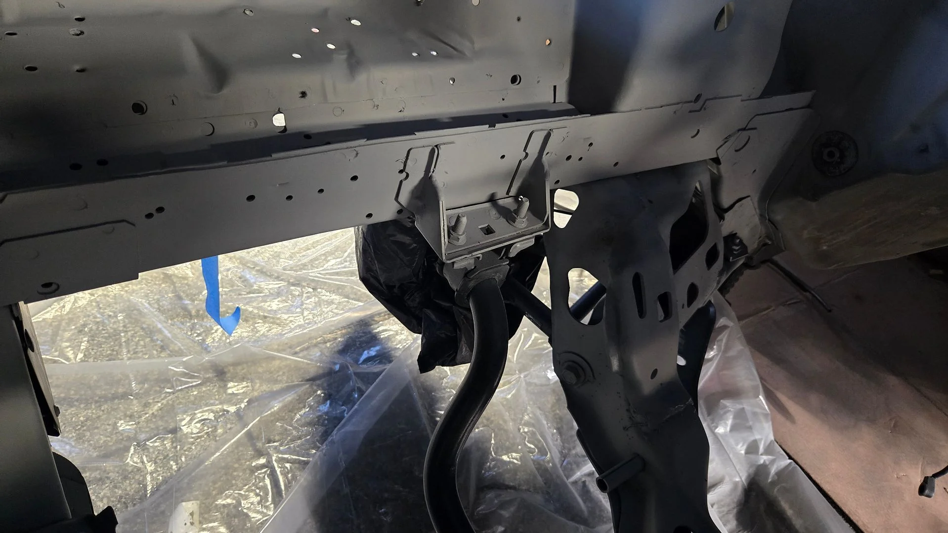

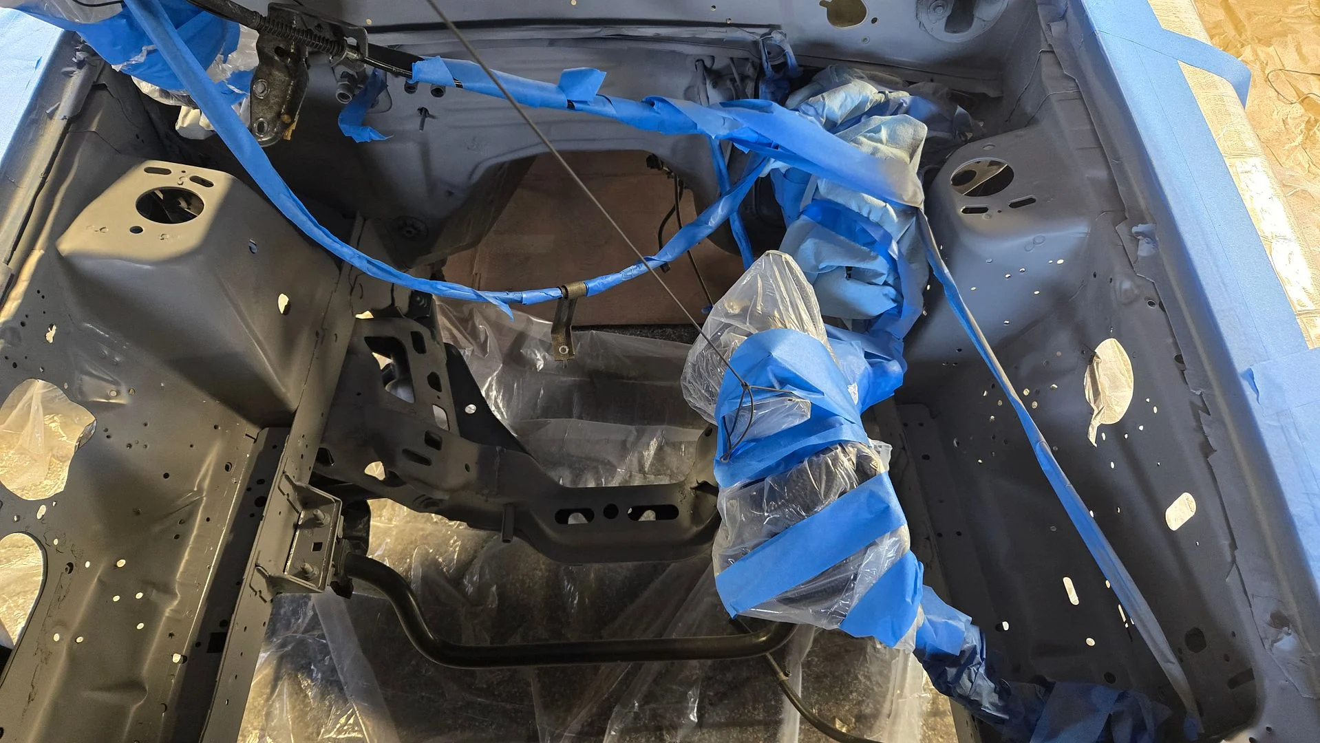

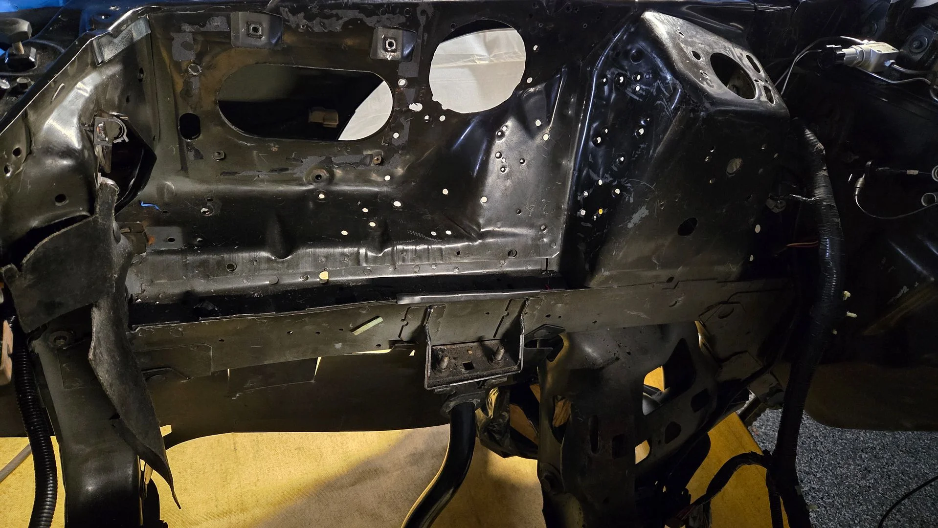

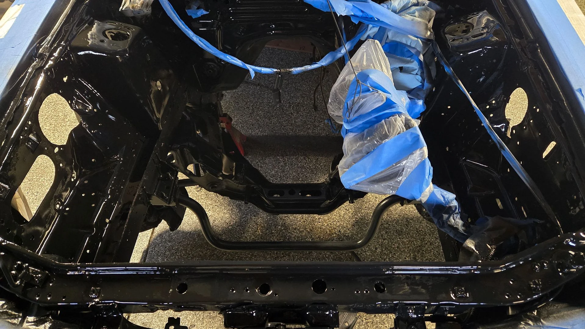

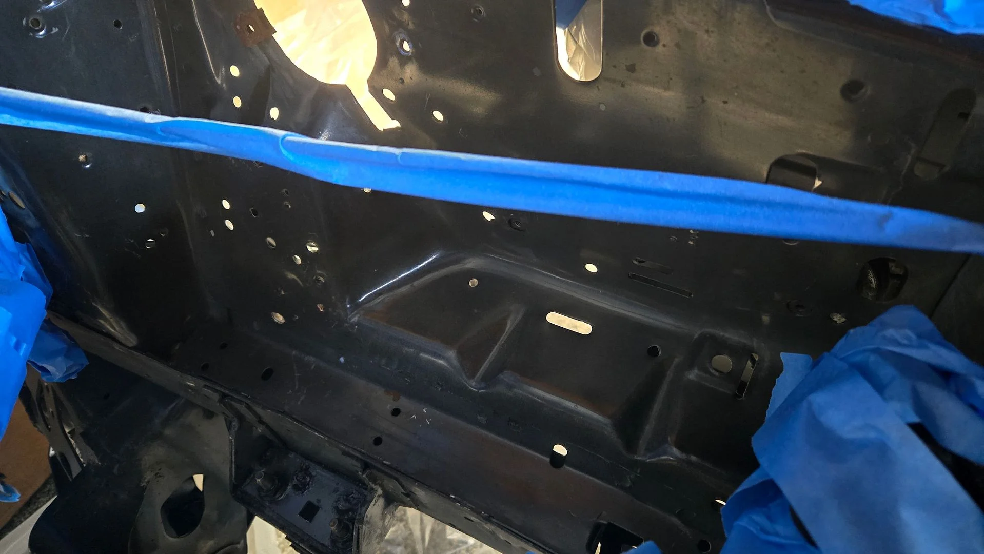

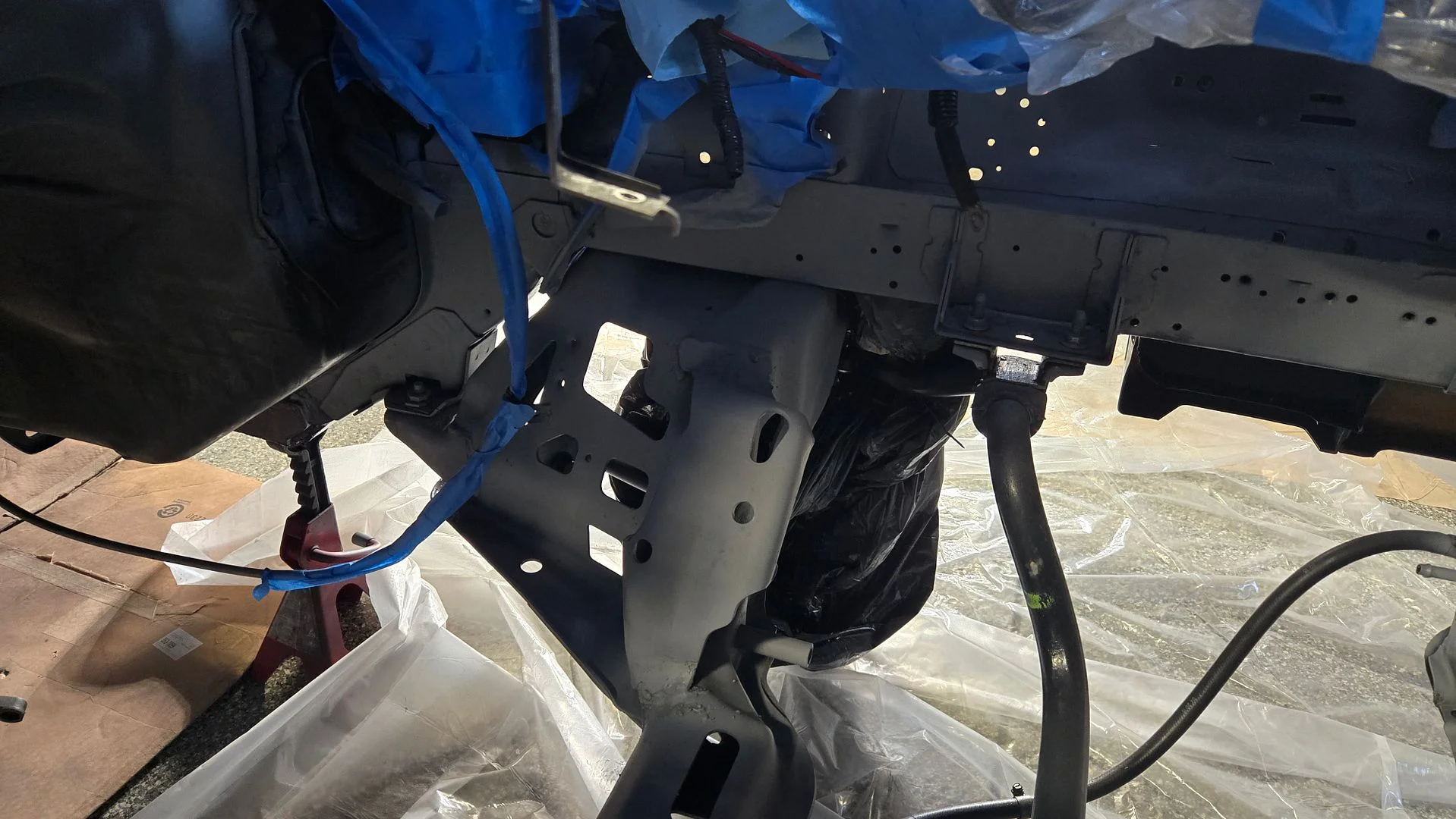

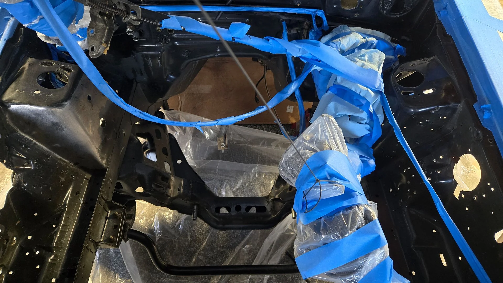

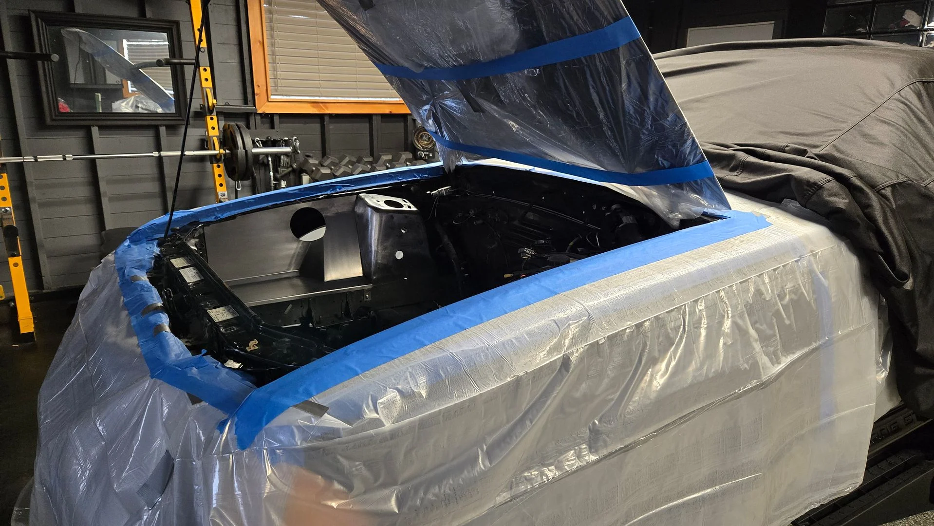

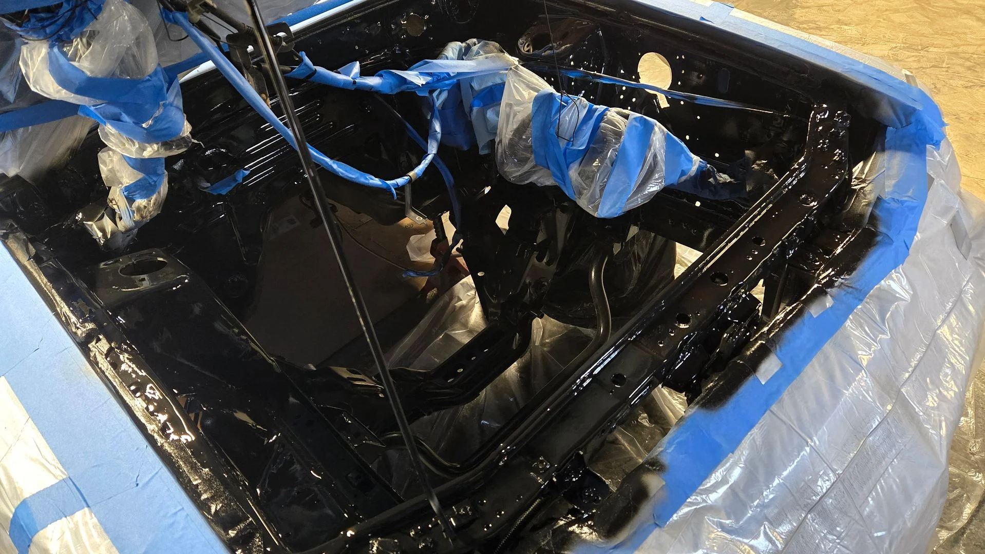

I worked on the engine bay a little today. Degreased everything and prepped. I moved all the wiring out of the way so I could coat everything good. Took lots of pictures so I can put it all back correctly.
This is the passenger frame rail that was under the battery box. So glad I'm not finding any rust.
Primed and ready for a topcoat.

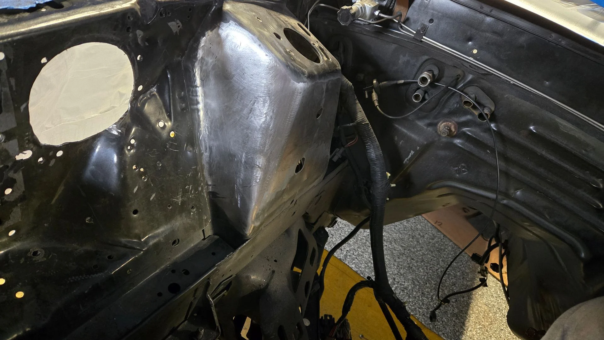

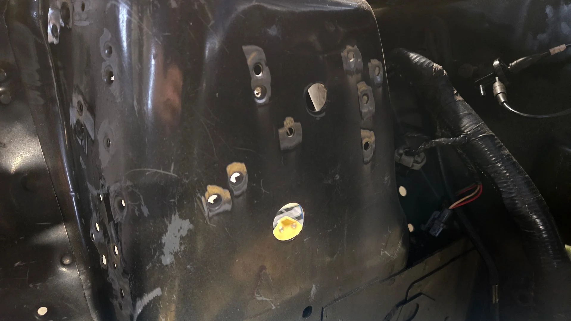

This is the backside of the strut tower i welded the holes up on
Then some black

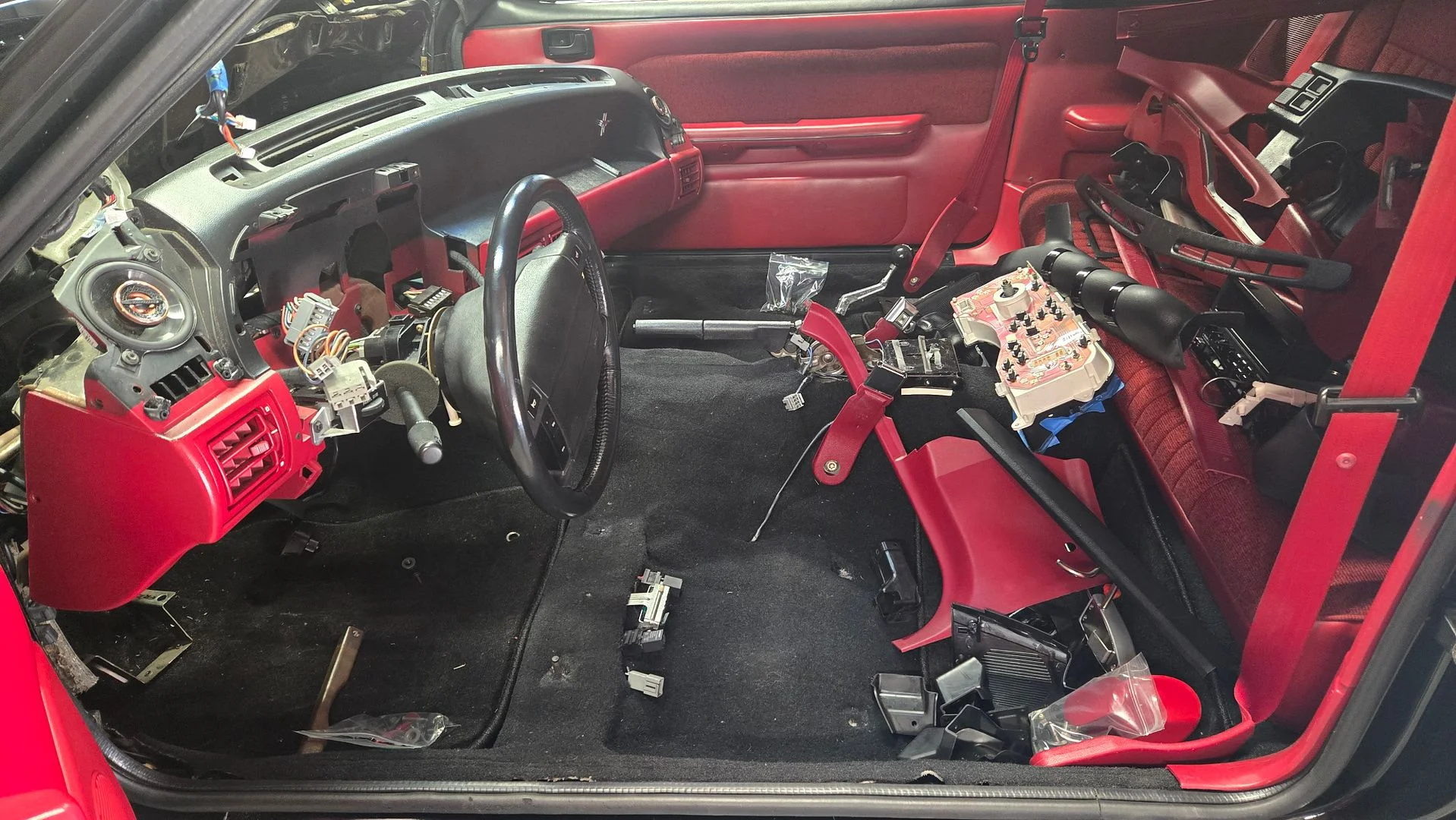

While the paint is drying under hood I'm moving on to everybody's favorite job. Gotta earn your stripes
If you know, you know
Got it

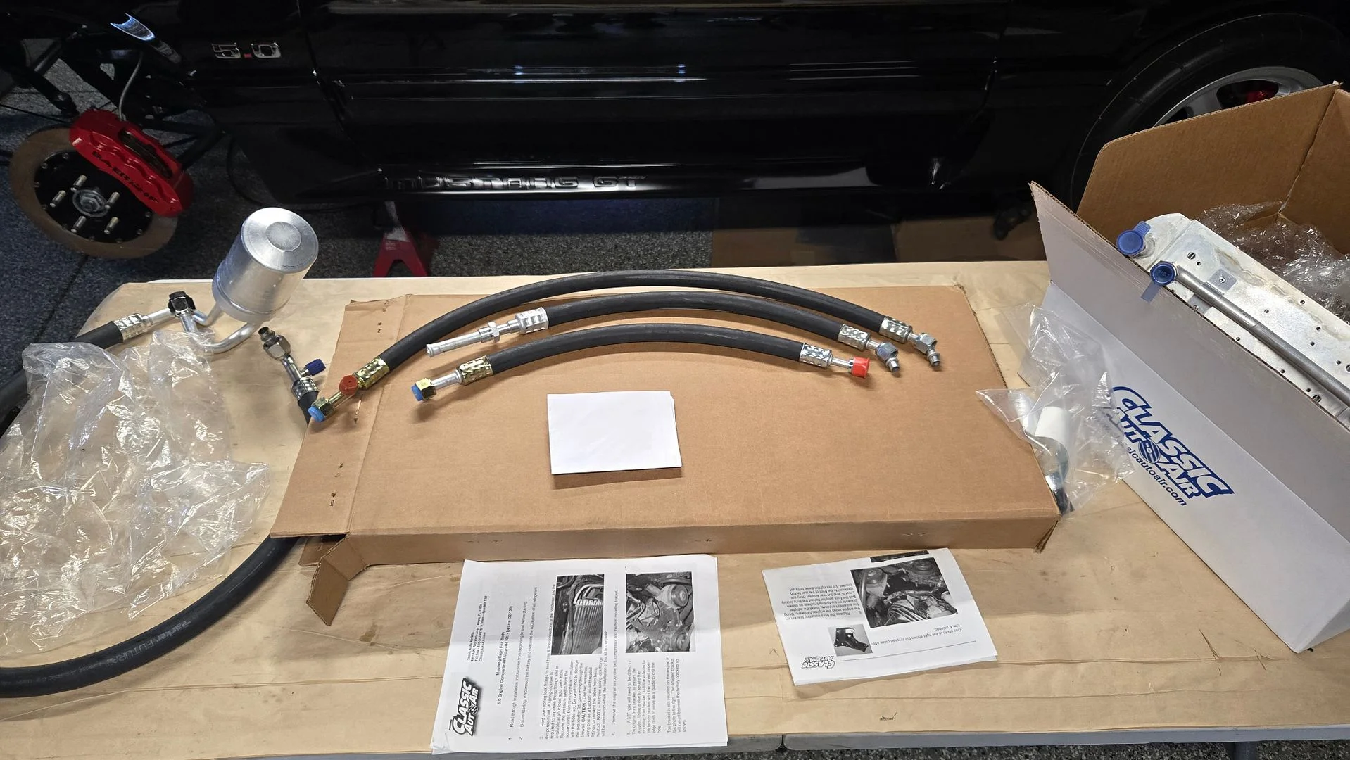

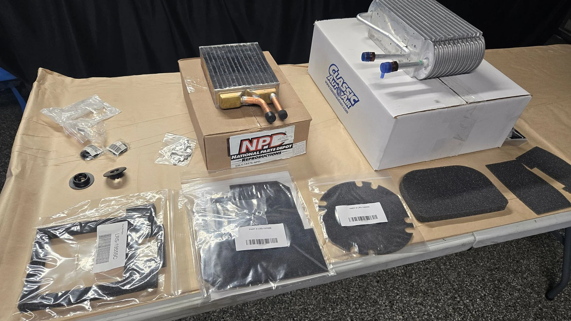

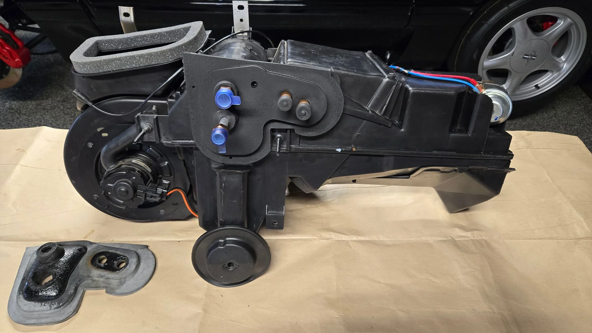

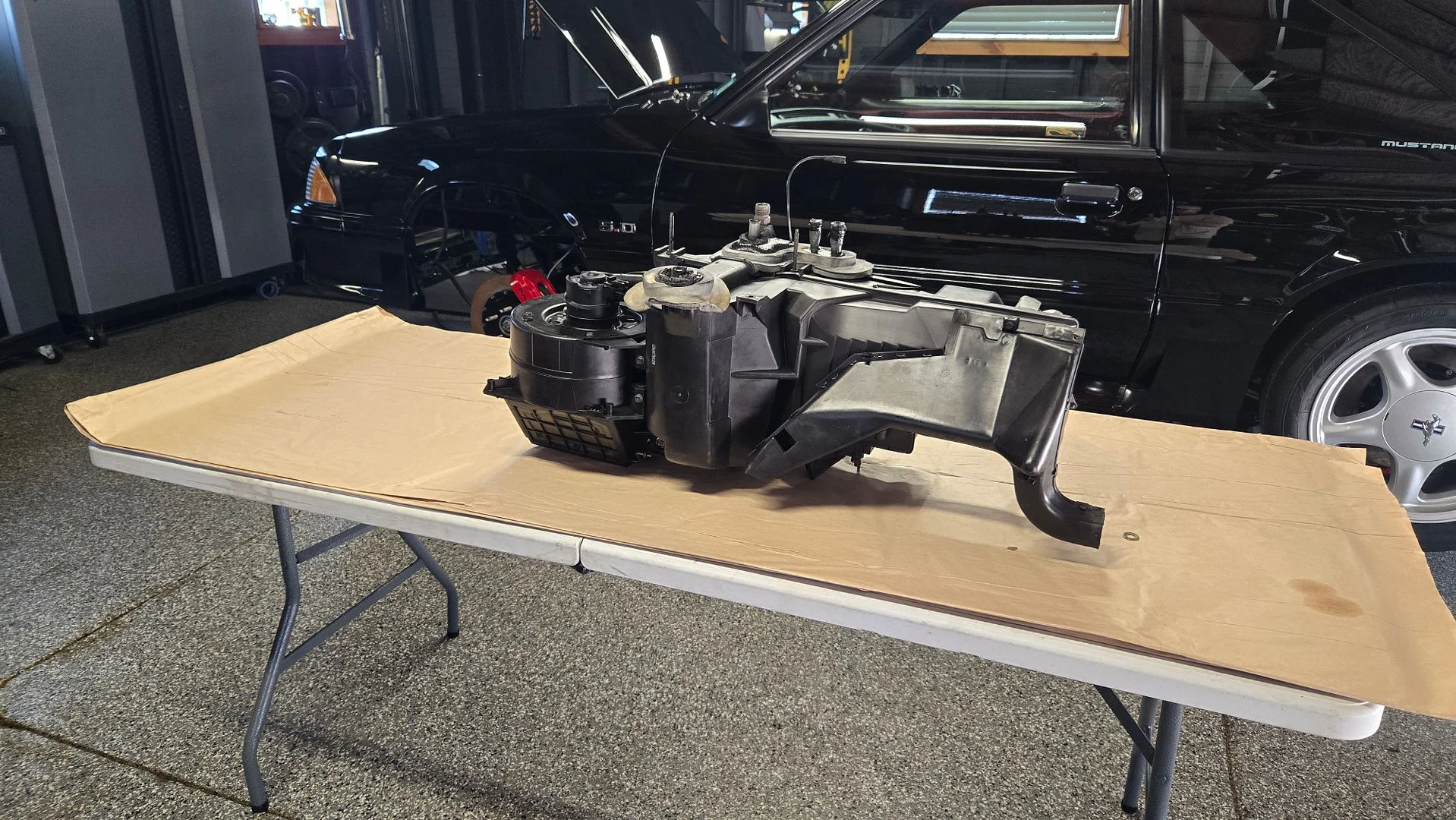

As I mentioned my evaporator core was leaking. I used the A/C kit from classic auto air. I like that all the lines do away with the spring retainer style hose ends. All the fitting are threaded with o-rings.
While I'm in there I'll replace the heater core as well. I found this copper / brass core from NPD. Gonna replace all the seals too.

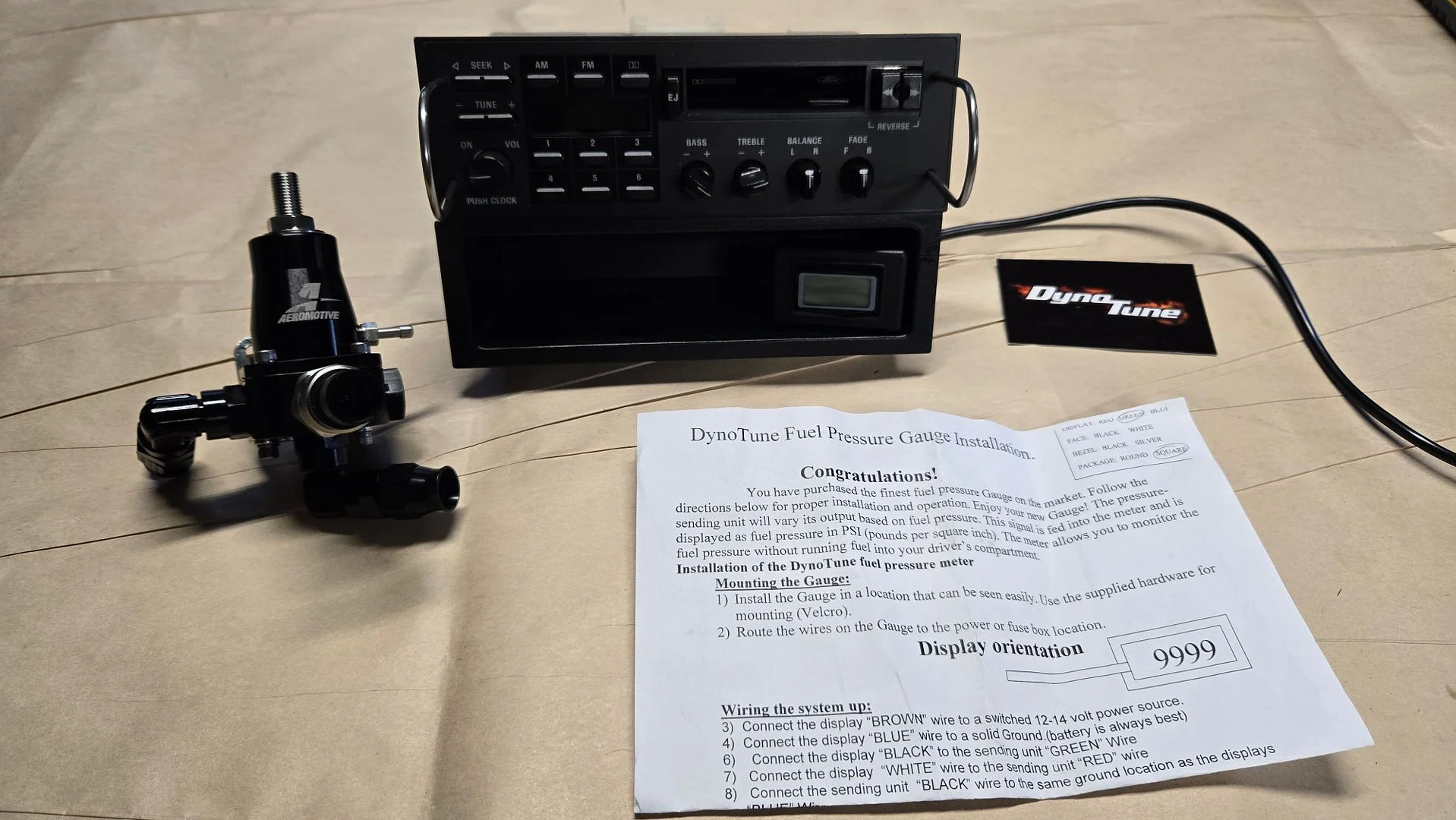

With the dash out it's a good time to run wires for guages. I'm going back to my 2 guage pod with an analog boost guage from Speedhut and the AFR from Zetronix which is the wideband setup and controller I need for my standalone engine management

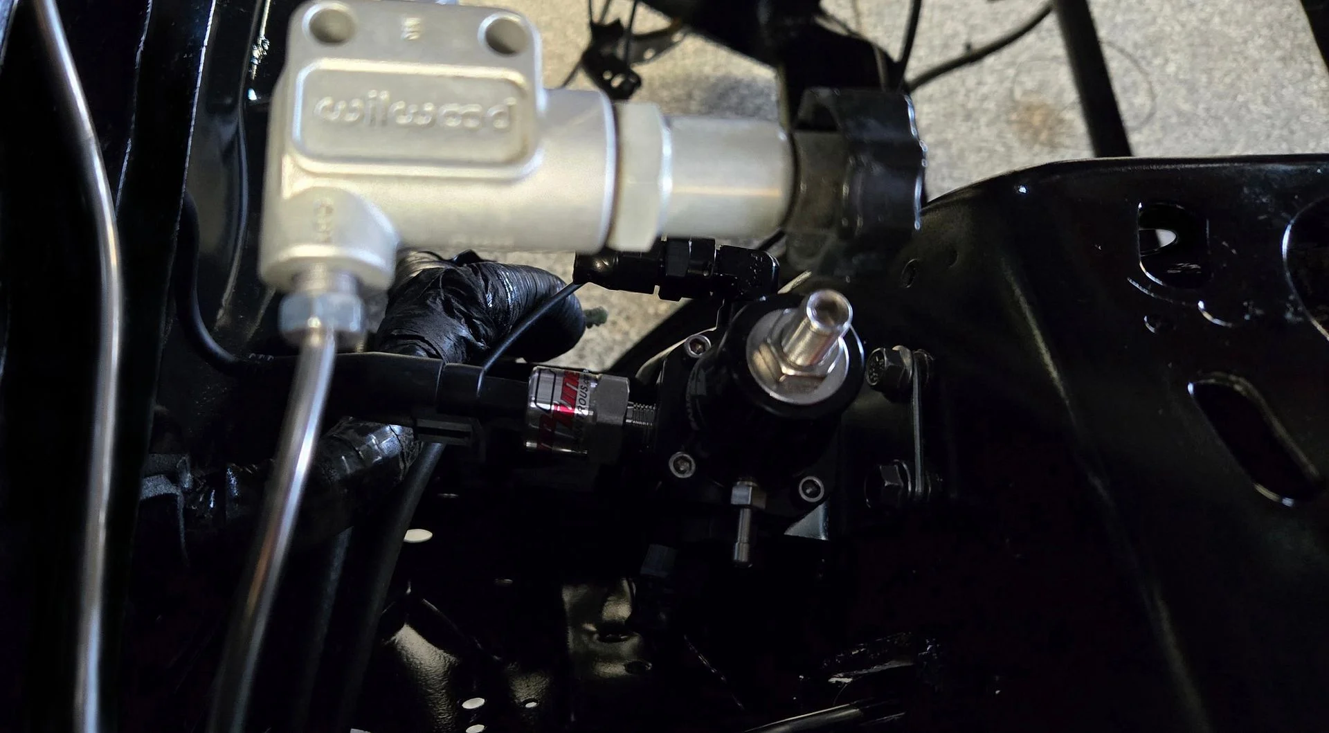

The fuel pressure guage is a small rectangular setup from Dynotune. They claim accuracy of 0.1 psi. It fits perfect in the cubby below my radio. I'll also be installing the Aeromotive FPR. The FP sender is mounted to the FPR.

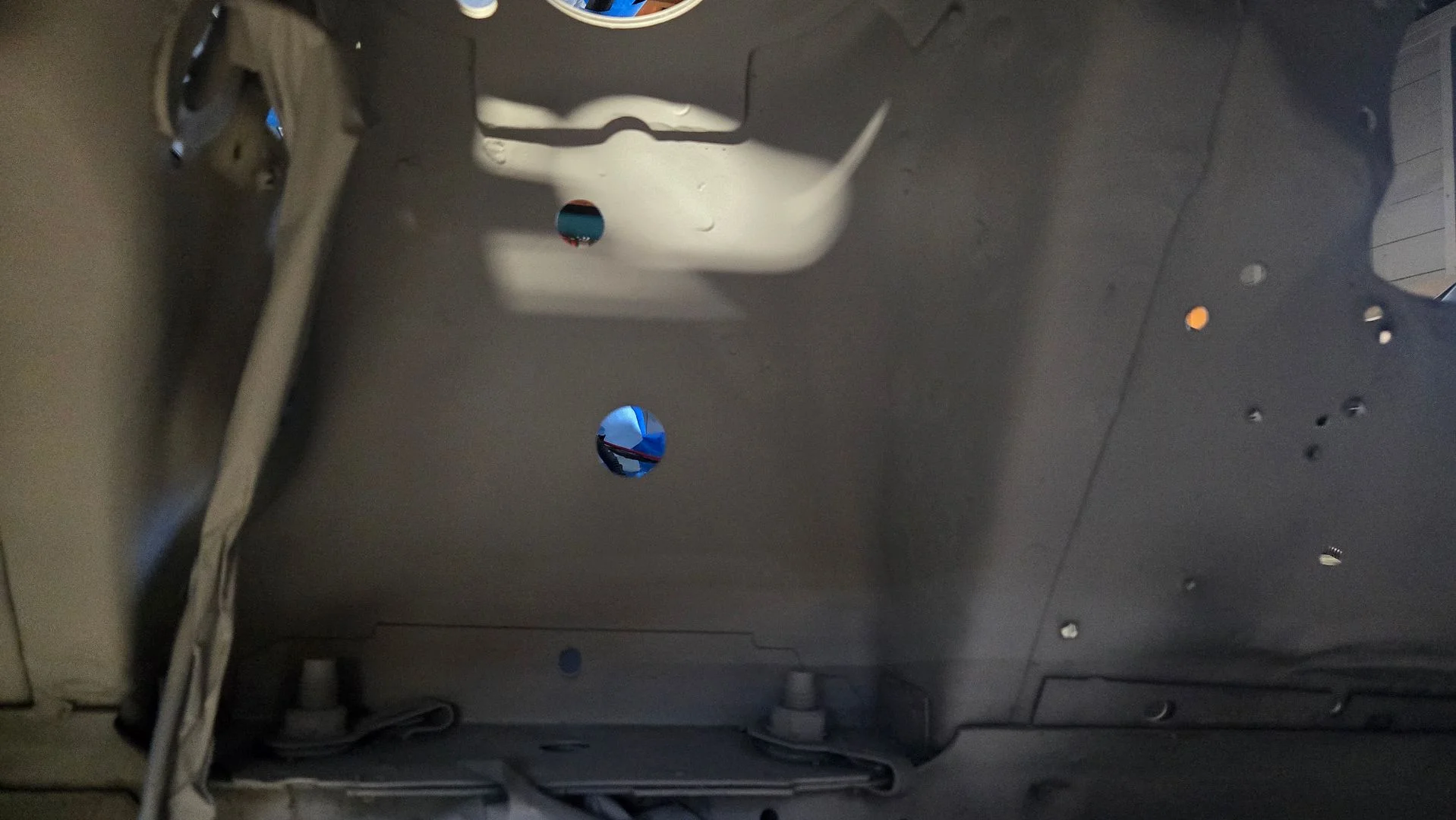

I'll be locating the FPR behind the strut tower where the EGR vacuum solenoid used to be. I put in some rivnuts and bolted it down. Then ran sender wires in through a grommet in the firewall
I also ran the wiring for the boost guage. I mounted up the pressure sender to the vacuum tree and re used my old firewall grommet.
With these out of the way I moved back to installing the plenum. Got some new firewall gaskets. The old one was shot
The plenum is in and the dash back together. Still have the console and seats out to finish up some wiring. Hopefully tomorrow I'll be able to get the widebands and controlled mounted and finish up the inside wiring.

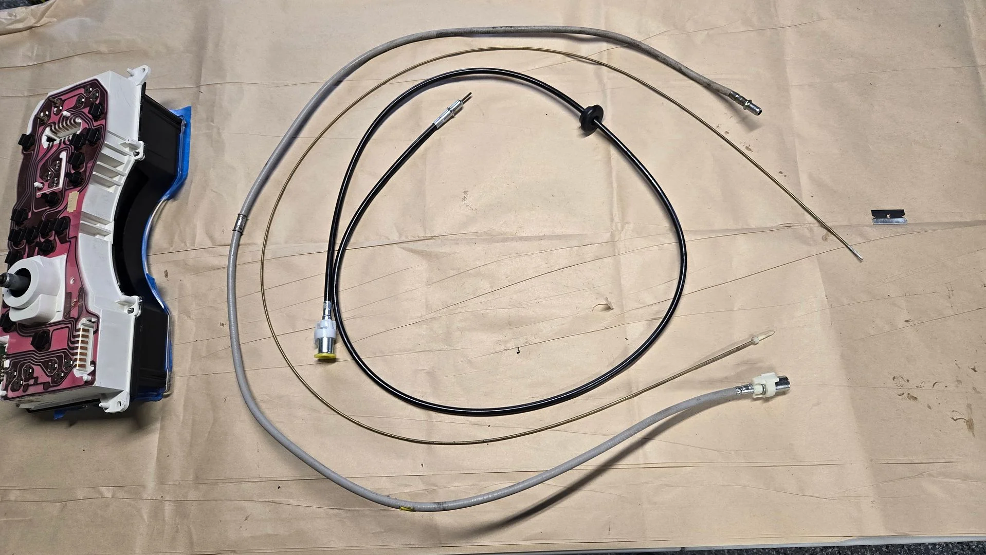

Also put in a new speedo cable while it's this far apart. I'm not sure if this is common knowledge, but the drive cable comes out of the speedo tube sheath. You pull it out from the cluster end. You can clean and lube it which sometimes fixes a bouncy speedo. Unfortunately I think my sheath is bad so I replaced it.
