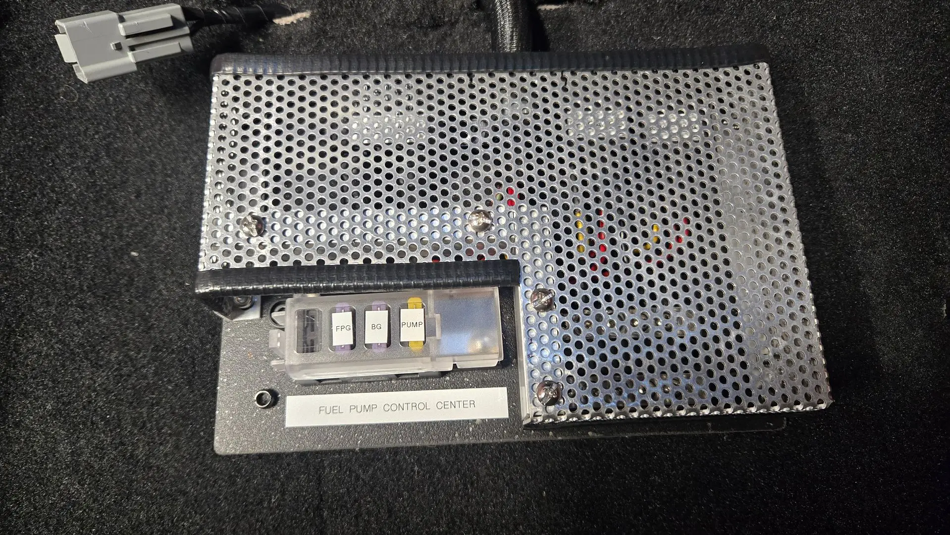

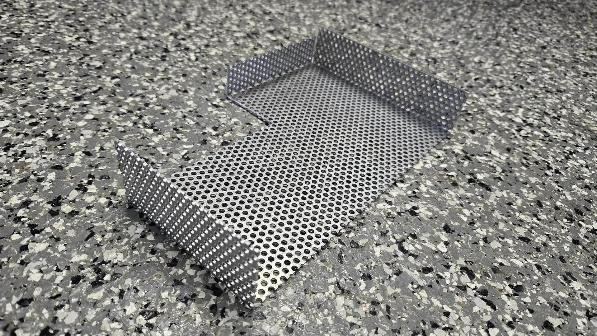

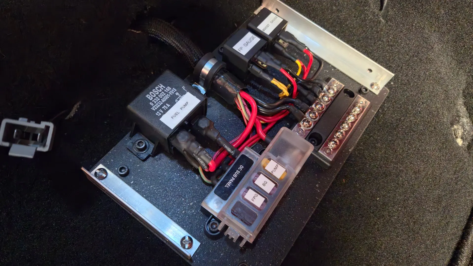

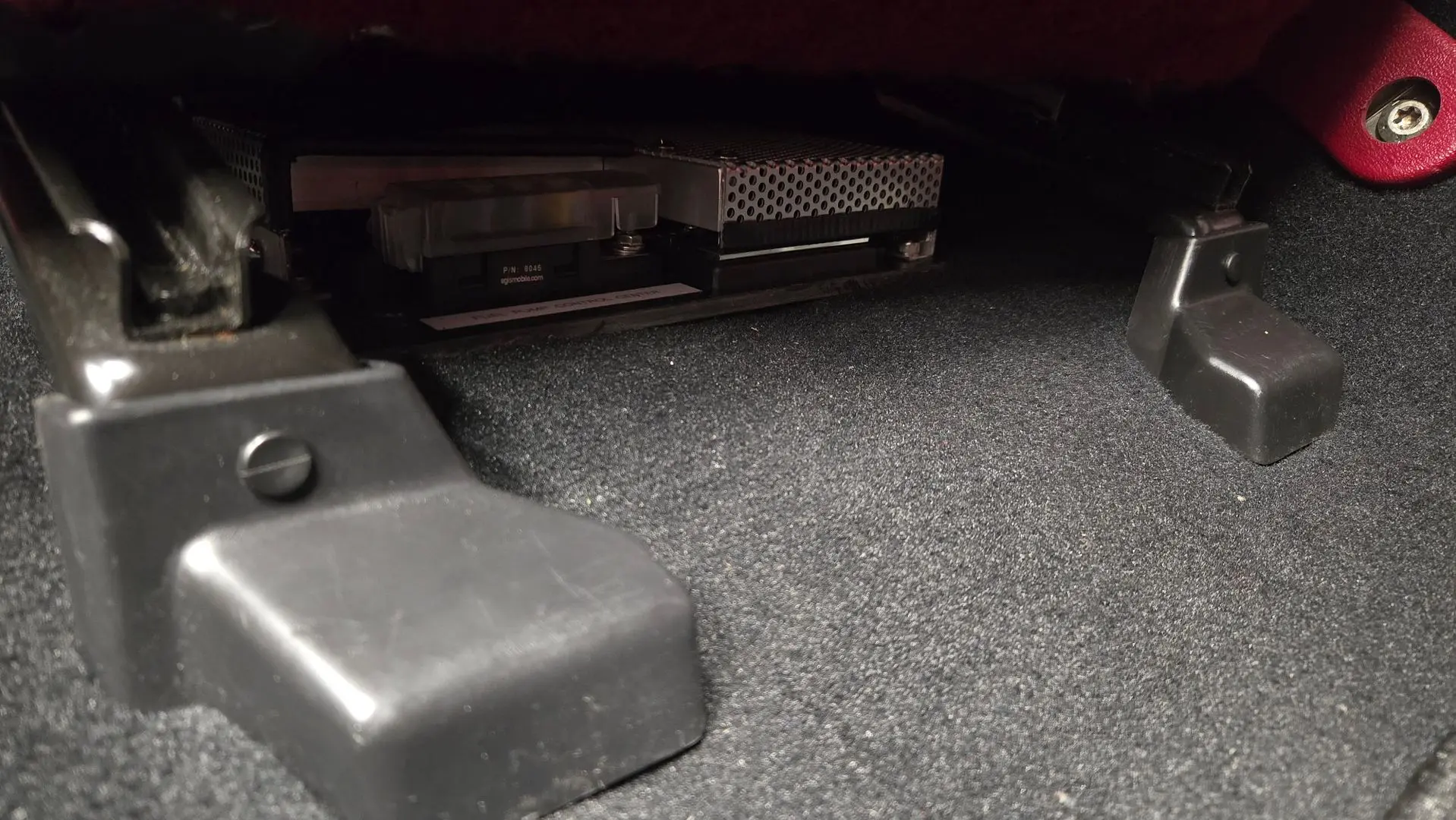

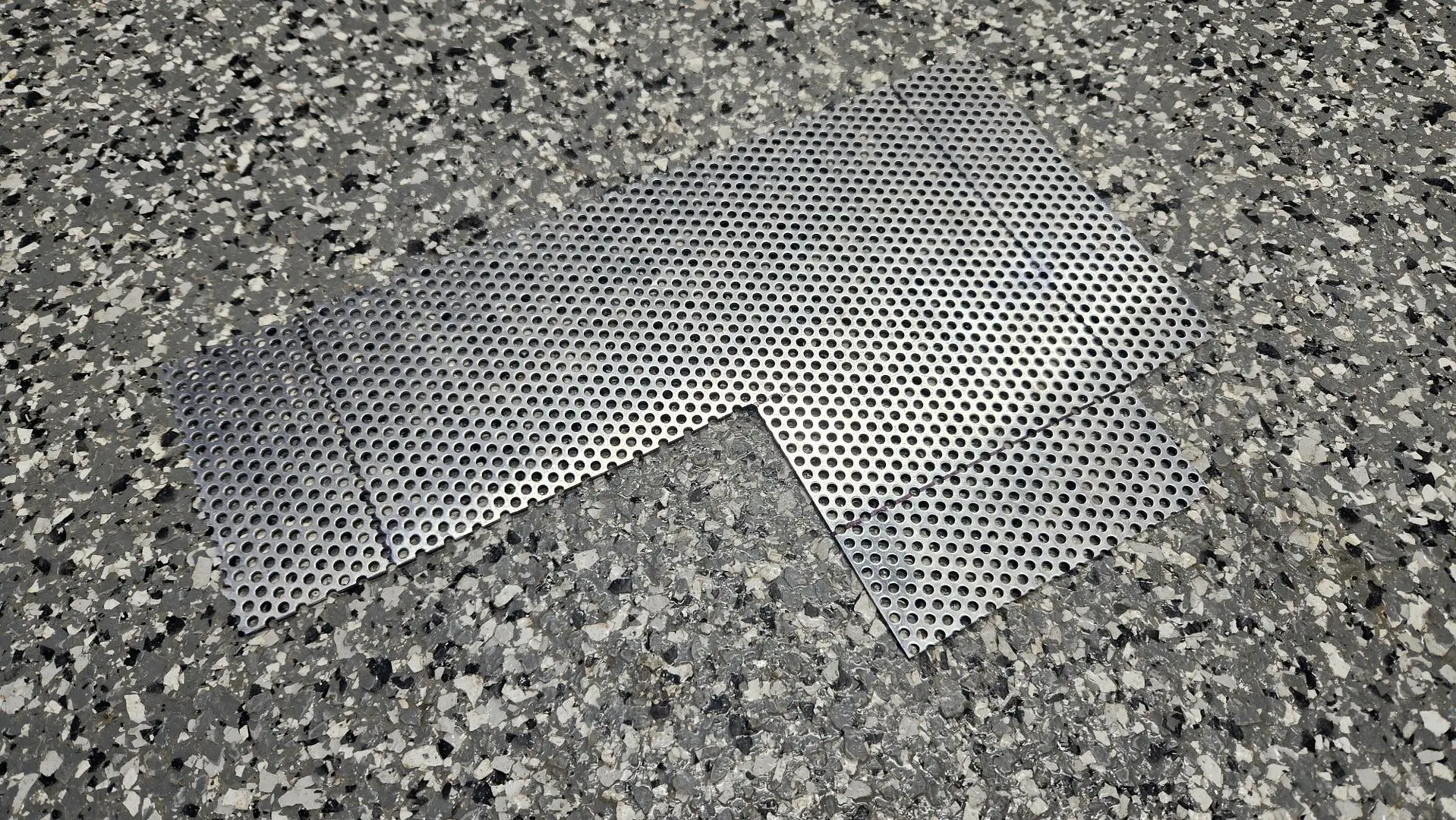

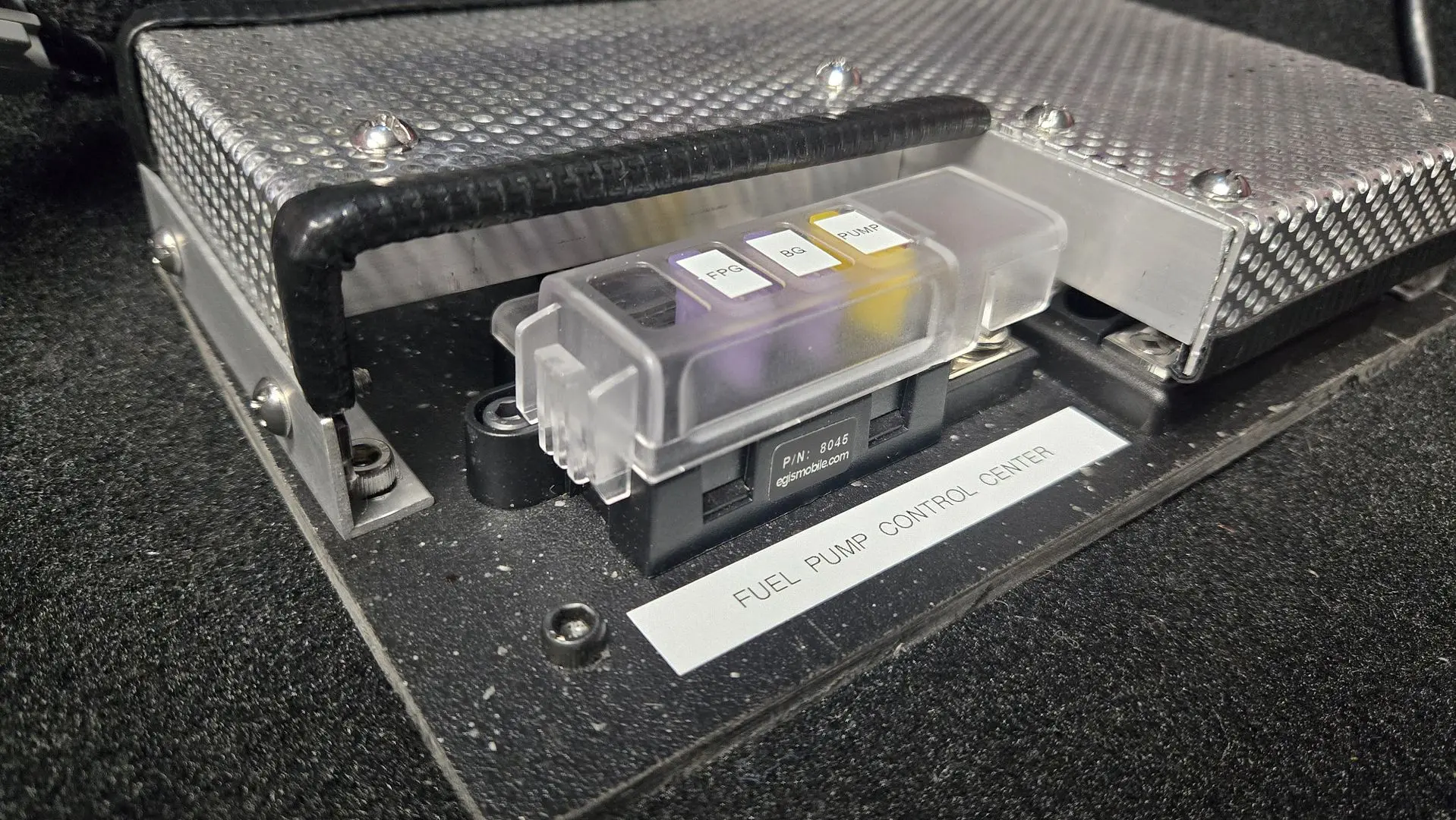

Today I revisited my relay / fuse board. I couldn't help but feel it was incomplete. So I decided to make a cover for it. I used some of the perforated aluminum I made my T/C mount with, but this stuff has bigger holes.
Cut
Fold

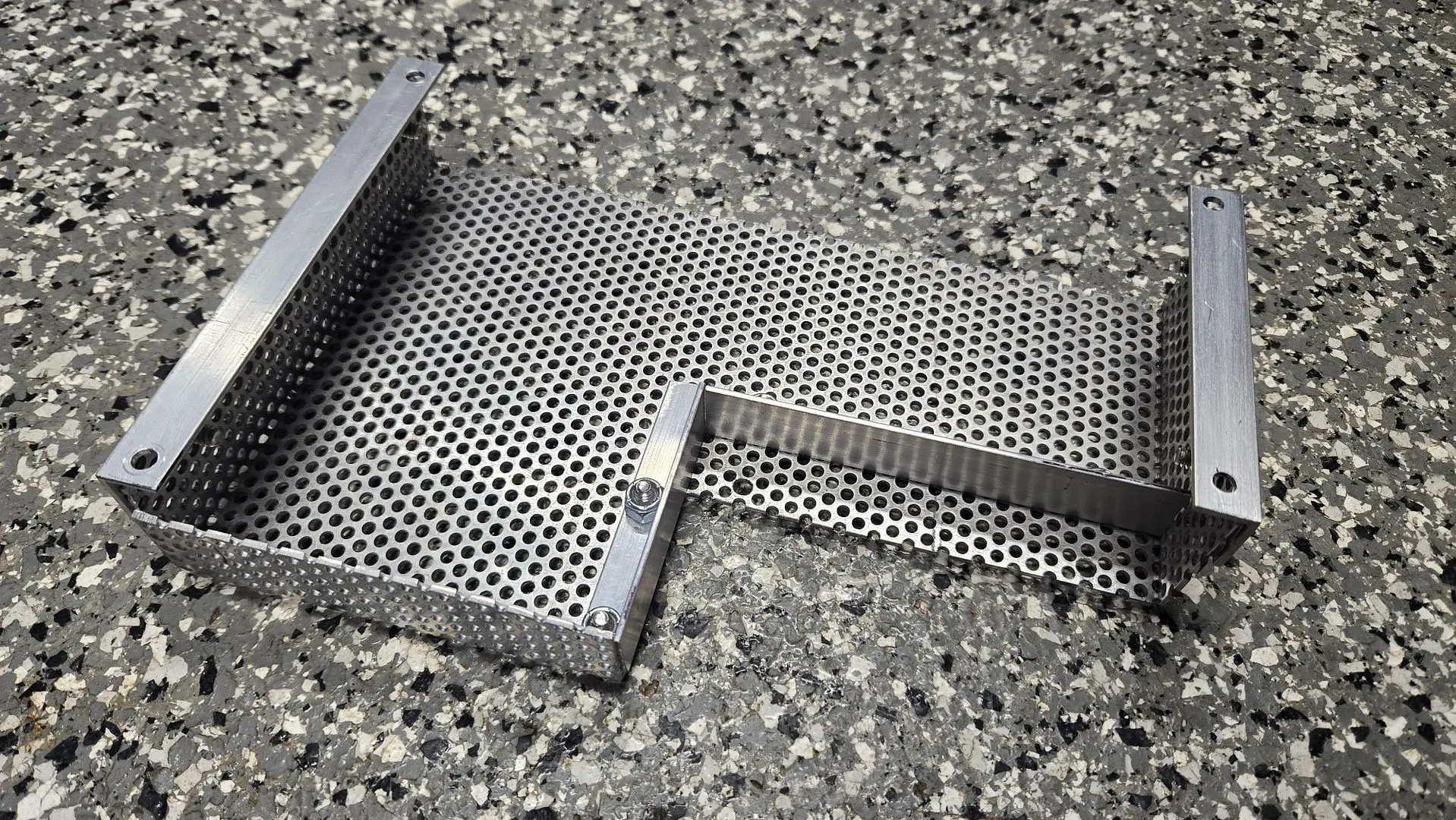

Add mounting channels and divider
Mounting channels attached to board. Also made some lables for everything.
Now it seems complete
The little dividers drop down inside so nothing can get in there.
The fuse cover can be removed without removing the aluminum shield

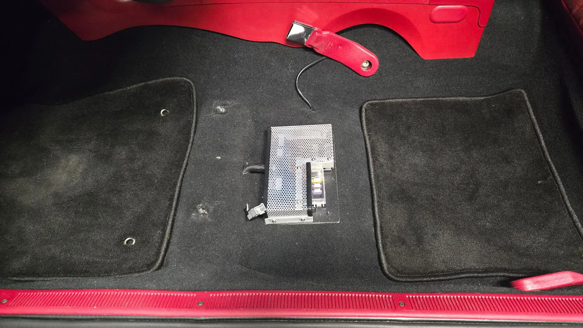

Under the seat it looks more like a finished product. With the seat all the way forward I can access the fuses pretty easily.

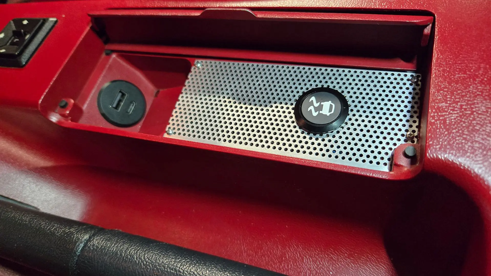

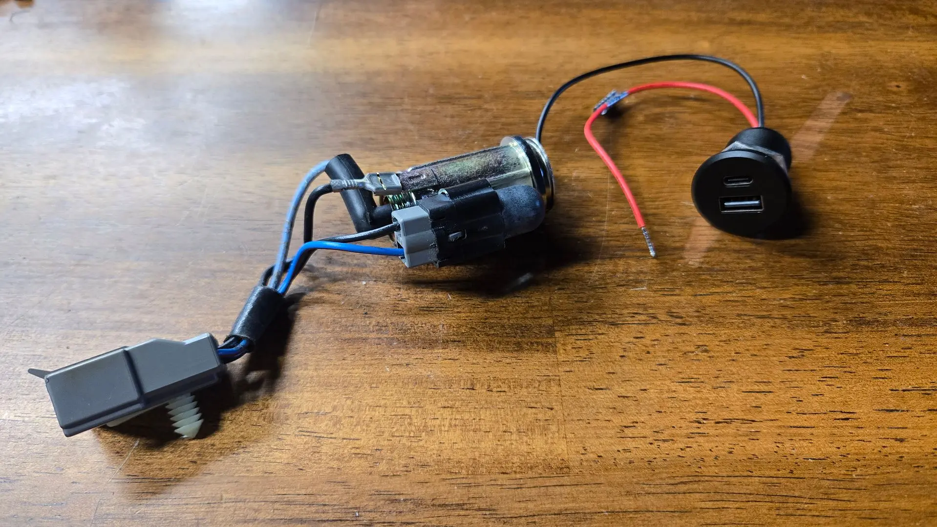

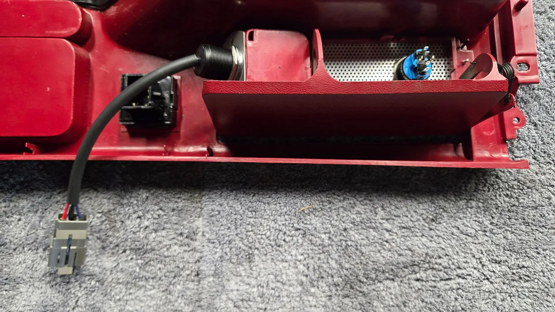

I got my USB plug yesterday night to replace the cigarette lighter. The first one I ordered was too big and I'd have to enlarge the lighter hole in the console alot. The correct one has a 7/8" body. These things are tough to find in that size and without lights or illumination of some sort. The socket is energized at all times, so it needs to be light free.
Lighter sub harness look like this. There are two connections. One for th lighter and one for the little light that illuminates the ashtray. That one comes from the dimmer.
I used the factory connector. So I de pinned it, removed the old wire from the pin and soldered in my USB lead.
This is gonna be way better than the big bulky adapter I was using before. I plugged in my phone and it says "fast charging". So center console officially back together now.

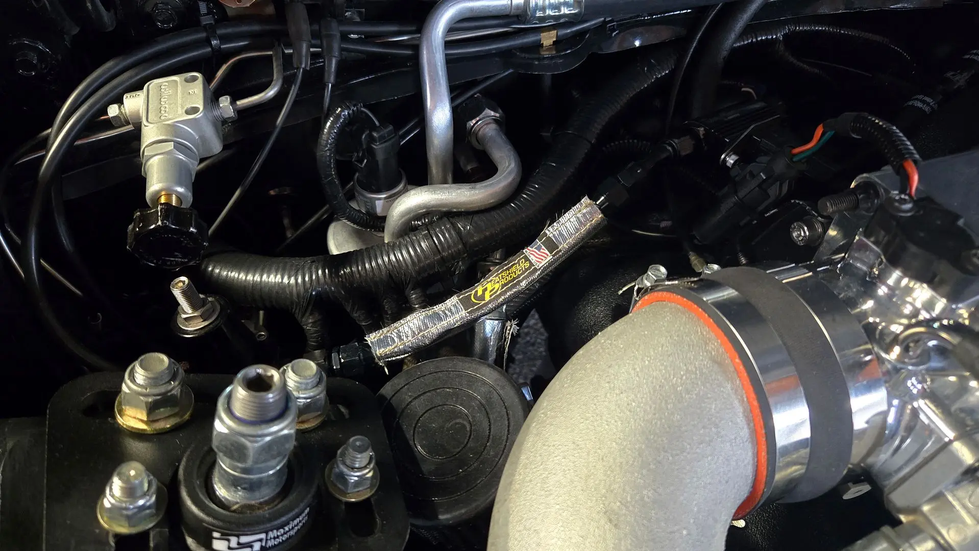

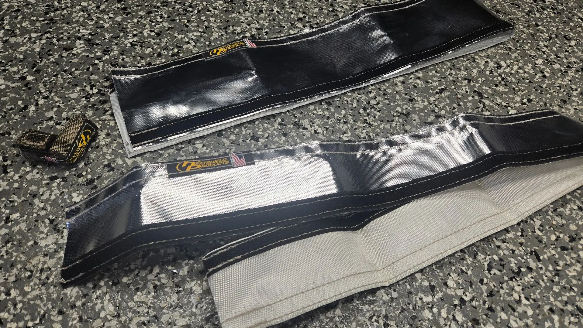

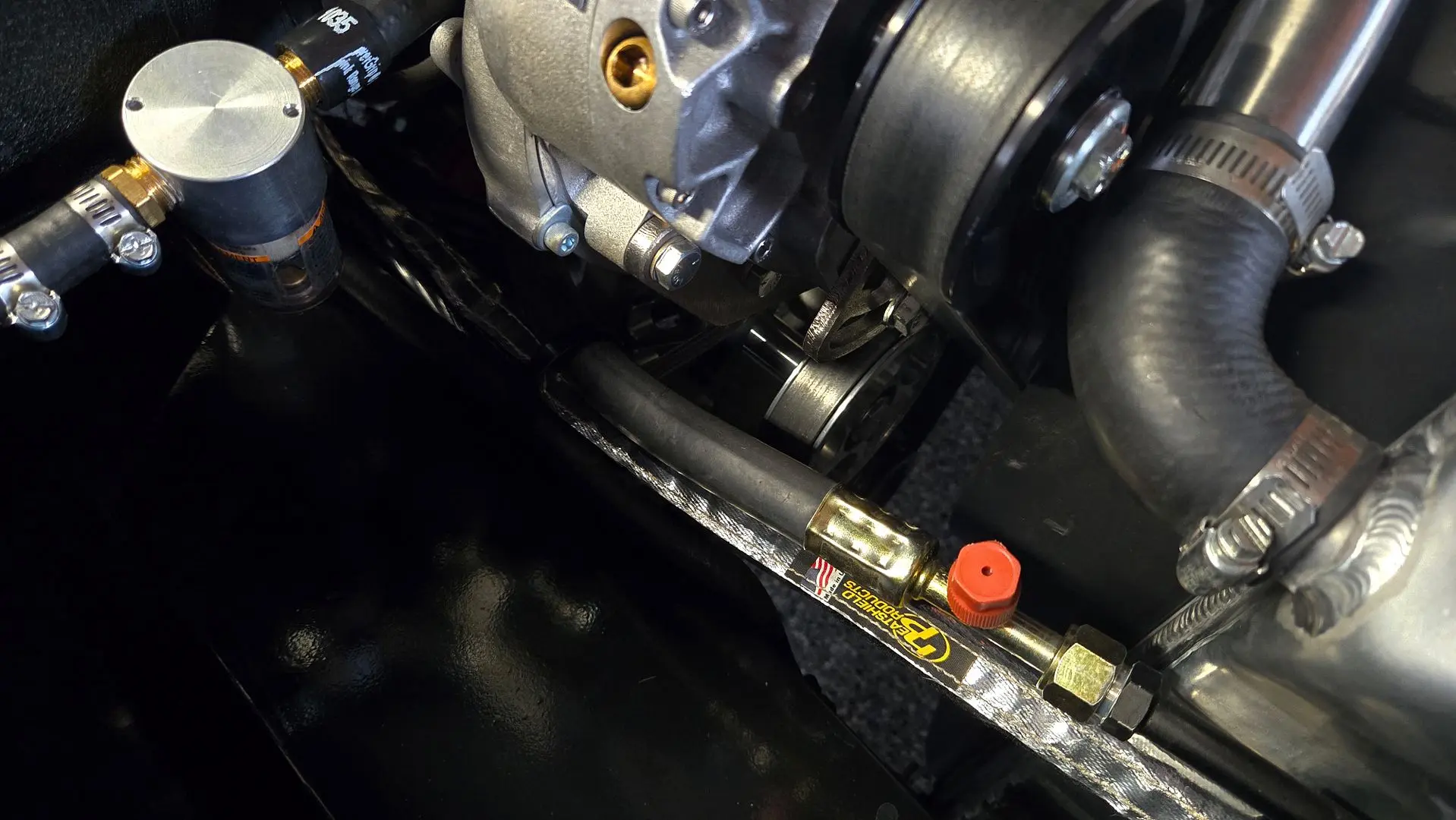

Yesterday I pulled the car out of the garage and took a half day to clean the floor and organize. Felt real good to get everything back in order. Then I tinkered around a little with the car. I got some heat wrap from Summit.
One peice for the A/C line to the evaporator core to help shield it from header heat. Also added some on my fuel lines by the filter under the car. The 90° peice is pretty slick. Fits perfect on the filter outlet line.

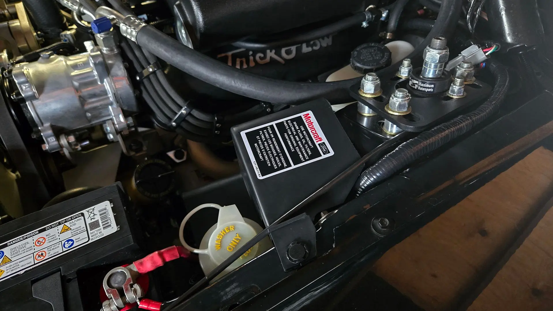

Got a new coil cover. Put a sticker on it and can't decide if it looks dorky.

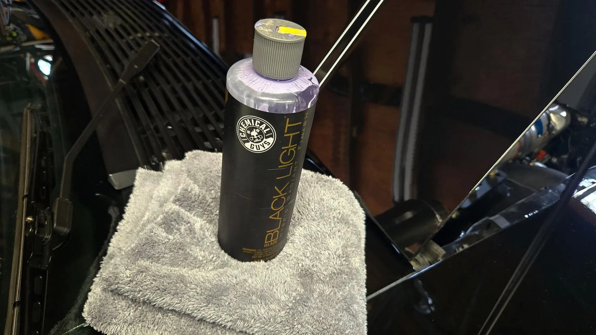

-Wash w/ C-guys car shampoo
-Meguires Clay bar

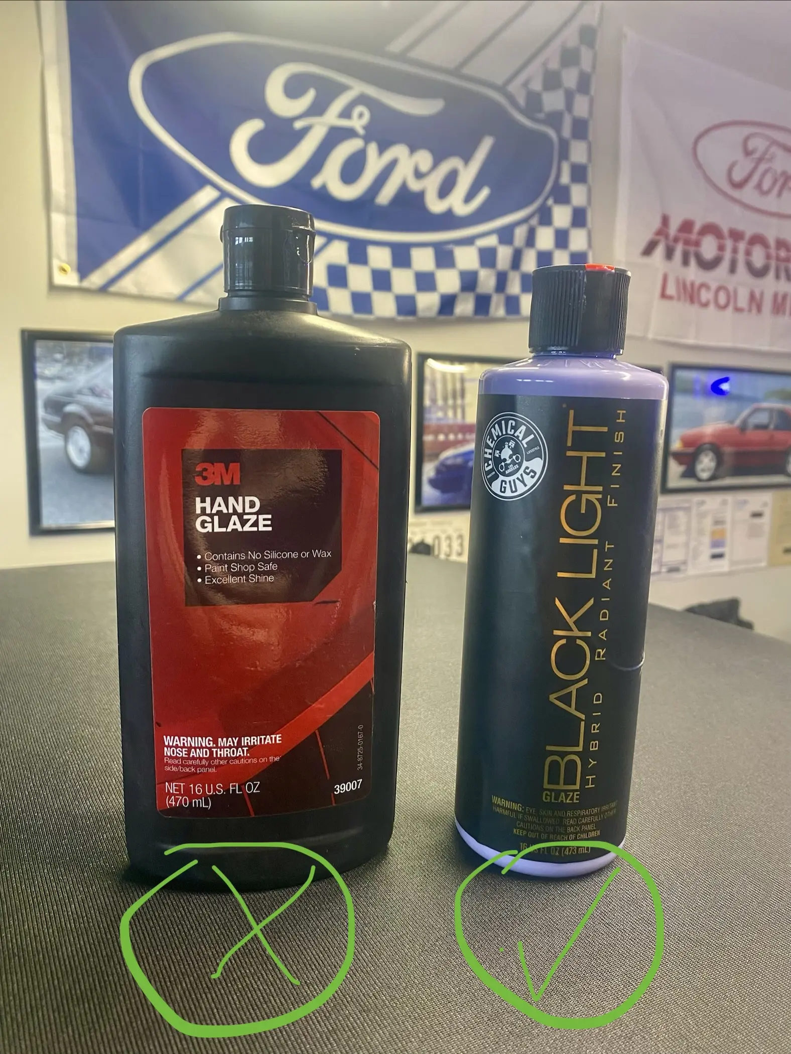

-3m Ultrafine machine polish #3. I do this by hand and only in the spots where there are any light blemishes. When I got the car I restored the original paint. Which was involved, lots of wet sanding and machine buffing. Now it's just yearly maintenance. I'm not sure how much clear is left, so I'm pretty much done w/ machine pads.
-Then two coats of C-Guys Blacklight glaze. This stuff looks wet and slippery. Best stuff I've tried and I've tried just about everything.

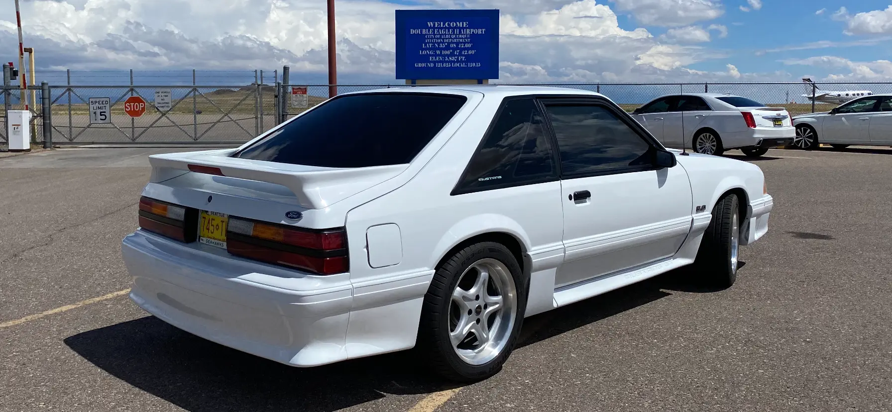

Car looks awesome @nicholase, I love it!. I need to pull the trigger on the 17 inch Ponies. Are you going to tint your windows?
Thanks man. Appreciate it. Yeah, the 17" ponies really capture the stock-ish look I'm going for. Really love em.
I think I'm gonna leave the windows. I know lots of guys tint em. That's cool. As I get older I like the non tinted look better on older cars. Which is weird becasue all through my youth the first thing I'd do was get the window tinted, like the same day I got something new.
But who knows, that could change.... I've been tempted.

Your post just cost me 32.00 bucks. Lol
[Ordered from Amazon]. Arriving tomorrow.
Lol. You'll like it man. I use it directly to paint. I've found it best to remove whatever wax you have on there first. A clay bar works, or whatever means you usually use. You can then wax over the BL if you want.
Separately: the coil cover decal looks clean in my opinion.

I tried the black light today and man oh man is it so much easier to apply/remove than the 3M glaze that I have been using but the real take away here is that the BL results are incredible! Glossy mirror like finish! Next level over the 3M glaze! (The smell is also very nice I may add). This is my new jam so thanks for sharing this product recommendation with us all. I’m a fan!

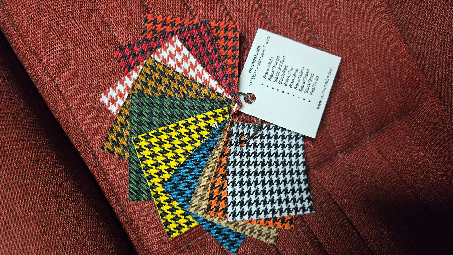

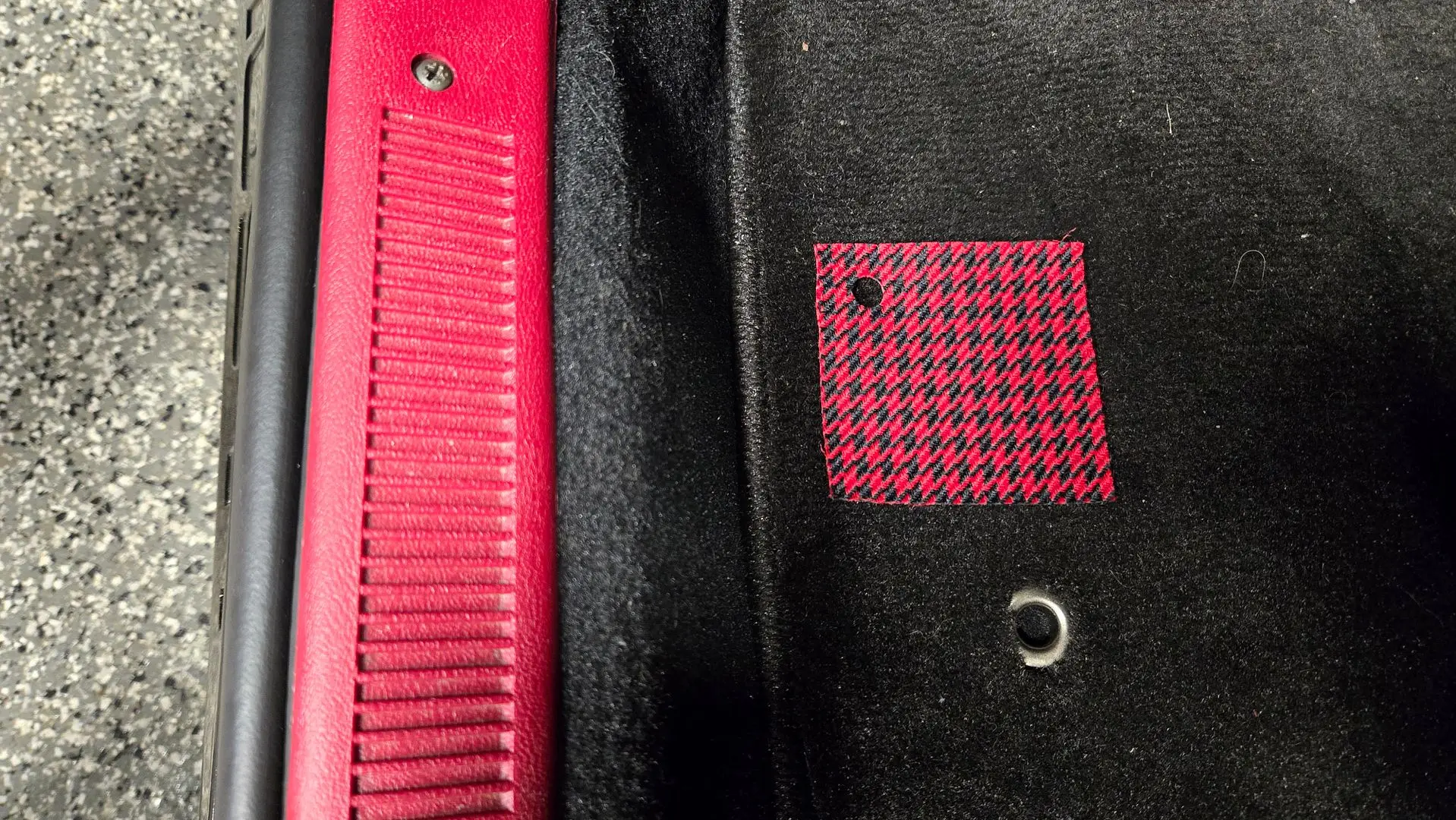

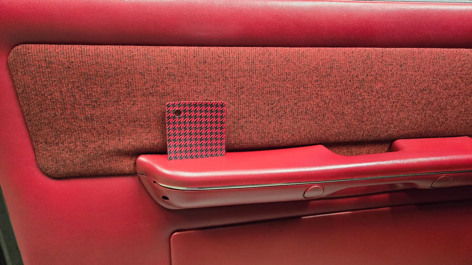

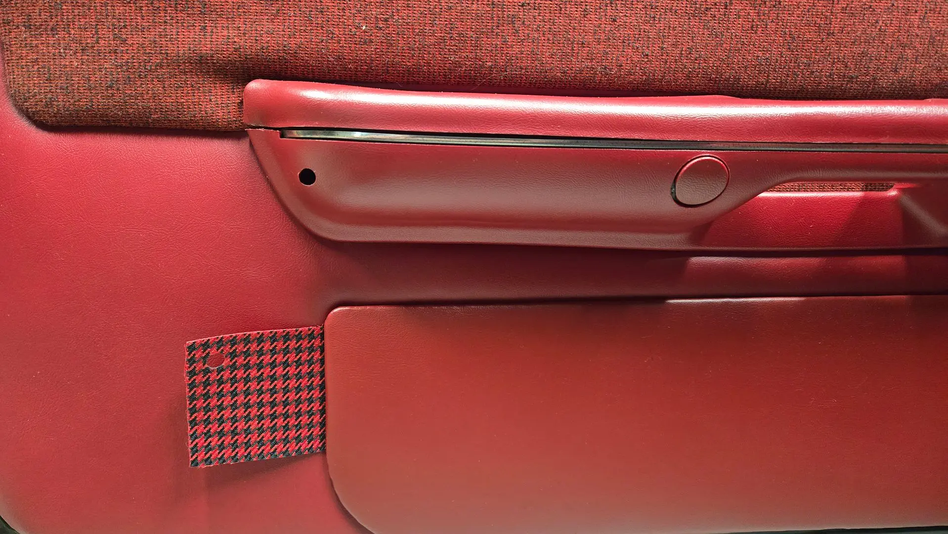

This is the first weekend in a while no parts showed up. So I put some more thought into the interior. I decided to do this over the winter, this would feel rushed trying to do it without significant down time this summer and I'vehad enough of that for a while. So it's not happening soon, but its fun to think about and research. Originally I was thinking to go with red for the seats and perforated inserts. But after some thinking, I really like the look of fabric for inserts. I ordered a houndstooth sampler to see if i liked it.
I also ordered a yard of the marine grade vinyl that we thought best matched at the upholstery shop last weekend and compared the houndstooth samples to it. But after looking at it for a while, I actually prefer the houndstooth against my black car cover over the red MGV. So I might be onto something here.
I think this one matches really well. I'd probably do the door panel insert in it too.
At this point I'm leaning to keeping the front seat frames. I'll strip them and beef them up a little with some welding. Don't want that gangster lean happening after I re-upholster them. I also have to fix the lumbar bags. They work but don't hold pressure for more than a few hours. Probably a leaky bag. I'll have to find a fix for that. That's all best saved for a winter project.
As for the upholstery I'm leaning to keeping semi stock lines. I'm thinking replacing the seat foam with the Cobra seat foam They look very much in line with the factory sport seats, but have some deeper bolstering. For the look I'm thinking about black MGV with red stitching and using the red/black houndstooth for the inserts. Something like this:

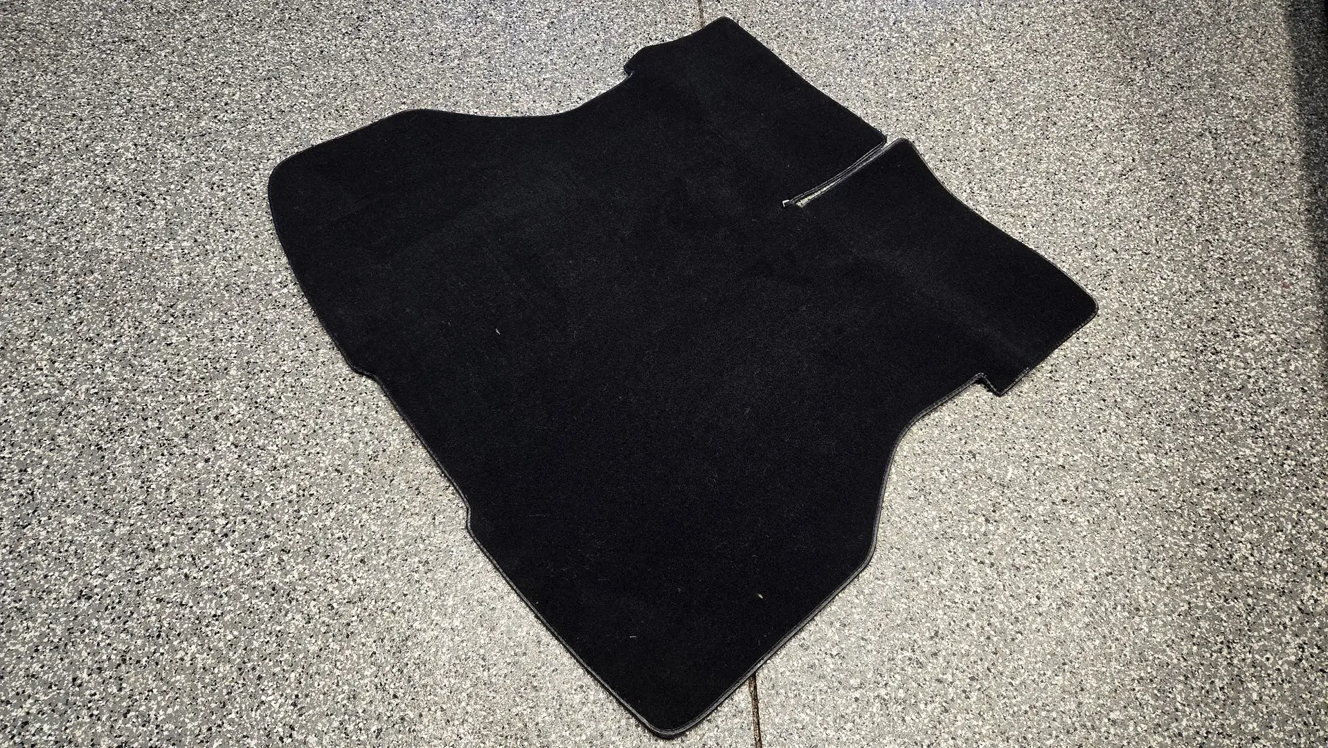

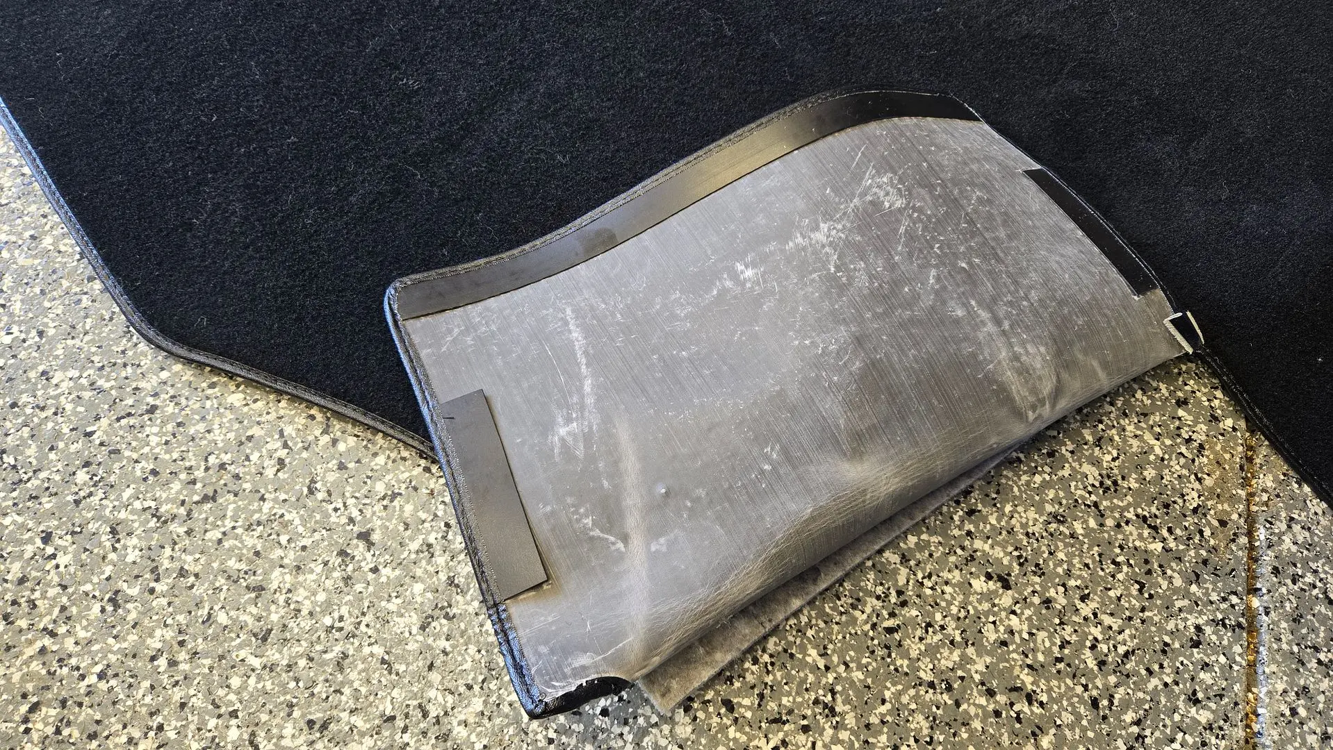

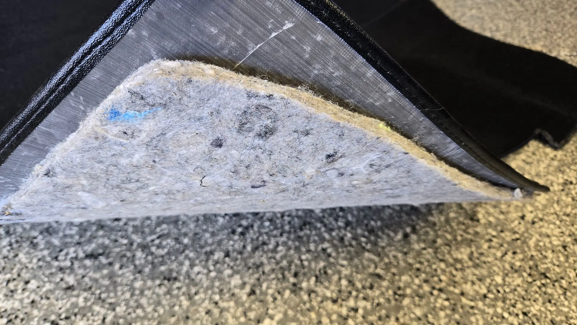

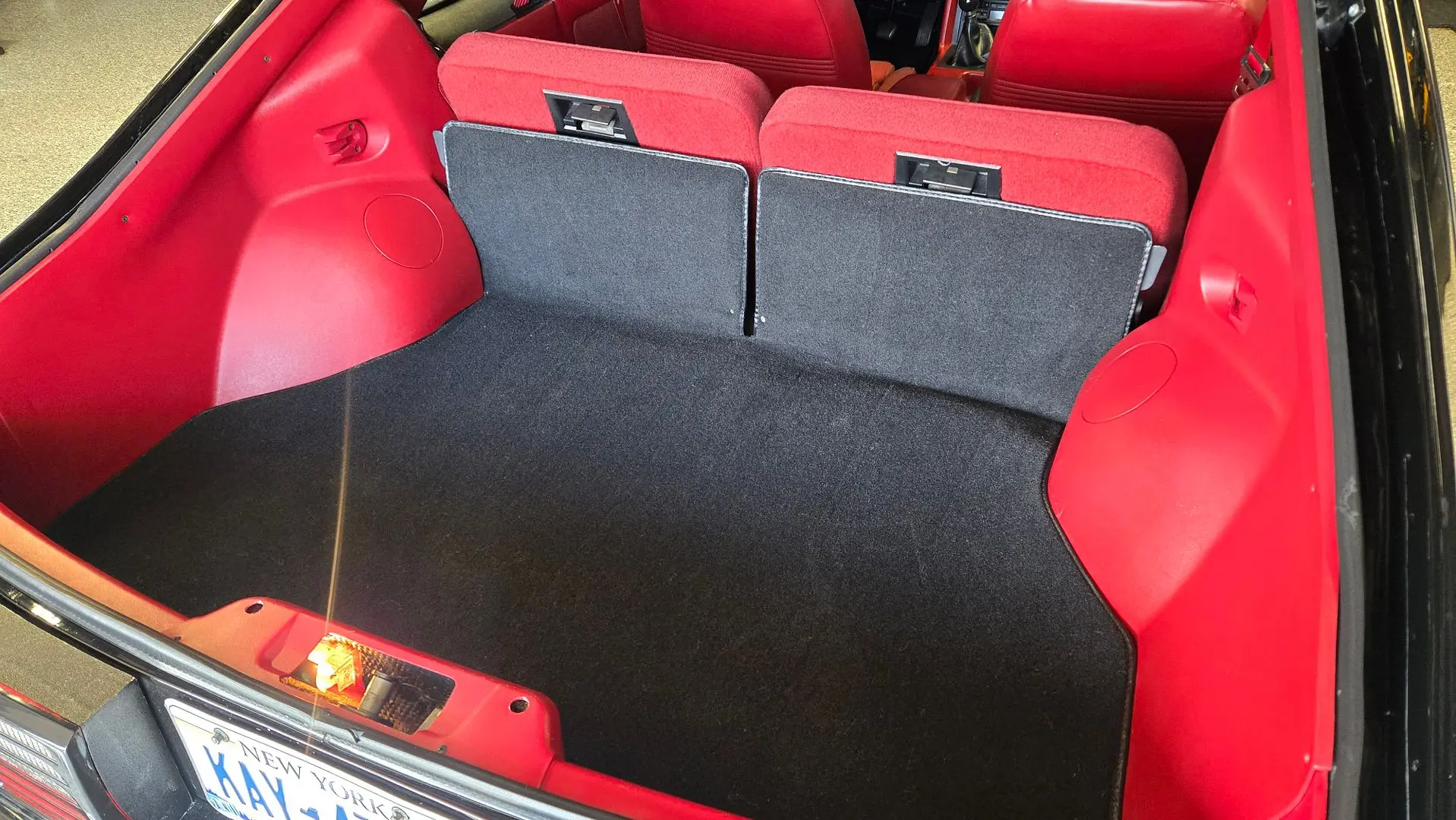

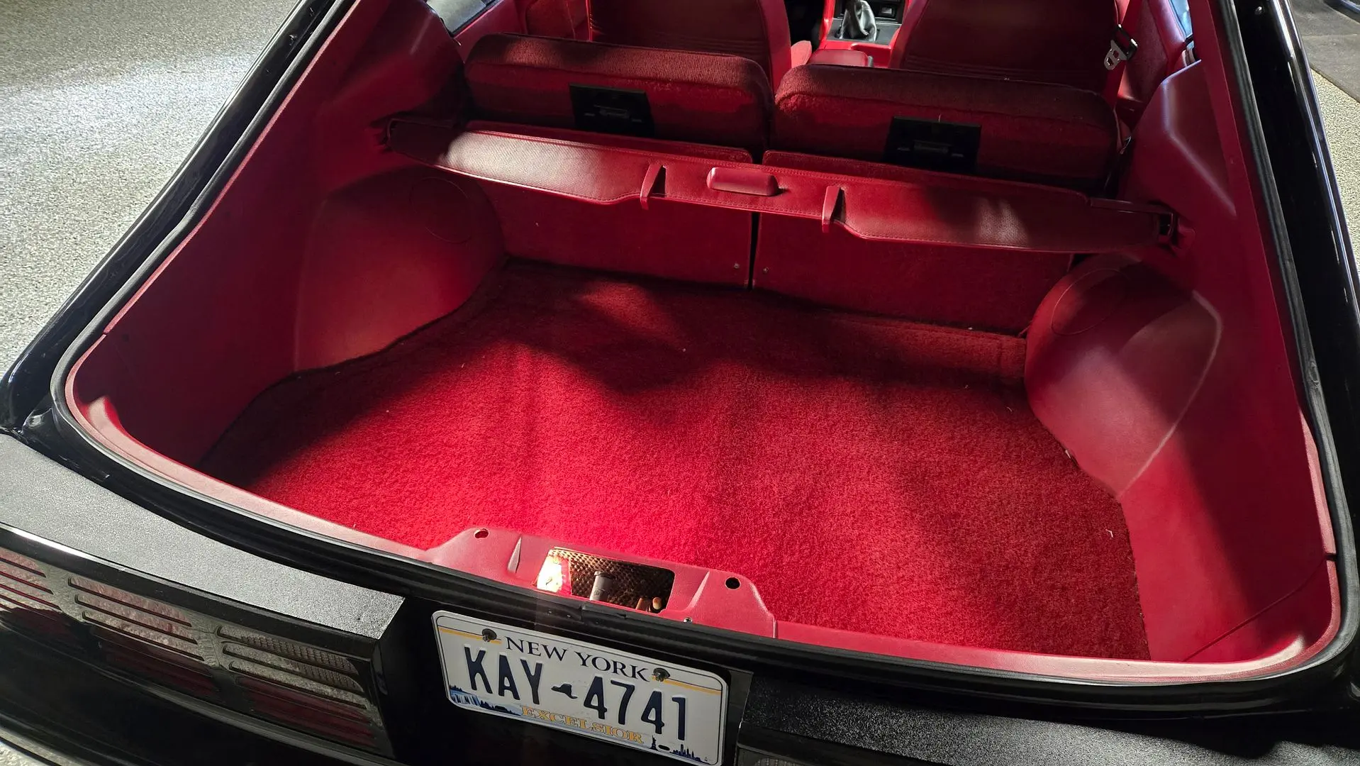

I ordered hatch carpet to match the rest of the car. I had tried a black one before but it was pretty terrible. I ordered this one direct from ACC.
There are many more options doing it that way. I ordered black with the Essex upgrade.
Also added the mass backing upgrade, which is a rubber layer bonded to the carpet. The pad is glued to that.
The mass backing is on the seat flappers too.

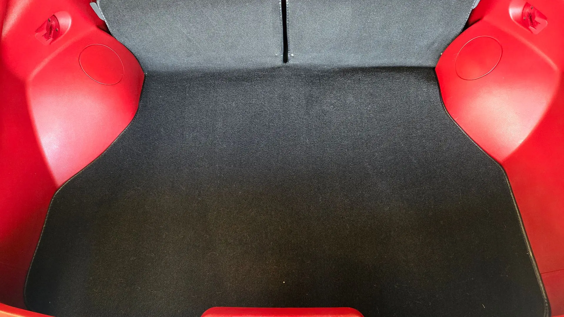

The last one I tried was so flimsy it always looked distorted, especially around the seat flapper. When you custom order it takes a few days to ship out. I had it about 10 days after I ordered so pretty quick turnaround. Too bad LMR or places like that don't offer these options. No returns on custom orders so that's probably why.
Before:
After:
I think it will all come together when I do the seats this winter.
