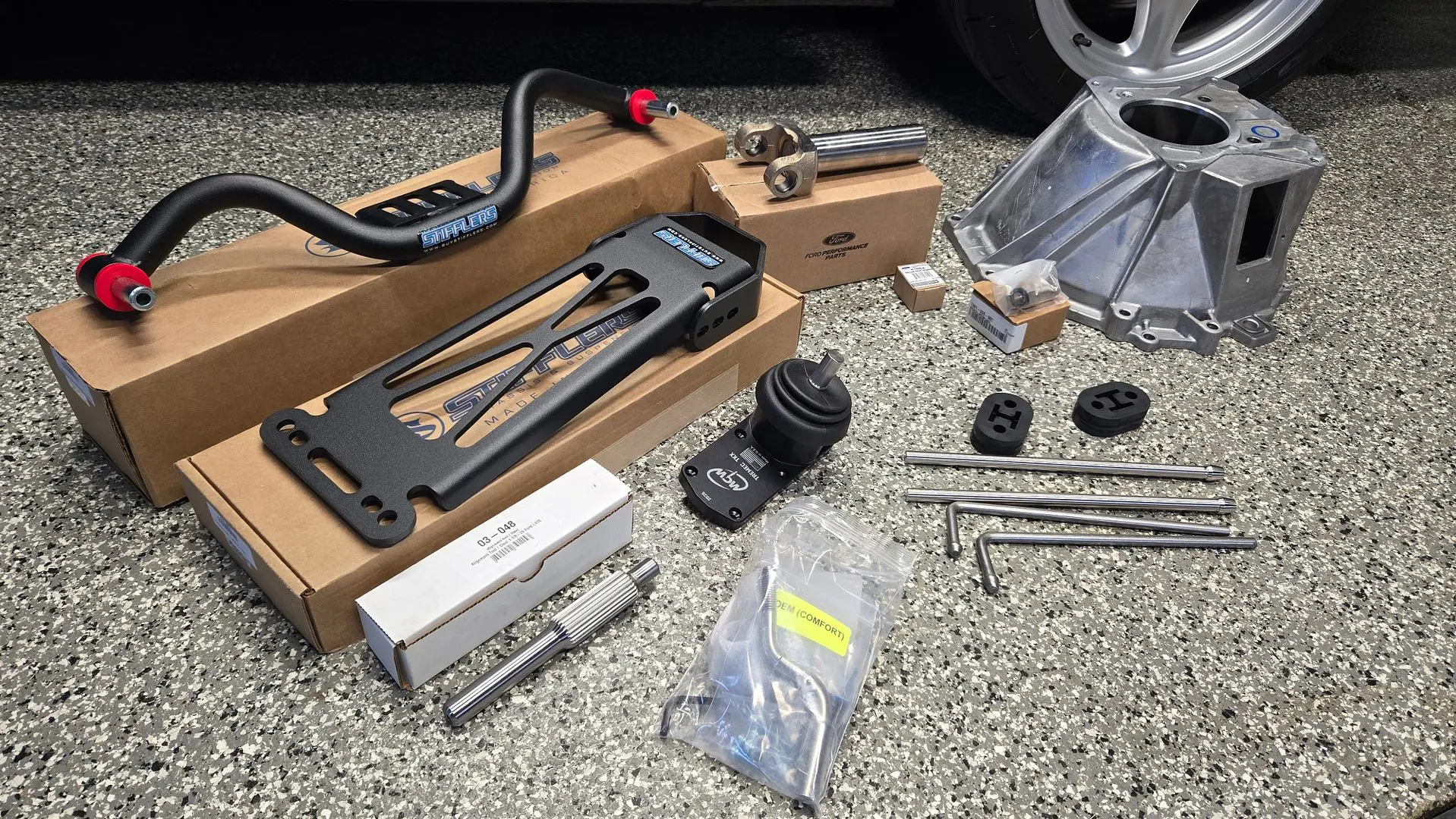

Going through my parts for the TKX swap. I might try it this weekend or next. We'll see. I think I have everything except the trans. It will probably ship Monday. Went with the 26 spine, 2.87 first, .68 fifth.
Let's see, I have the
-TKX bellhousing & pivot stud
-Ford Performance 31 spline driveshaft yoke
-Ford Performance pilot bearing
-MGW shifter
-Stifflers crossmember and driveshaft loop
-TKX specific bolt kit
-26 spline steel clutch plate alignment tool
Hmm.. no T/O bearing. I just put one in last year, probably should though. Autta order one.
I got some stainless steel and regular steel exhaust hanger rods and rubbers. I'm going to delete the factory X pipe hanger set up. It never lined up right with my X pipe. I had to oblong the holes and the x pipe hangers are always close to rubbing something like the speed sensor. So I'll make something new. I wamt ot so I can drop the X pipe in one peice easily. So while its out I'm going to weld it up solid
I'll probably be down for a few weeks. Have to send my clutch discs to McLeod to be rehubbed and drop of the D/S to a local shop. I'm gonna have them swap the yoke and re balance it.

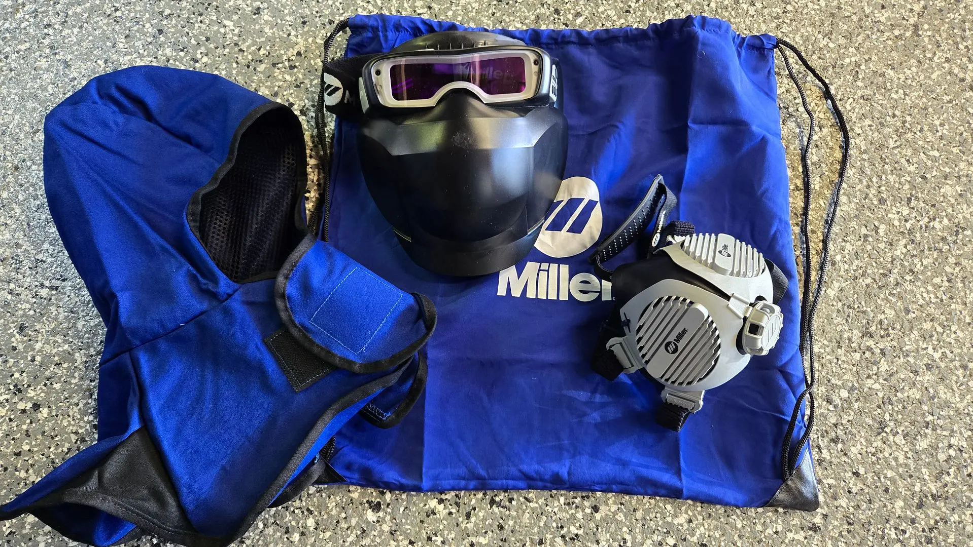

My old welding helmet also wasn't working very well. Not sure why but has been getting harder and harder to see out of. So I tried a new style mask. Its really small and should work much better under a car or tight areas. Should have got it when I did my subfrmaes.
I kinda feel like a Ninja Turtle with it on. Old Mutant Ninja Turtle anyway.

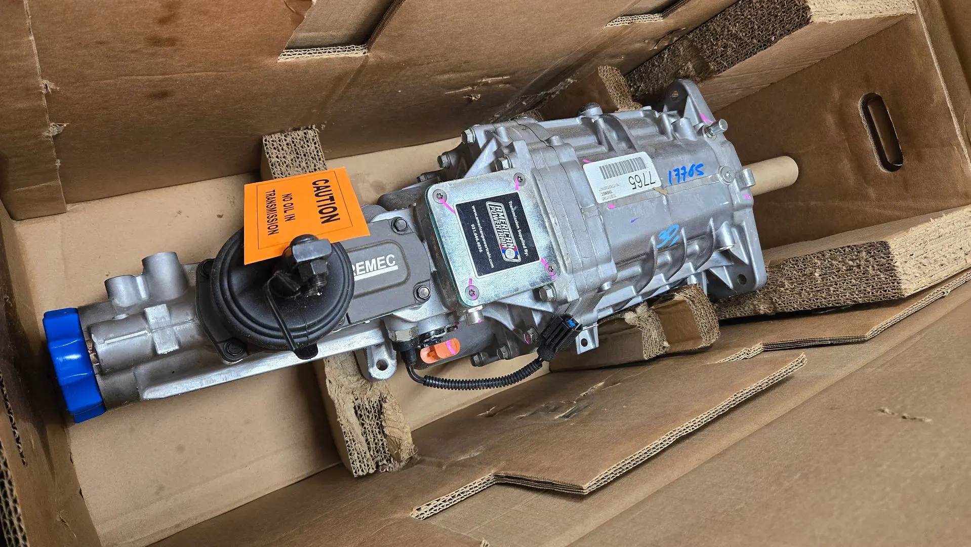

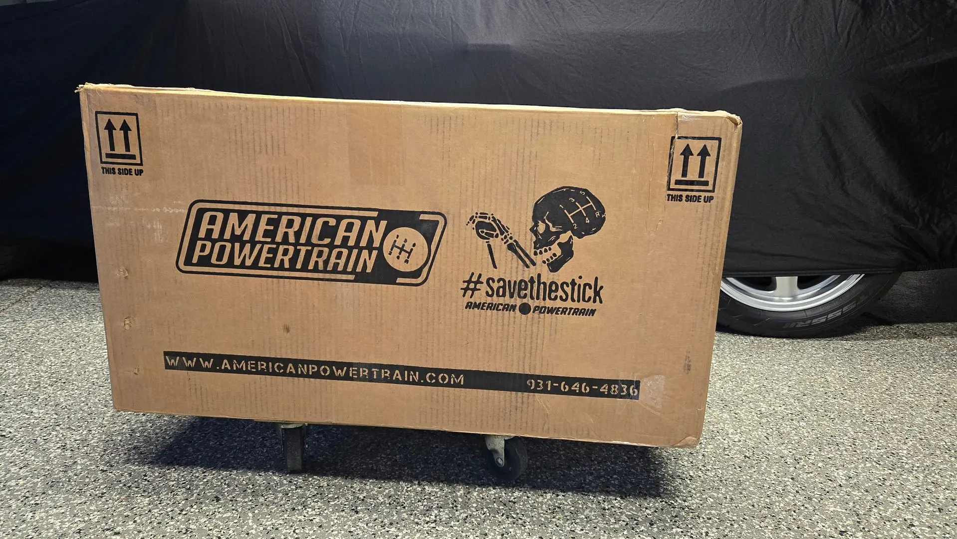

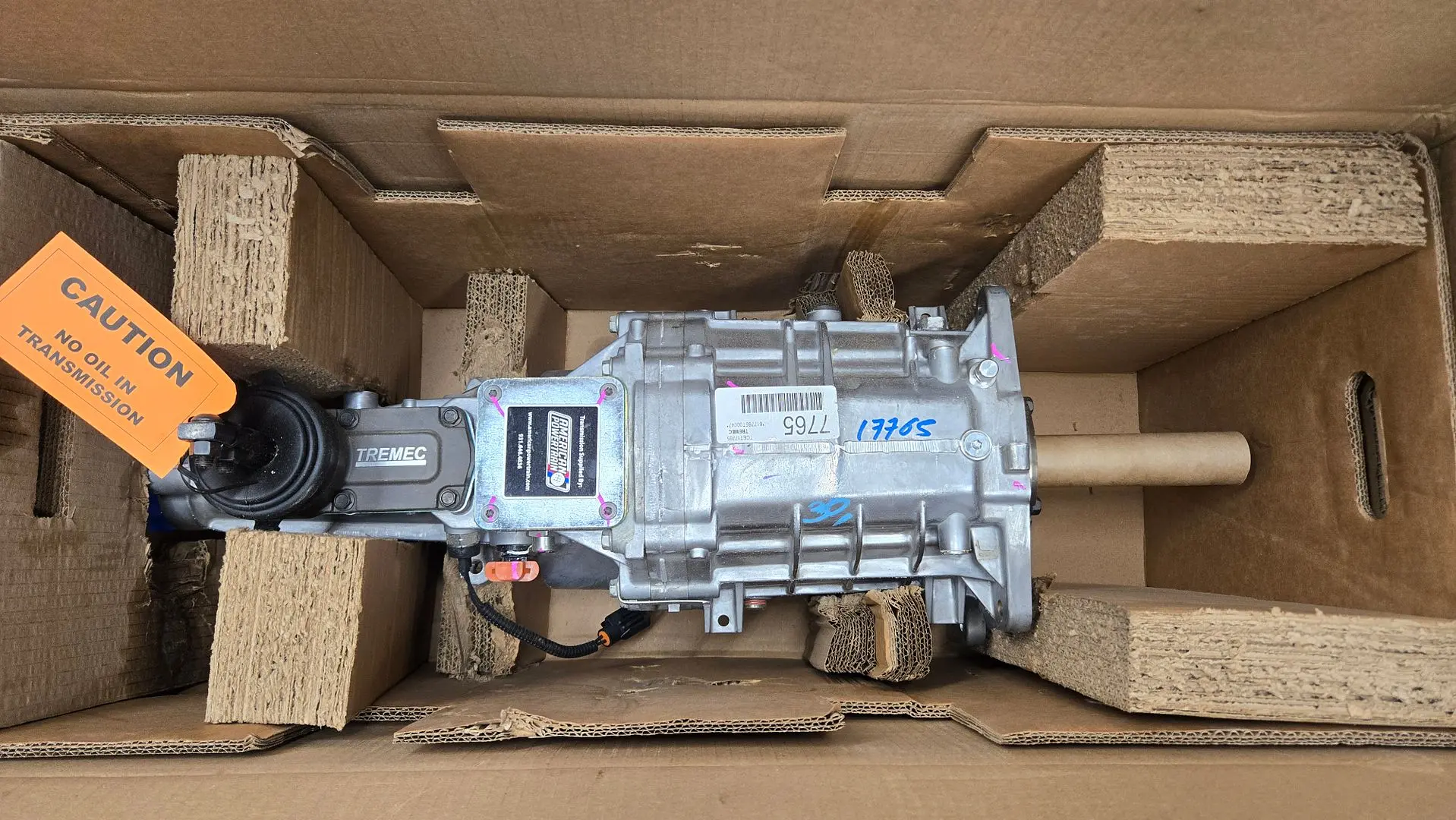

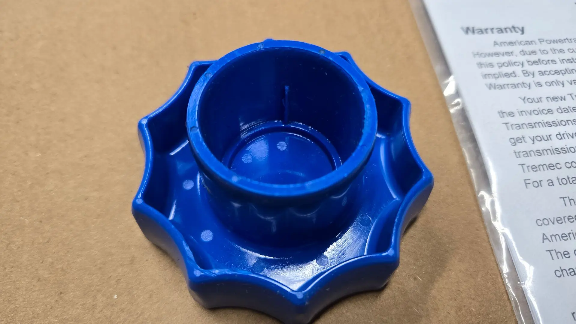

This showed up today.
TKX 26 spline. Close gear ratio 2.87, 1.89, 1.28, 1.00, 0.68

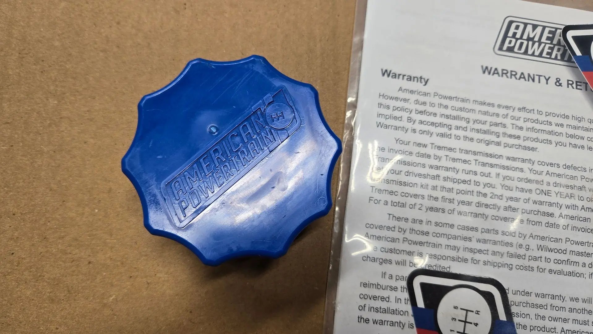

I ordered it from American Powertrain. I went with them after I discovered they double box to help prevent shipping damage. I'm not sure if the others retailers do. If they do, I didn't see any mention of it while shopping.
They also include a seal saver to protect the output shaft seal. They used some good logic and made this little blue shipping protector double duty as a neat little tool.
It protects the seal in shipping but also works like fluid retainer when I have to pull the driveshaft, and also a little knob to rotate the output shaft while installing the trans to line everything up.
It has a few splines molded into the inside to grab the output shaft.
Saves from trying to use your driveshaft if you don't have an extra yoke laying around. Nice little $15 tool available separately as well.
https://americanpowertrain.com/shop/transmissions/transmission-install-tool-and-seal-protector/
Not sure when I'm going to install it. I've been having so much fun driving the car I'm not really looking forward to a chunk of down time.
At least it's here in case I need it lol.
