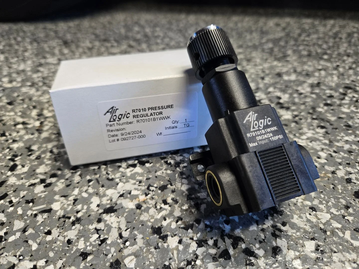

Earlier I mentioned coming up with a interesting idea to tune the FMU. I wrote up a bunch of stuff and posted it here in better detail. https://stangnet.com/mustang-forums/threads/tuning-vortech-kit-with-fmu-discs-question.927914/
The short of it is i installed a mini adjustable air pressure regulator between the vacuum line and FMU top make it better adjustable. It works great. It's made by air logic in the USA.

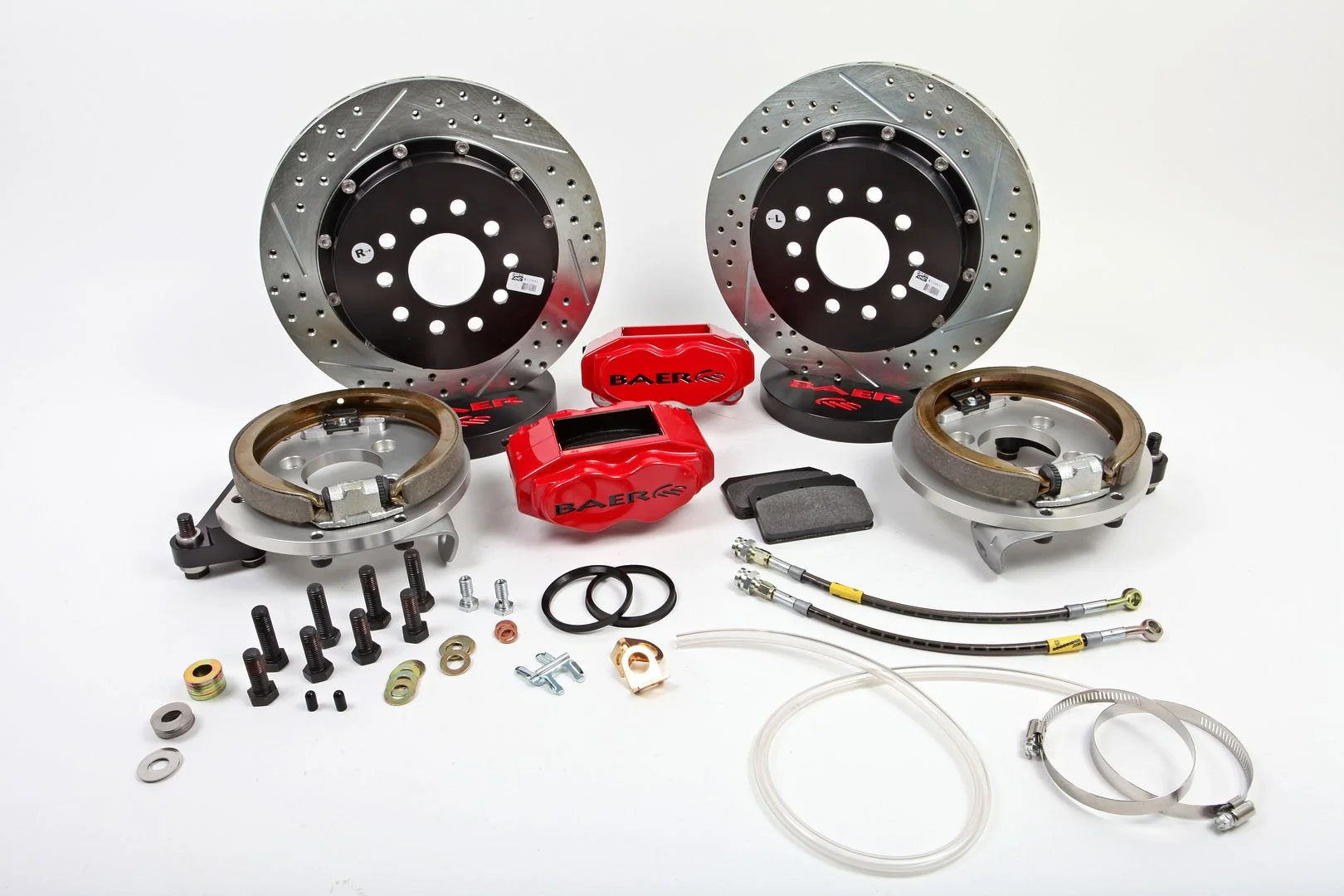

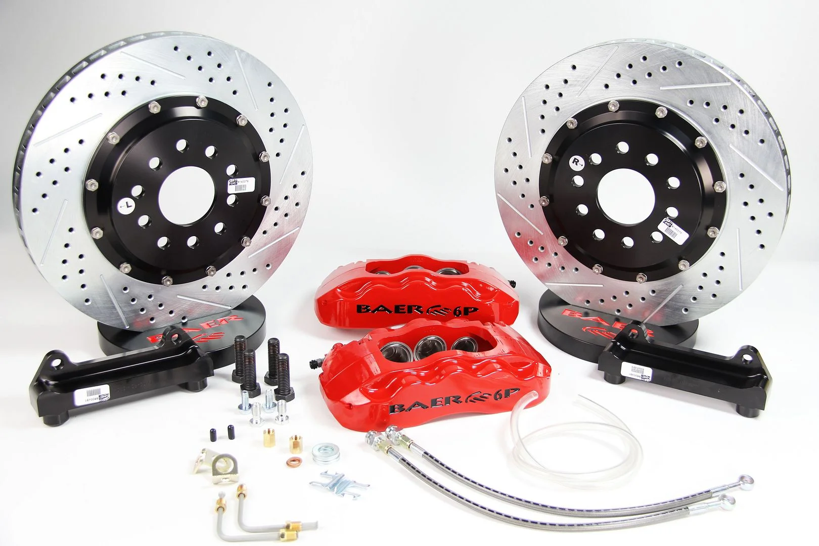

Order in for my winter projects!
This winter I'm going to try and address my traction issues, convert to 5 lug, and install big disc brakes front and rear.
Ordered:
5 lug 17" pony's 8"/10"
Ford front hub and accessories for my 94 spindles that I restored earlier in the thread.
Dust shield for the spindles
Moser 5 lug fox length axles with 94+ flange
Ford performance carbon traction lock kit
Axle seals
93 brake booster
94 master 15/16" bore
Brakes line and prop valve kit
Then ordered the brakes:
Baer 13" Pro+ 6 piston calipers w/ two piece slotted rotors
Baer 13" SS4+ 4 piston caliper w/ two piece slotted rotors
I really like the e brake set up / backing plate of the Baer setup. From all the info for I've gathered the rear rotors should fit the 94+ rear flange axles I ordered without any hubcentric rings. I'll update if there are any issues. The front rotors are direct fit to the SN95 spindles.
As for the Pony wheels, I really like the look so I replaced my basically new 4 lug 17" pony's with the 5 lug version. Oddly LMR doesn't list the center bore diameter for them. So I called and asked. I was told they are 70.6mm same as all the other sn95 wheel options. Oddly they list the center bore for all the SN95 wheels but not the Pony's. They say they fit either fox or sn95. I was lookimg for a measurement because I really wanted them to be hub centric apposed to lug cemtric. Which from what they told me I believe that's the case.
As for traction I'm hoping the new carbon traction lock set will help. I think that might be some of the problem. I also wanted to better address the supsension. I've been real happy with everything I've gotten from Maximum Motorsports. Currently have their sub frame connectors, rear adjustable LCA's, UCA's, and CC plates. So I called Maximum Motorsprts and had them help me put together a kit.
Based on his recommendation I ordered front coilover kit 250lb spring w/ Bilstiens
Front control arms w/ urethane bushings
Rear road and track springs (for my MM adjustable LCA's)
Rear Bilstiens
All the bushings and little stuff to finish it up.
He suggested trying this first, then if still not happy with it to try a track bar. So we'll see. Maybe I'll just do that this winter too. Time and budget depending.
That should keep me busy for a while. I'll post up some pics as things roll in and I get going.
Ordered:
Axle seals
93 brake booster
As for traction I'm hoping the new carbon traction lock set will help. I think that might be some of the problem. I also wanted to better address the supsension. I've been real happy with everything I've gotten from Maximum Motorsports. Currently have their rear adjustable LCA's, UCA's, and CC plates. So I called Maximum Motorsprts and had them help me put together a kit.
Rear Bilstiens
Really looking forward to the look. I really love the Ponys. Especially when staggered and some modern brakes and suspension tucked behind them.
The only thing I wasn't sure on is studs. I'm gonna with till I get the hubs/ axles and wheels and see what length i need. I'm sure I'll need some smalls to get it all together but I should have most of the big stuff en route.
