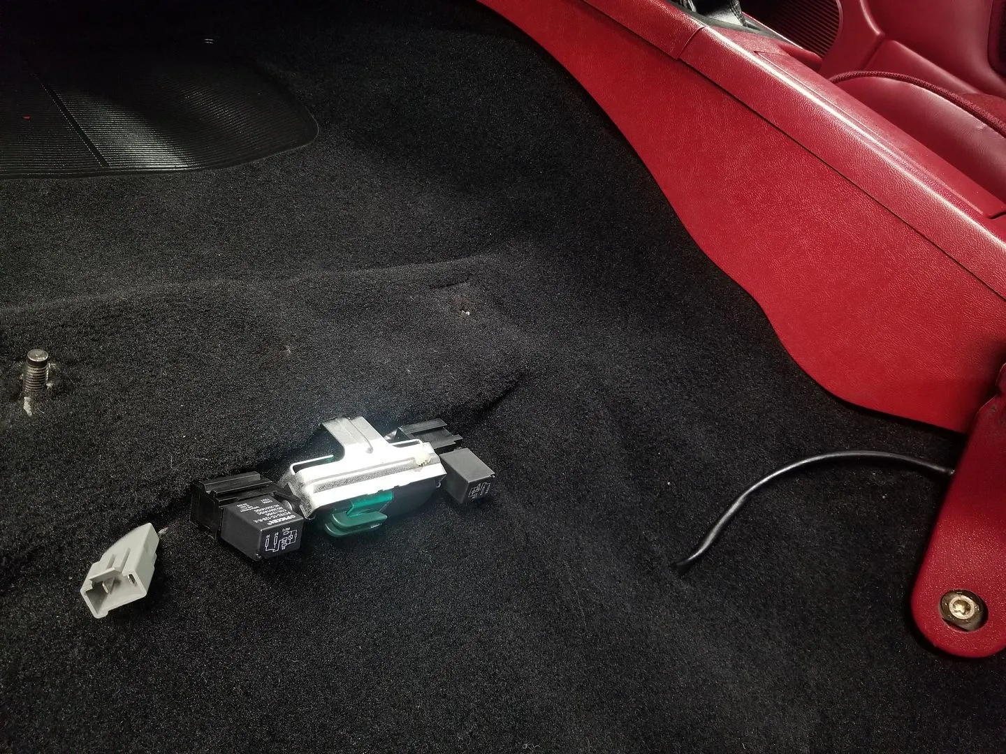

Fuel pump voltage can be solved with a 30amp relay mounted in the trunk with a 10 gauge wire from the battery for the power supply to the relay. Use the old pump 12V supply for the trigger wire. This will ensure you have enough amperage and the voltage will be much more stable. I did this on my Coupe and it’s loads better.
Thanks for the info.
I'm running a 130a PA performance 3g alternator and it seems to output pretty well. I did a few things different than the vortech manual. I passed on mounting the relay in the trunk and using the cigar lighter fuse as power. I put the relay under the driver's seat next to the factory fuel pump relay which I used as a trigger for the TRex pump relay. I also mounted my guage relay there. I ran 10ga power and ground from the battery to the relay and then back to the TRex.
The factory fuel pump bracket conveniently has places for a couple more relays. Just have to drill a hole in it, slide a clip nut over the hole and bolt the new relay to it.

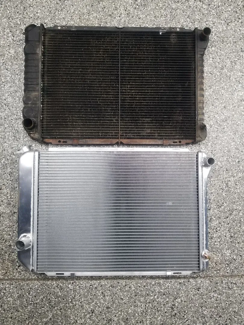

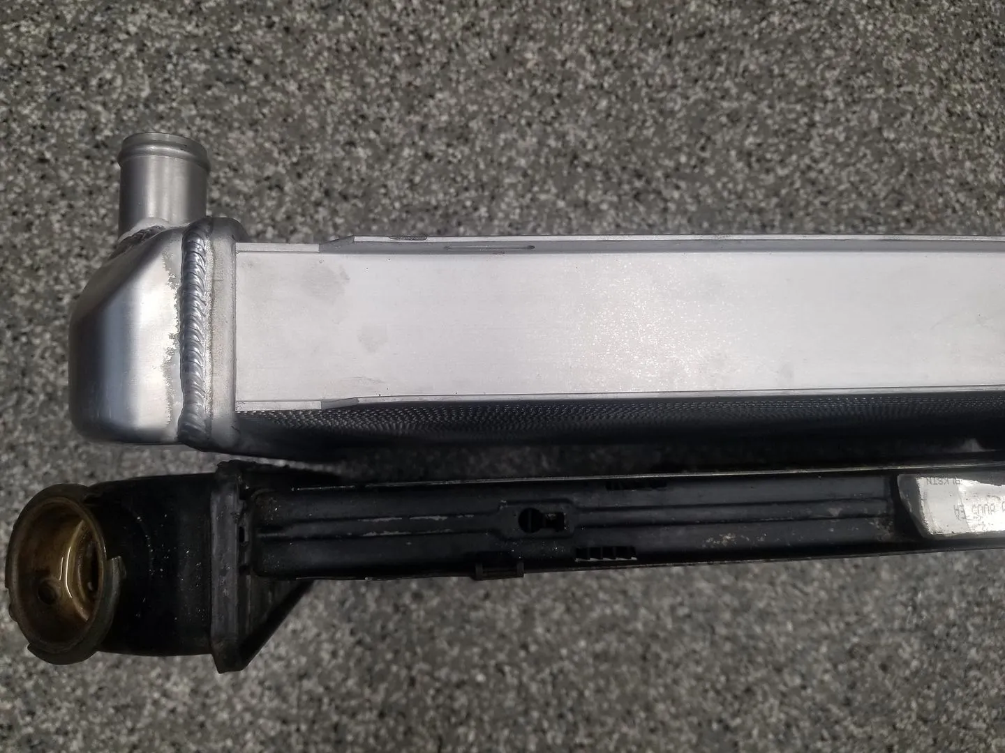

When I was doing the Vortech install I noticed how sad the factory radiator looked. Besides being 35 years old it's pretty scrawny. So I ordered a DeWitt pro series 2 row. Tool a while for them to make it. Just got it last week. Seems really well made. It's quite a bit bigger than the original....
For it to clear the supercharger pulley I had to relocate the wiring harness between the rad and condenser and move a few other things. While I was in there I replaced the condenser with a parallel flow and replaced all the A/C lines.
Nice looking rad. I like the stamped tanks.
