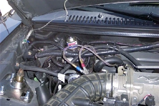

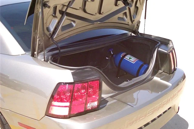

I think that would make it around 50 refills to reach the price of a blower. Thats why I was shocked to hear of folks paying that much. I can tell you I am probably close to 50 at around 8 months of use. Thats why I searched and found the best possible price. Even at 2.25lb that giggle gas can get pricey.
For me though its worth it regardless. Yes you can get more total horsepower from the blowers but you cant get the same on tap low rpm torque. Now that I have learned how to launch I can best blown mustangs a lot of the time. Plus I can run 87 octane during the week. :nice:
Eventually I think I will build my bottom end up and see how far I can push the nitrous only power adding method. Anyone have any ideas about high compression with a forged bottom end and big nitrous numbers? :shrug:
