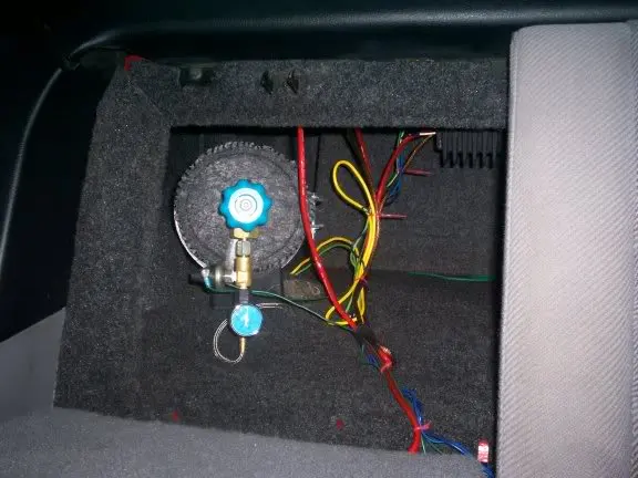

honestly, to run nitrous safely and efficently you need a bottle warmer,adjustable pressure cutoff switch and a pressure guage. my bottle heats up only when the car is running and the switch mounted next to the driver seat is activated. the heater is wired through the adjustable pressure cutoff switch and when my bottle reaches 1050 psi the heater turns off...without the heater you will not maintain 1050 psi of pressure especially when the bottle is half full...and also running inconsistant pressure without the heater could cause you to run either rich or lean depending on the pressure which could couse a problem with detonation,when i installed my nitrous system i added all the safety equipment necessary to run safe and efficient believe me at $40 a bottle to fill you want the most you can get out of it and the only way you can is by running a constant pressure and the only way to get that last shot or two out of the bottle efficiently and safely is with a bottle heater....
heres a picture of my bottle it has a blanket on it so you cant see the heater but you can see the adj. pressure cutoff switch and the pressure guage run in line...

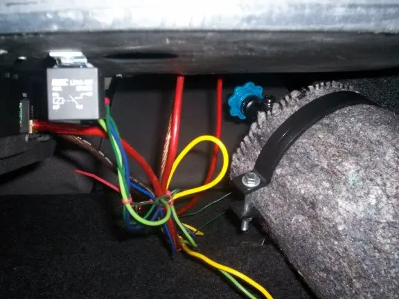

relay and wireing for the heater and cutoff switch...and also a couple amp wires please excuse them....
