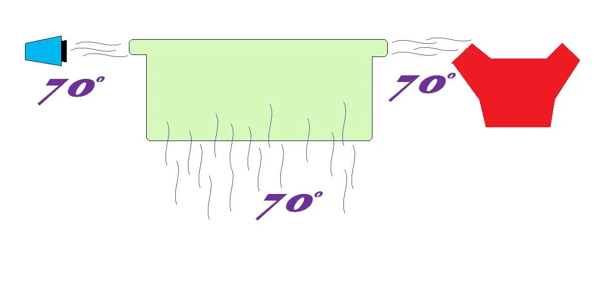

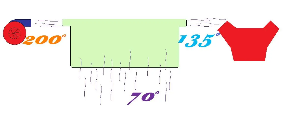

Yes. You are wrong. An intercooler creates an equilibrium of the hot air pushed inside and the outside air temperature. i.e. 200* air goes through the intercooler from the supercharger, and cools down from the 70* outside air, making it roughly 135*.
If you put an intercooler on a car with no power adder, you are doing nothing. 70* air goes in, mixes with the 70* air flowing past the intercooler, resulting in a 70* air charge. In other words, nothing happens. In fact you interrupt the flow of air which would acutally result in less air going into your intake. :D

For non-living things, the object will only get as cool as the ambient air.
If it's 20 degrees out and you drive 100MPH, the object sticking in the air will still be 20 degrees.
This idea is not gonna work....otherwise it would have been done by now and you would have heard of N/A intercooling
from what you just posted, take a step back and think about it.. if the "wind chill" is going through/past the intercooler then guess what?!.. that same "wind chill" is already going through your air filter. there is no change in intake air temperature while using an intercooler on a naturally aspirated engine. if you are just gonna argue with people who obviously know way more than you... then why ask? and for the sake of argueing with me. get some pipe and mount your air cleaner in the air dam of the front bumper cover and call it a day.:ban:

my awesome drawings
attachment.php
attachment.php
